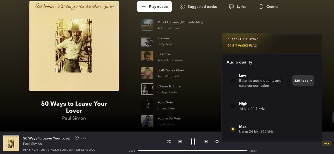

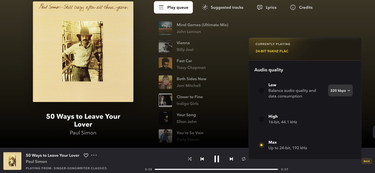

I did notice, as somebody posted in another thread, that MAX selections in 24/96 or 24/192 are playing back at 16/44.1 on certain apps and devices.
Currently, everything on Tidal using MusicCast is in 16/44.1 here. Switch to the Tidal app in my Mac mini M1 and everything plays in its respective bit/rate.
