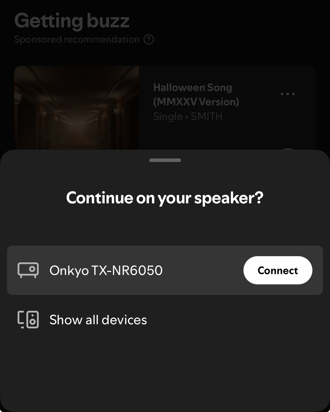

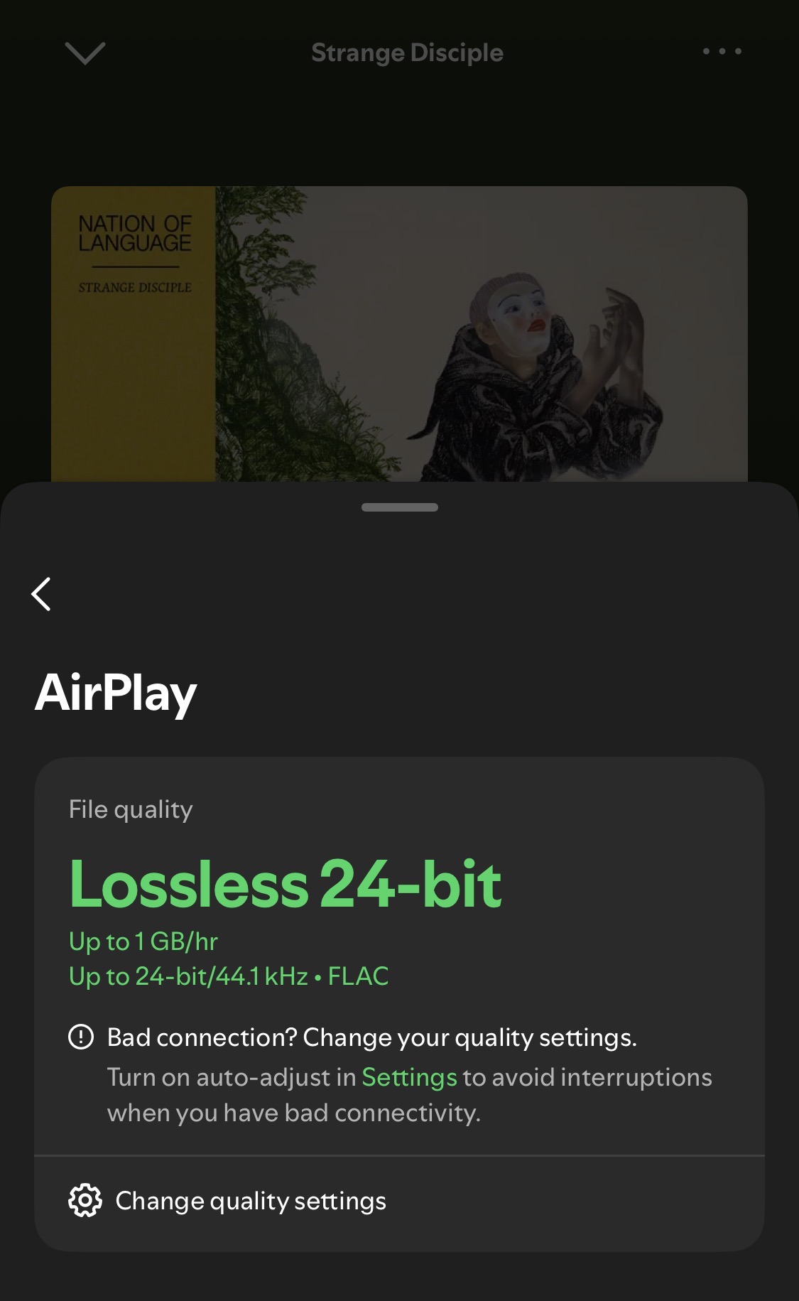

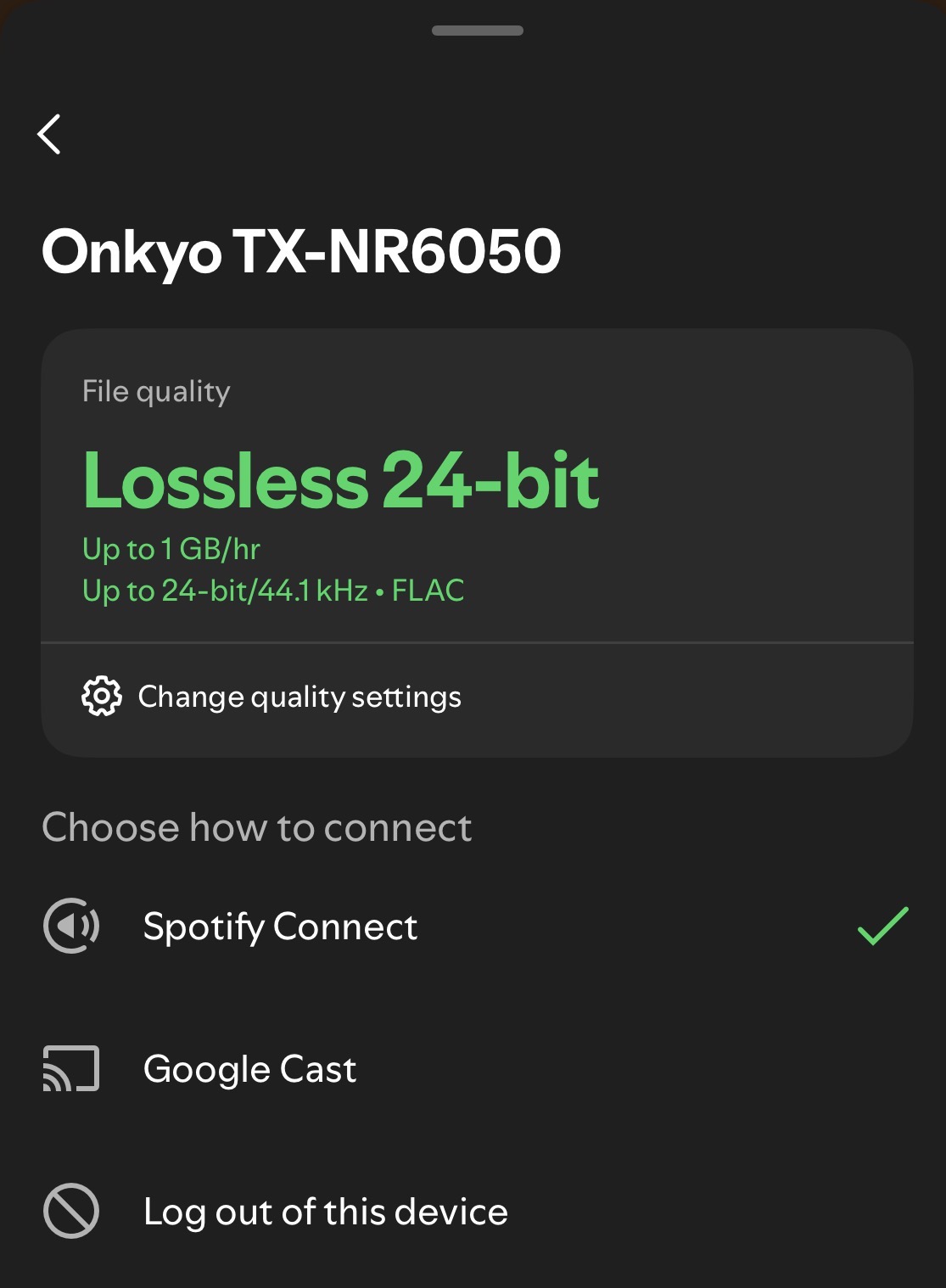

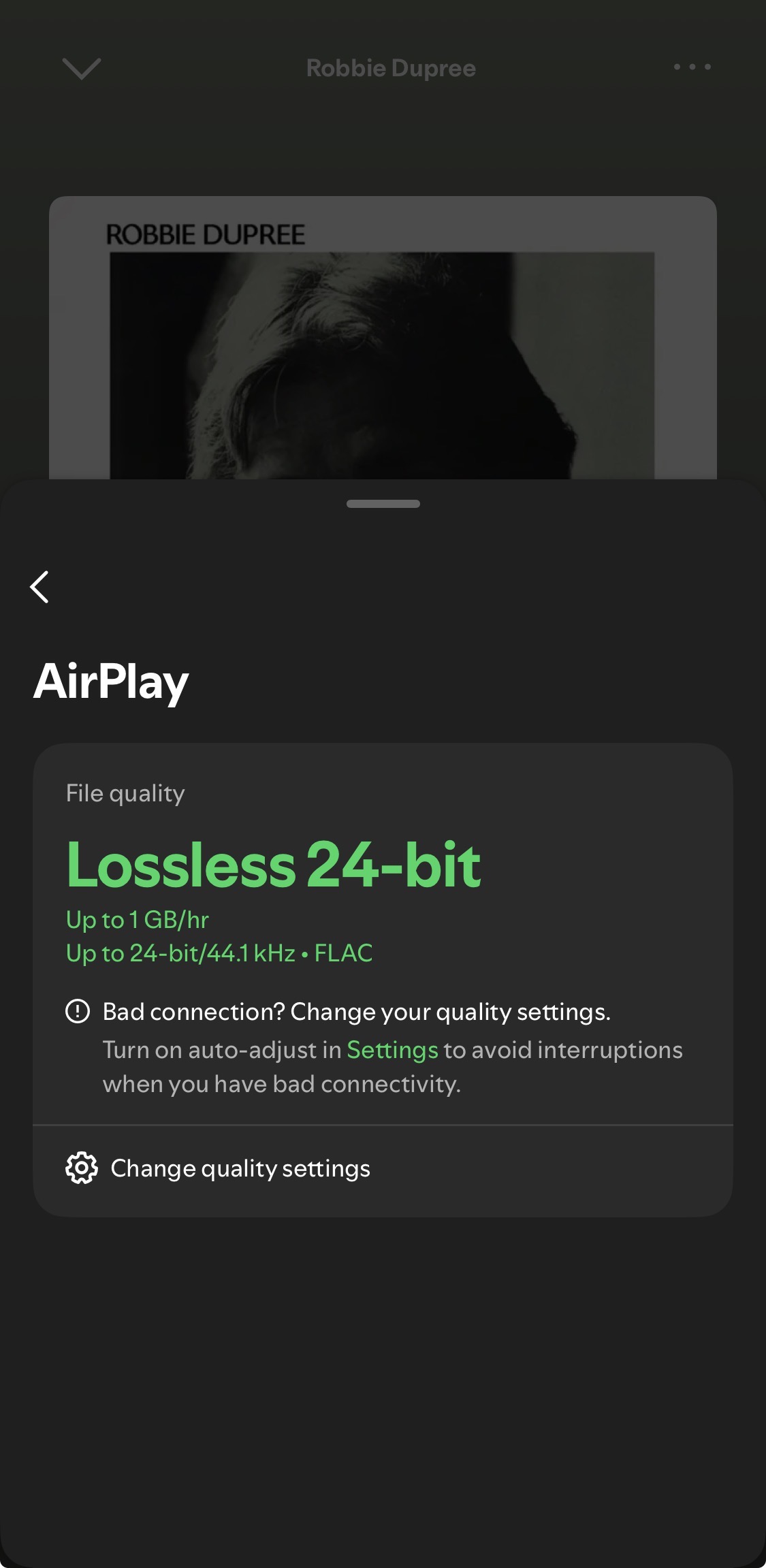

Some of my devices support Spotify Lossless using their own Spotify apps while others do not do so. Some of them support Lossless when using Spotify Connect while others do not do so. Some support Lossless using Google Cast(formerly Chromecast built-in) and/or Airplay. It’s all over the place.

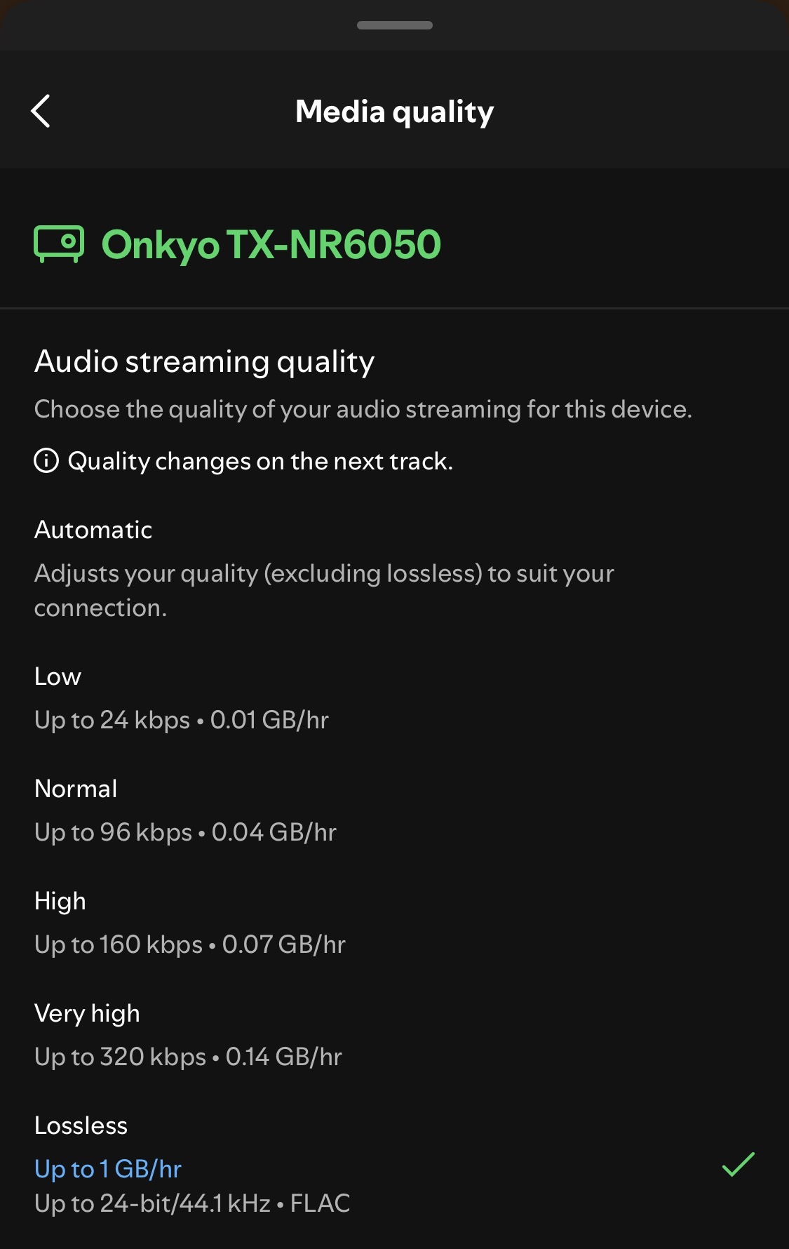

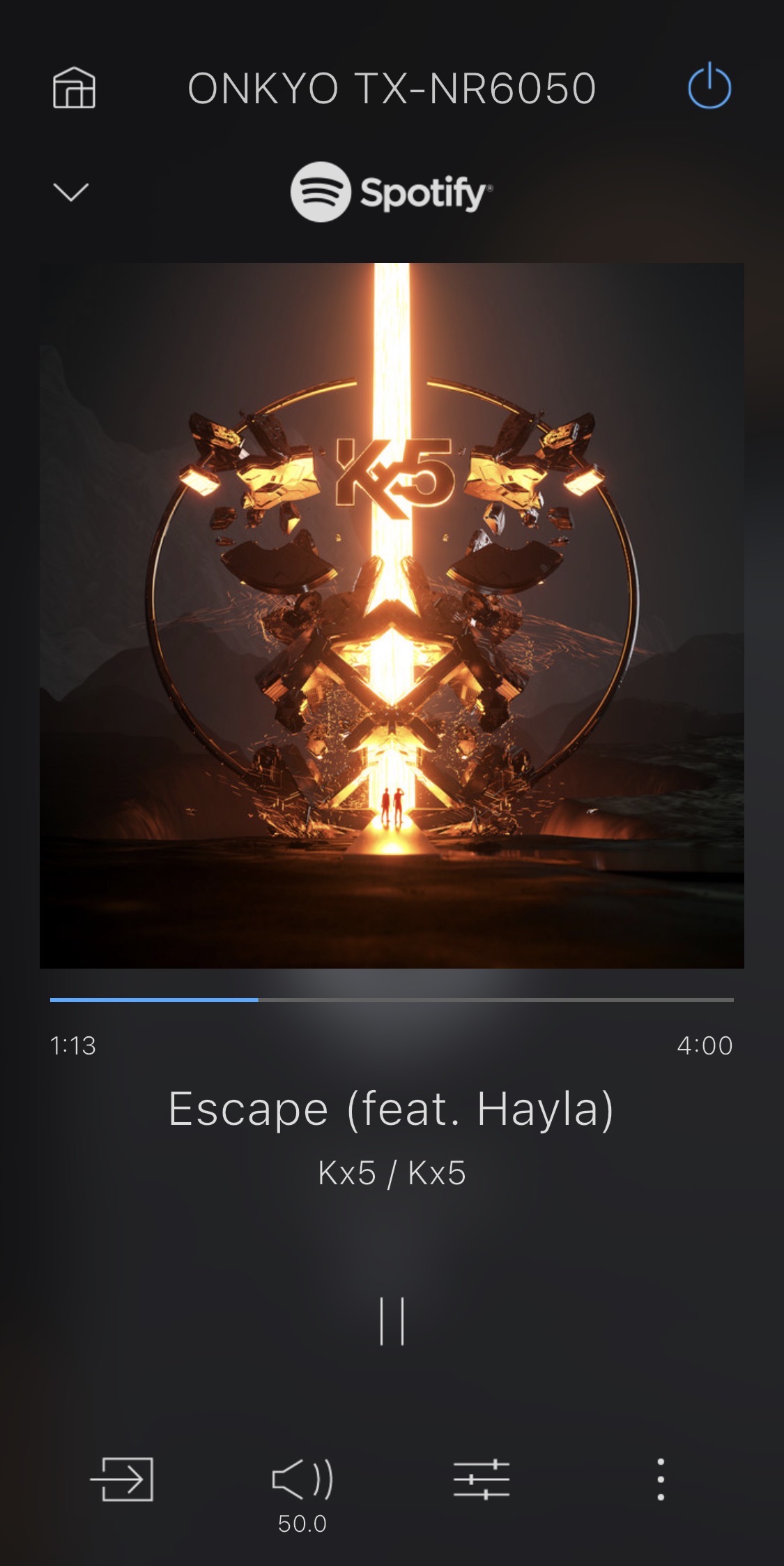

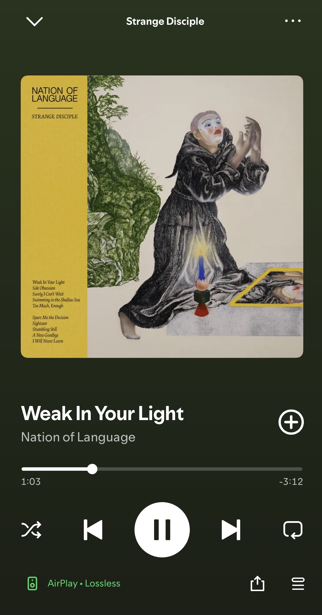

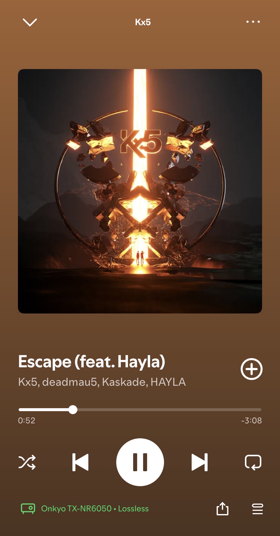

After tinkering with all of those devices, only one supported “bit perfect” Lossless playback using Spotify Connect, Google Cast and Airplay. That device is the Onkyo TX-NR6050. Can I honestly say there was a very noticeable difference in sound quality playing lossy signals from the Spotify app in various devices compared to those that support Lossless? No, I cannot say so. I may continue to post here from time to time with the results of Spotify streaming using different devices. I welcome anybody to post about their experiences with Spotify in their own systems. I’d be interested in results from those who use Audirvana or Roon as I have not yet run Spotify through either of them.

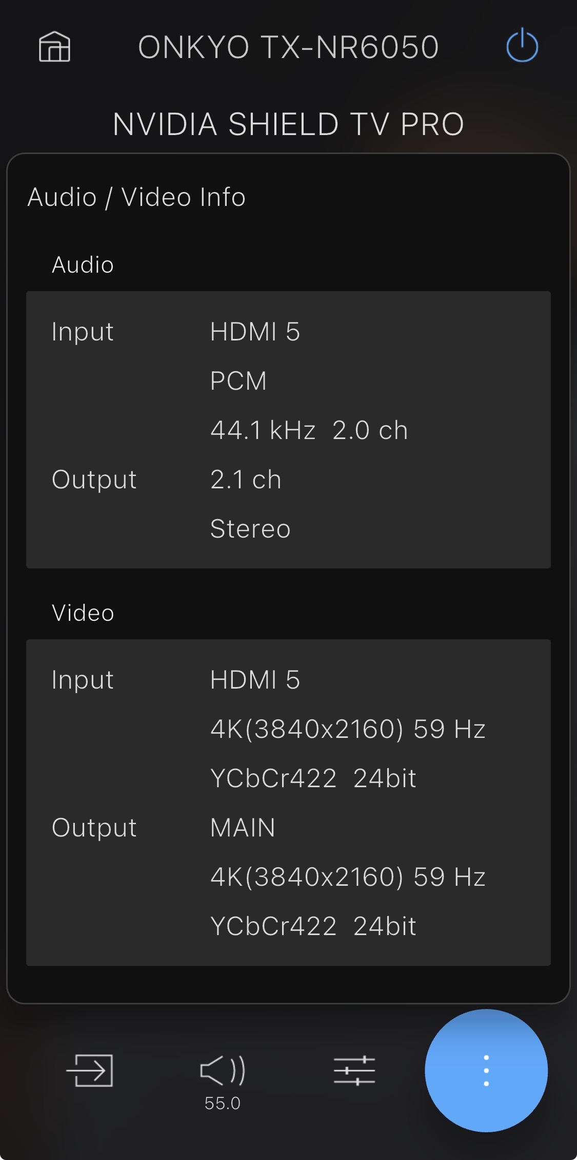

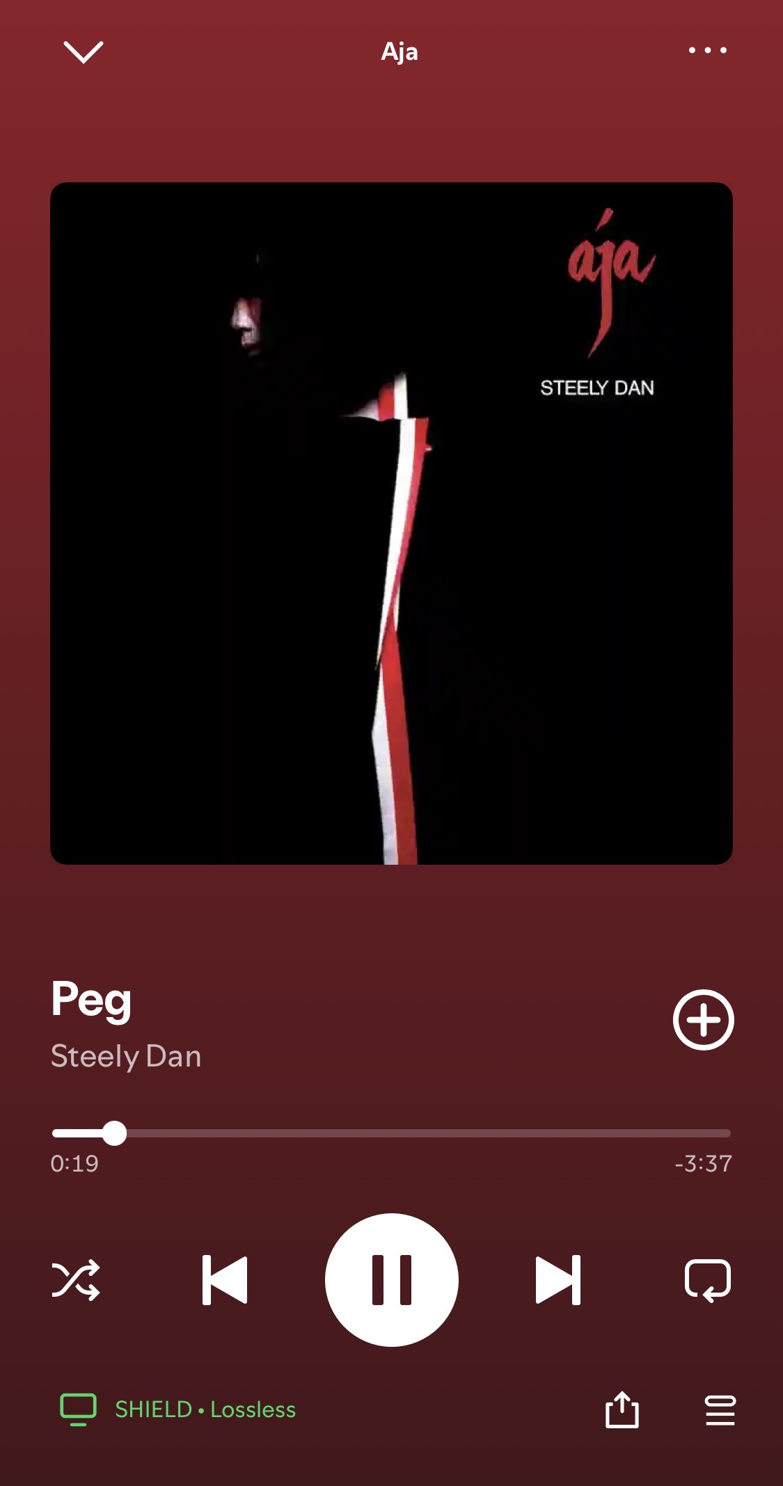

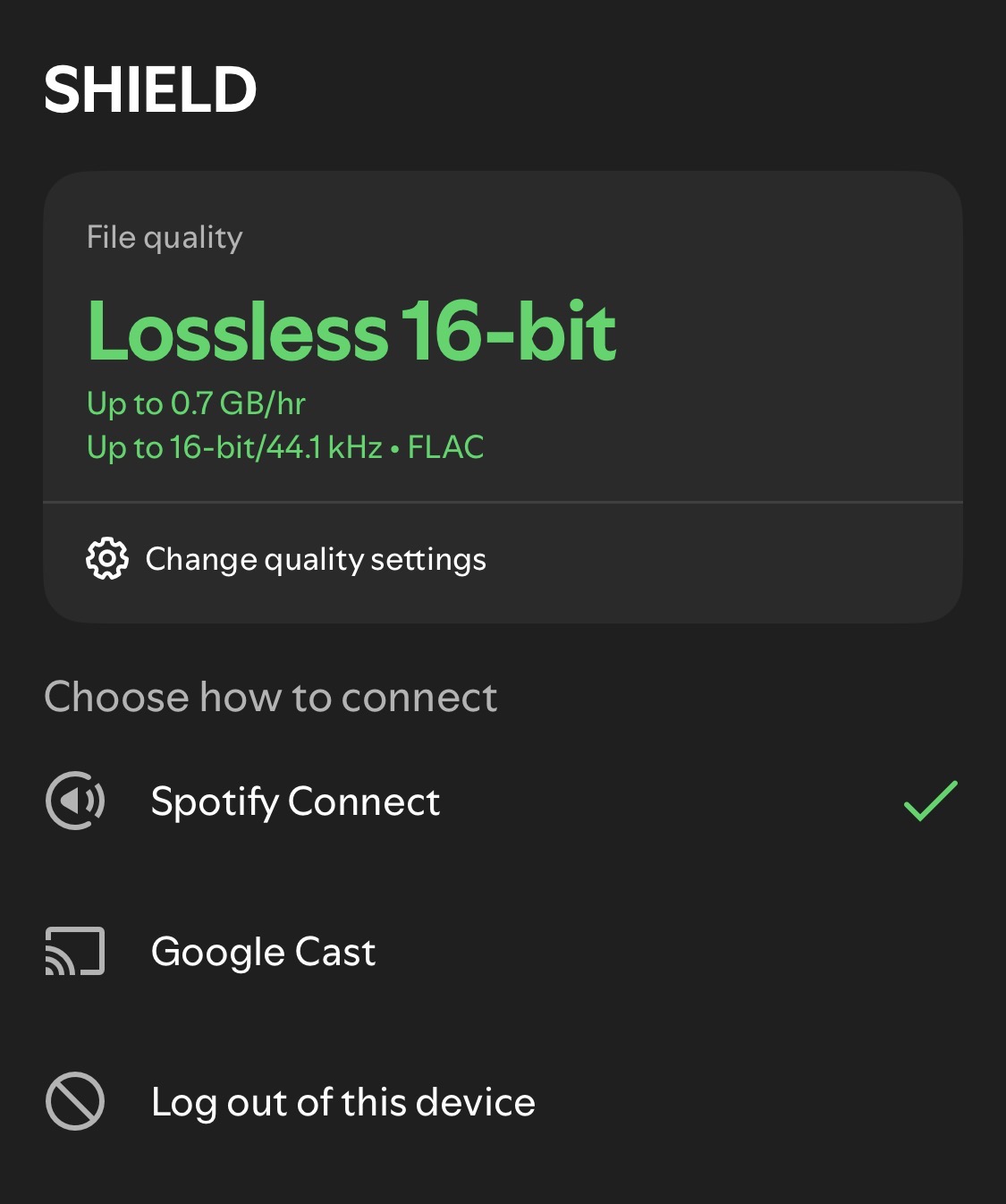

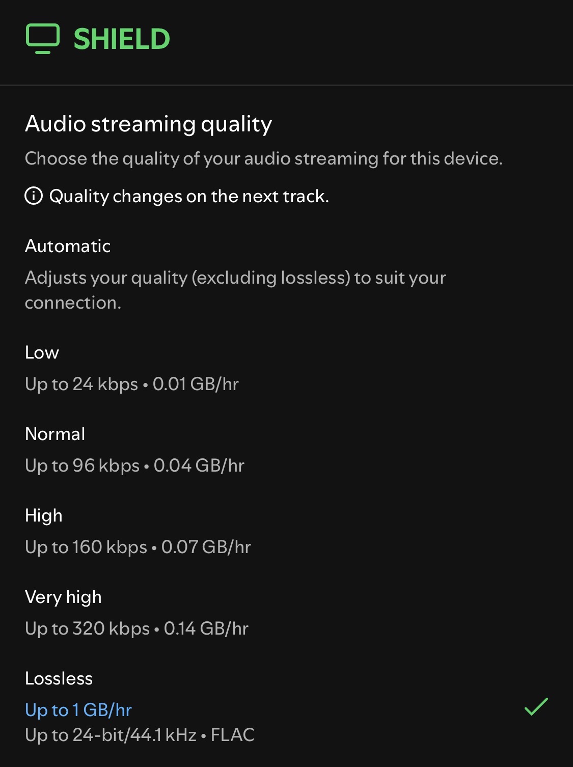

I recently spent some time playing around with Spotify using the Nvidia Shield TV Pro(2019.) The Spotify app can be downloaded from the Google Play Store in the Shield. The app is not fully featured and audio settings are not present in it. But, when playing music using it and bringing up the Spotify app on a Smart device on the same network, the apps will sync and playback and audio adjustments can then be made using the Smart device app.
After some tinkering, I was able to get Spotify Lossless to work in the Shield after a few initial glitches. In the Shield’s own audio output settings, one can select passthrough of bit and sample rate of input signals. Some do not like 16/44.1 signals being resampled to 24/48 and want a “bit perfect” signal making its way to a DAC.
While Spotify Lossless 16/44.1 is supported in the Shield, 24/44.1 is not supported and everything is streamed as 16/44.1. Some will not like it and some will not care at all as long as it is Lossless. The Shield supports Spotify Connect and Google Cast. There is no support for Airplay. One can select HDMI or USB for audio output with the Shield when using both connections.
iOS Spotify app:

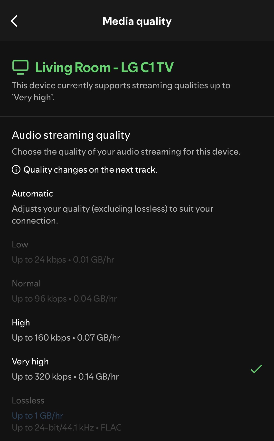

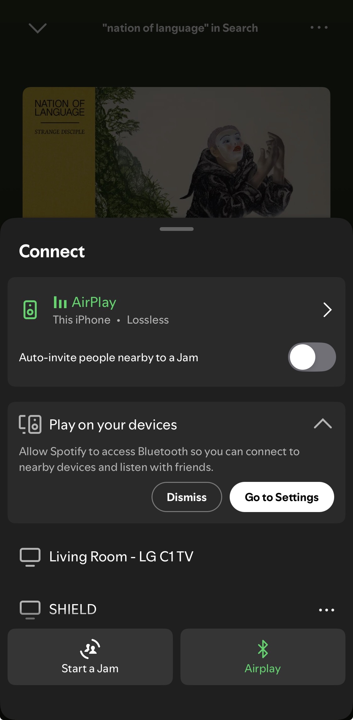

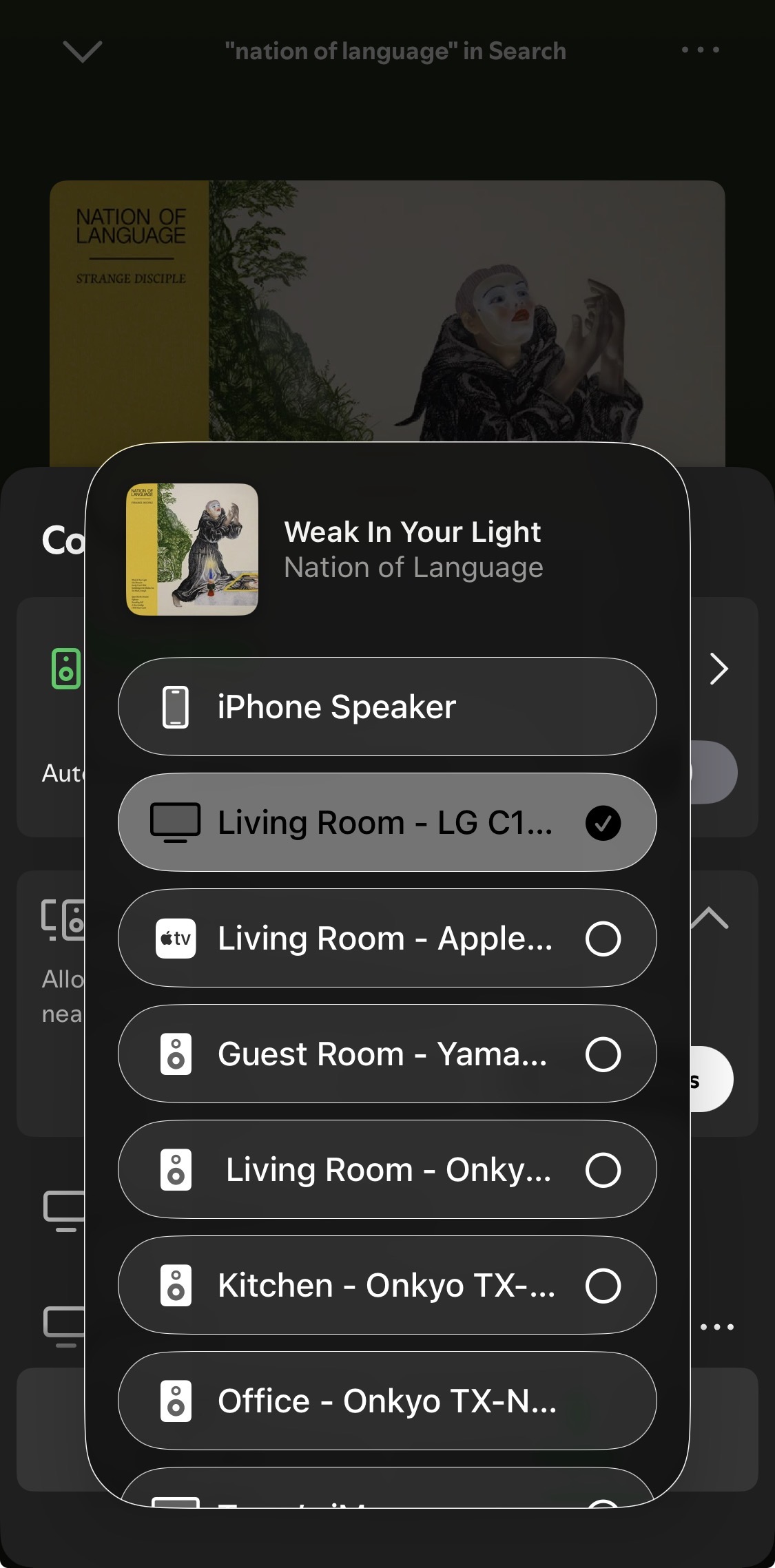

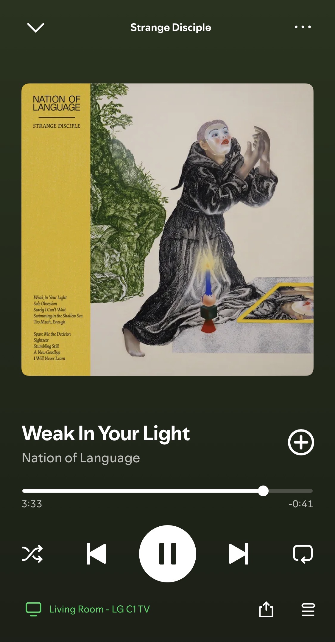

I’m still enjoying playing around with Spotify and moved onto the LG C1 TV. LG WebOS supports Spotify and one can download the app into their LG TV. Like the Shield app, it is a basic affair and I must go to another device to view streaming info. The C1 supports Spotify Connect and Airplay, but not Google Cast.

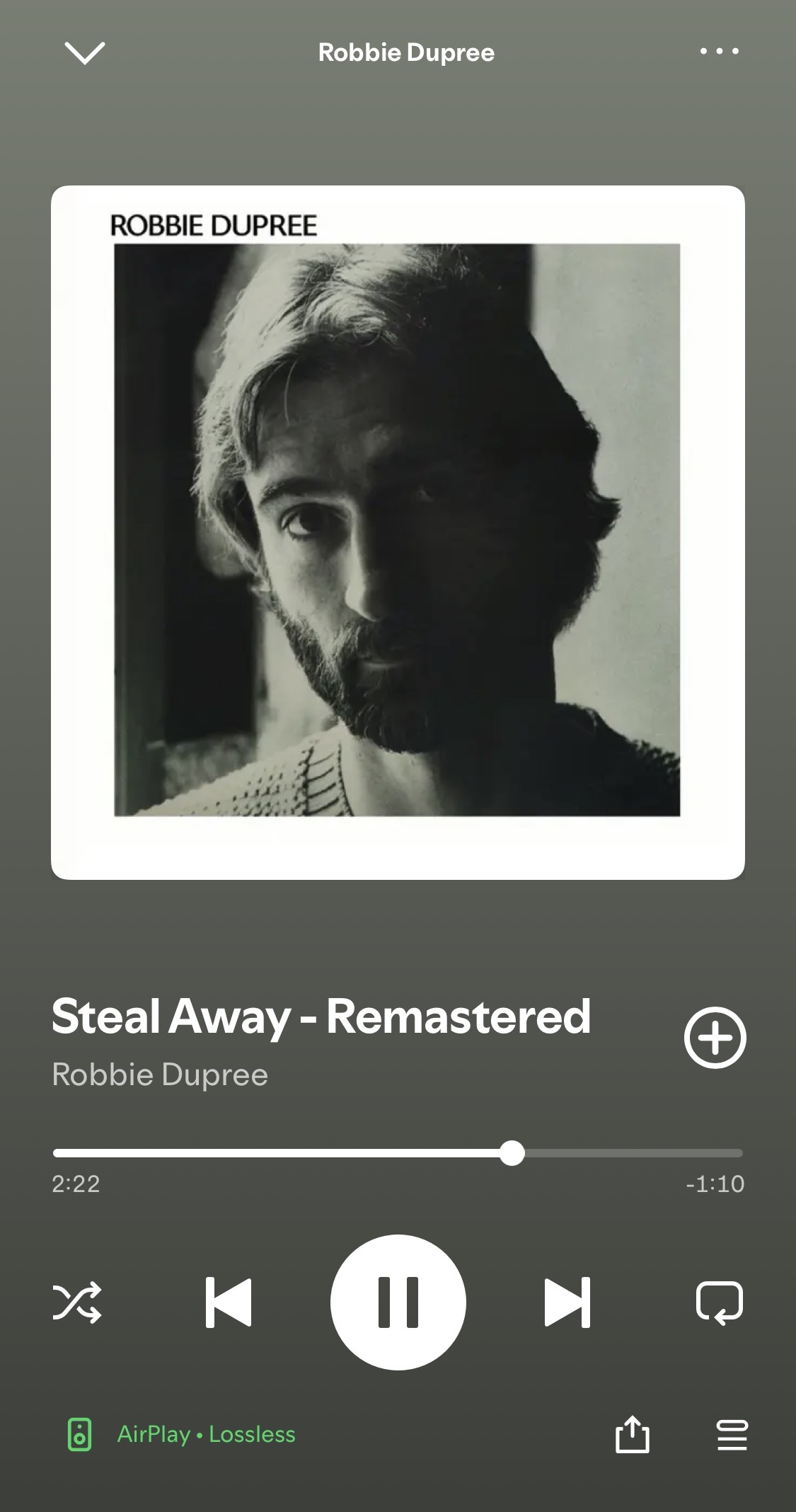

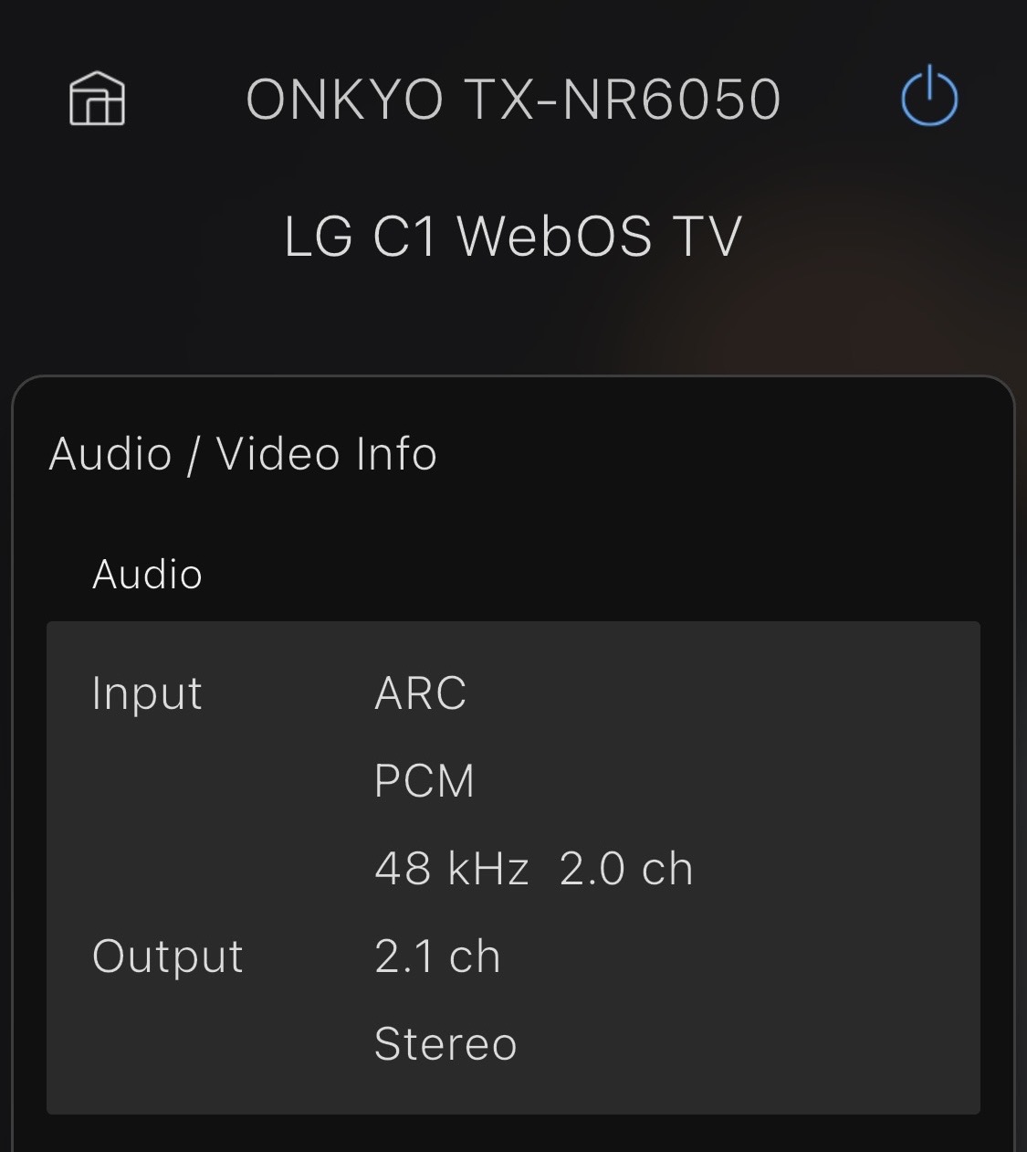

While the C1 supports Spotify with its own app and Spotify Connect, Spotify Lossless is not supported when using either of them and “Very High” quality is the limit. Use an iOS or MacOS device to Airplay to the C1 and “bit perfect” Spotify Lossless is streamed as Airplay supports up to 24/48. However, that 16/44.1 or 24/44.1 signal is resampled to 24/48 for output over ARC or eARC.

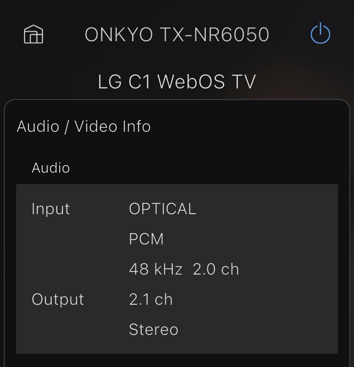

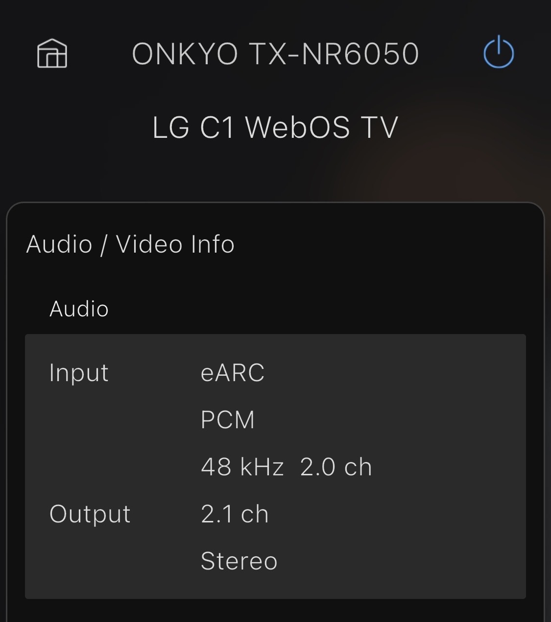

Folks with LG TVs need to be aware of something when using webOS apps. If eARC is not enabled in Advanced Sound settings and ARC is used, two channel PCM signals from streaming services will be re encoded to DD 2.0 and the AVP/AVR at the receiving end will display it as such. This is no good for those using devices such as the miniDSP Flex HTx connected to their TVs as it supports only PCM signals. Signals sent over Airplay to the C1 are not re encoded to DD 2.0 using ARC. I did notice that the streams come in a bit hotter using Airplay to the C1 compared to using Spotify Connect.
If one is connecting an older AVP/AVR that supports only ARC to a newer LG TV, using Airplay instead of Spotify Connect for Spotify is the better connection as it supports Spotify Lossless and will not be re encoded to DD 2.0 over ARC. This is also the case when using an optical connection for those with even older units that do not support ARC. Though, signals will be resampled to 24/48 for output and annoy those wanting “bit perfect” signals all the way to their AVP/AVR.
iOS Spotify app
iOS Onkyo Controller app:

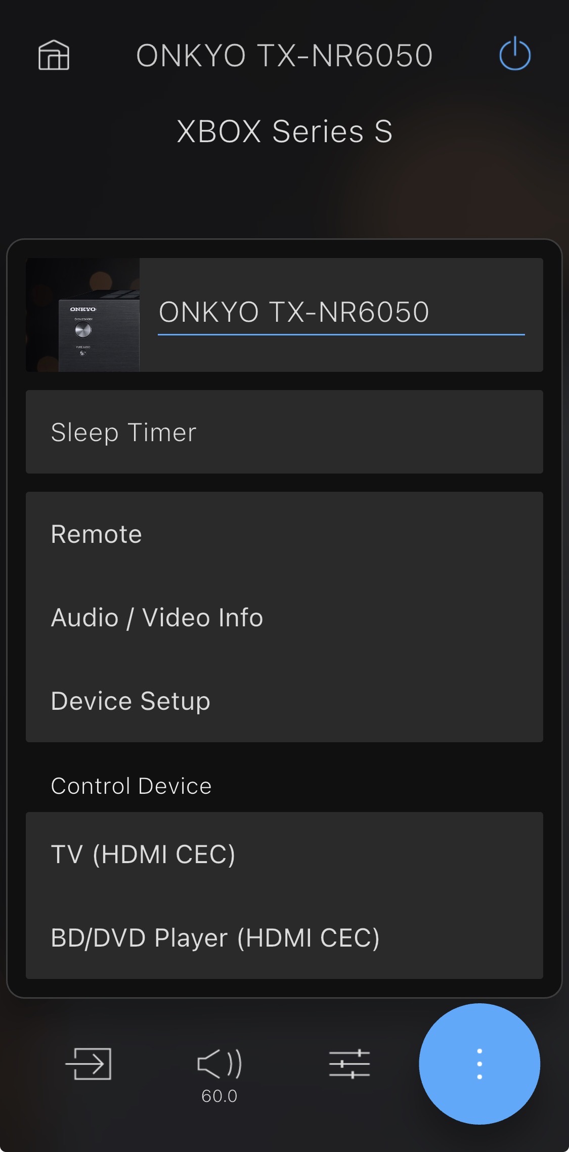

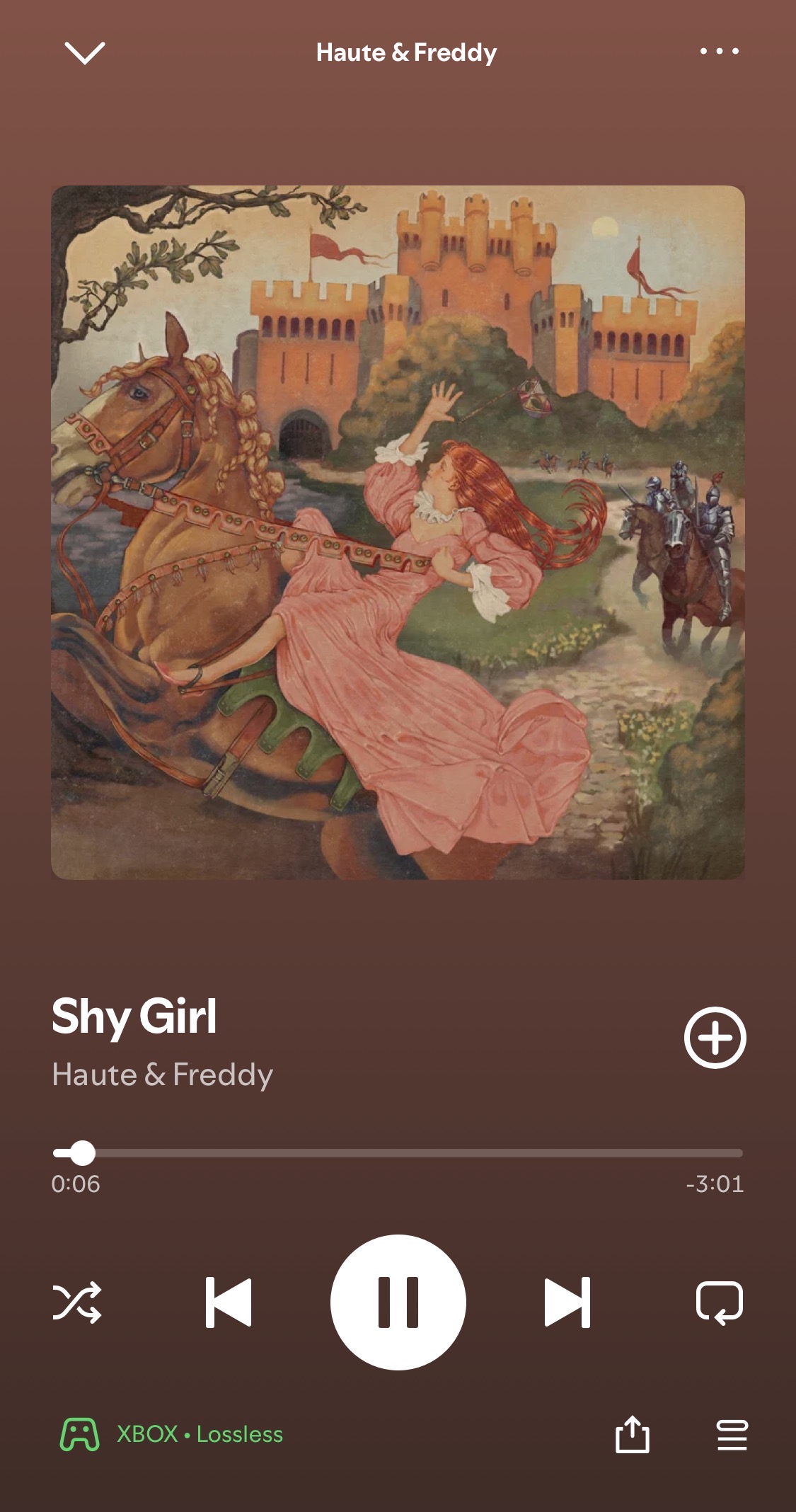

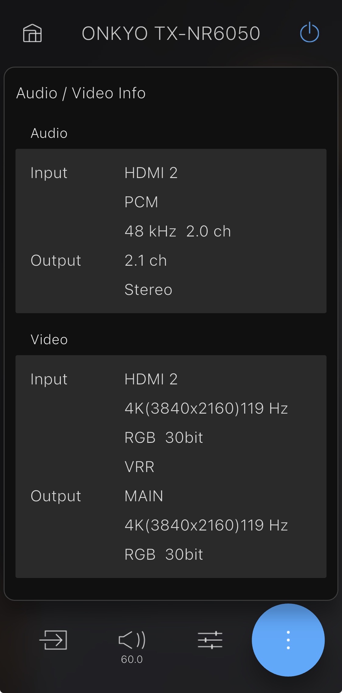

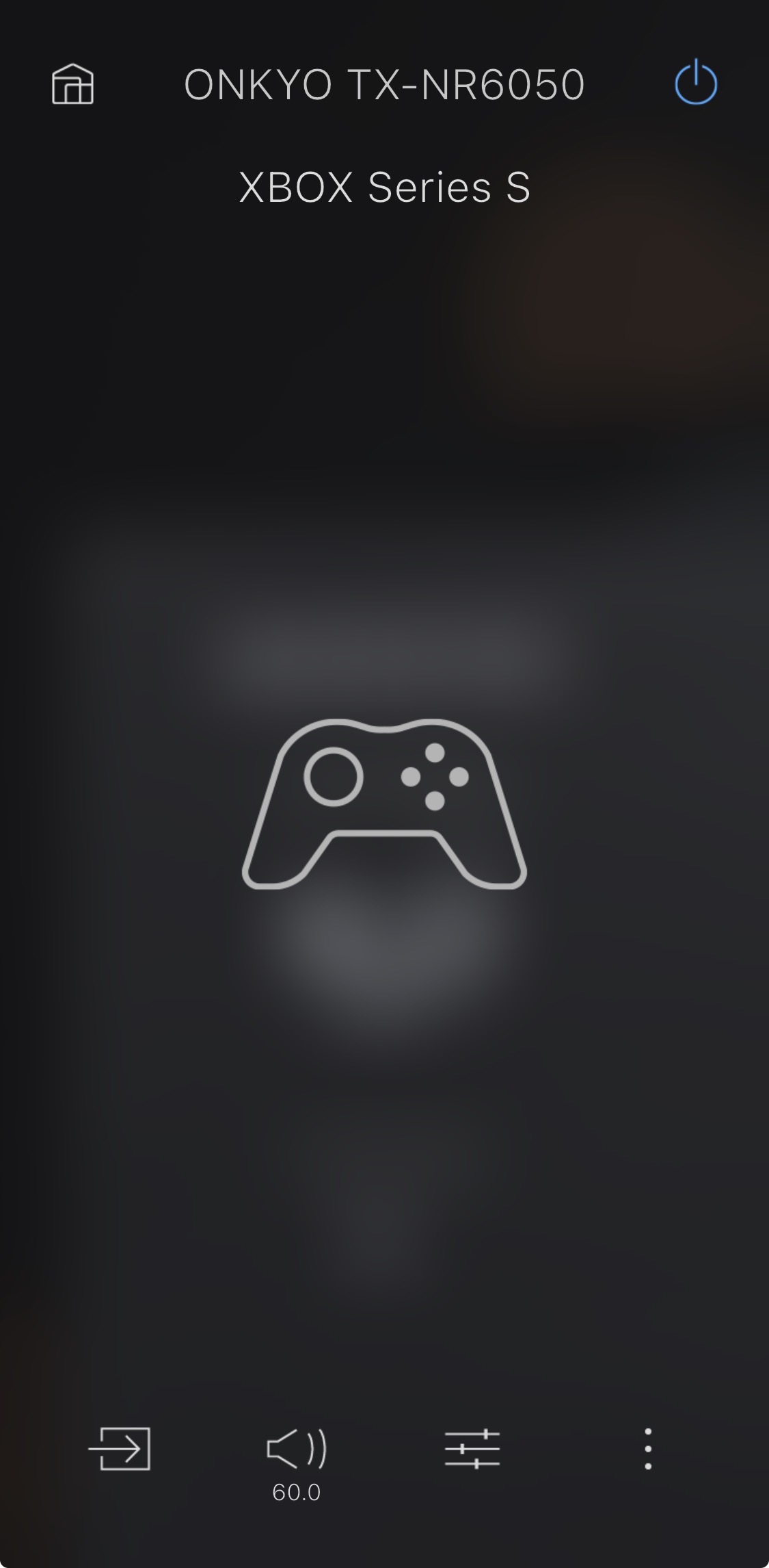

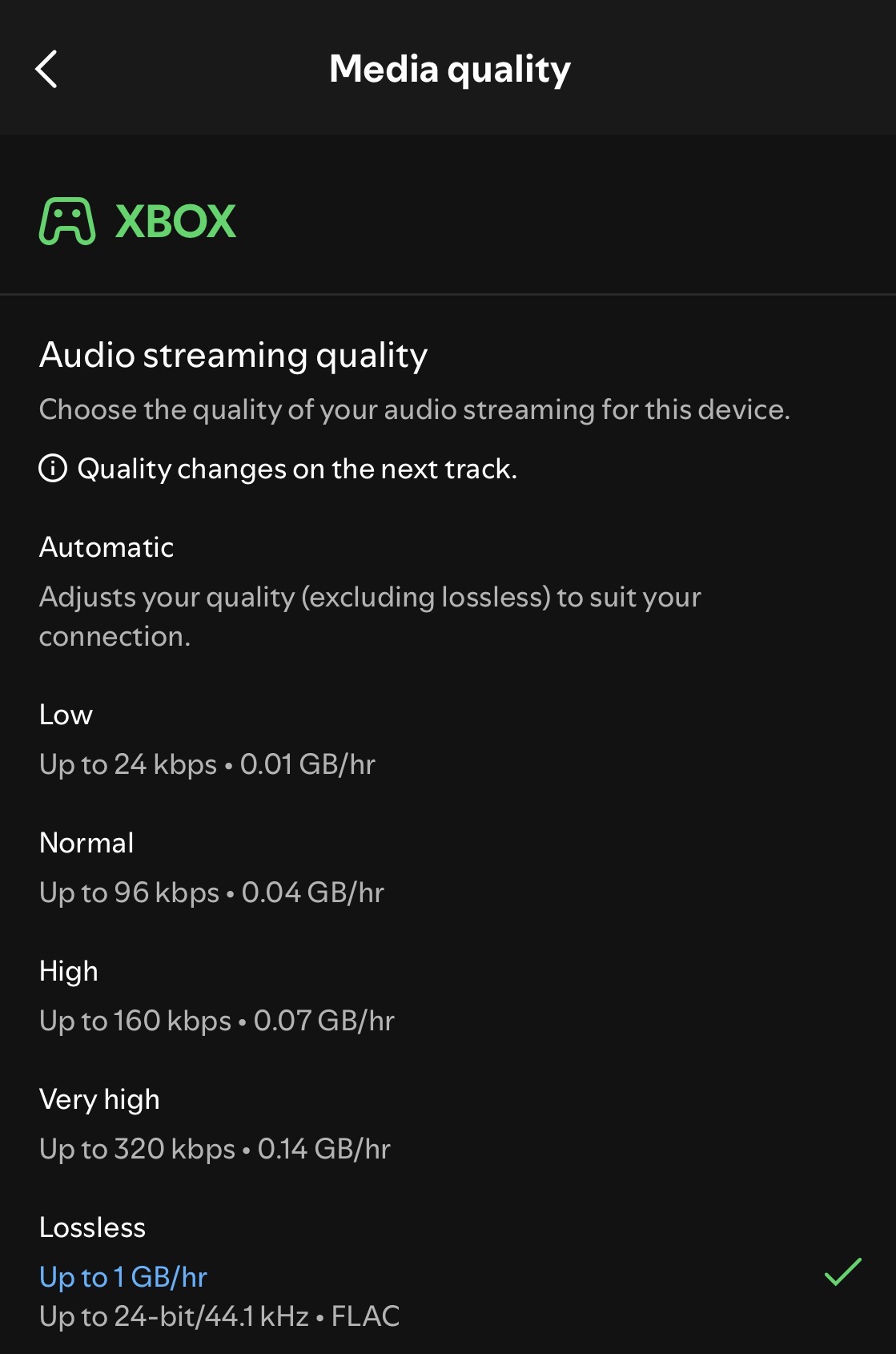

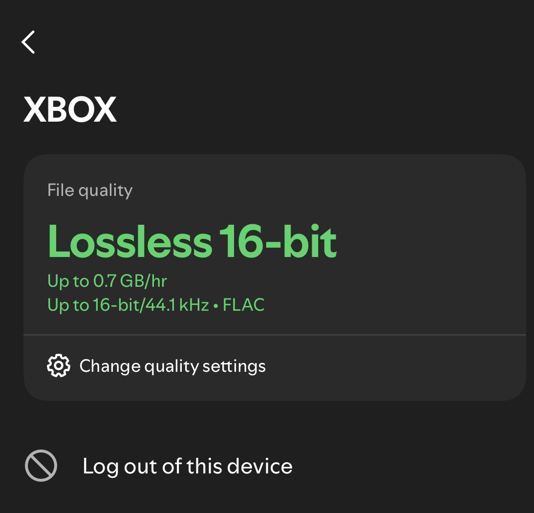

One of the devices I have that was not on my list is the XBOX Series S. I downloaded the Spotify app from the Microsoft store and gave it a whirl. Like some other devices, the app is not fully featured and I had to use the iOS app to make adjustments to it for playback.

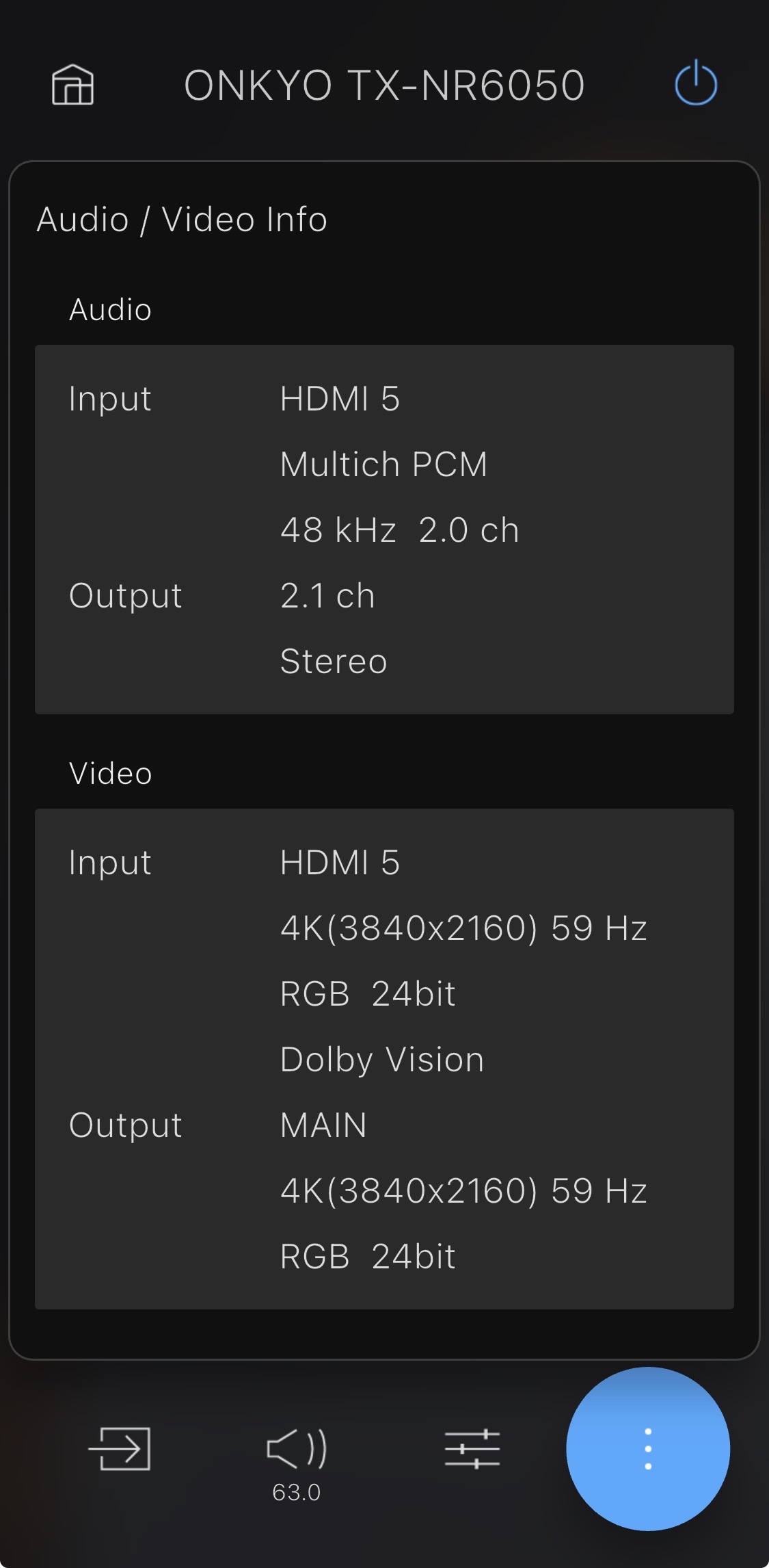

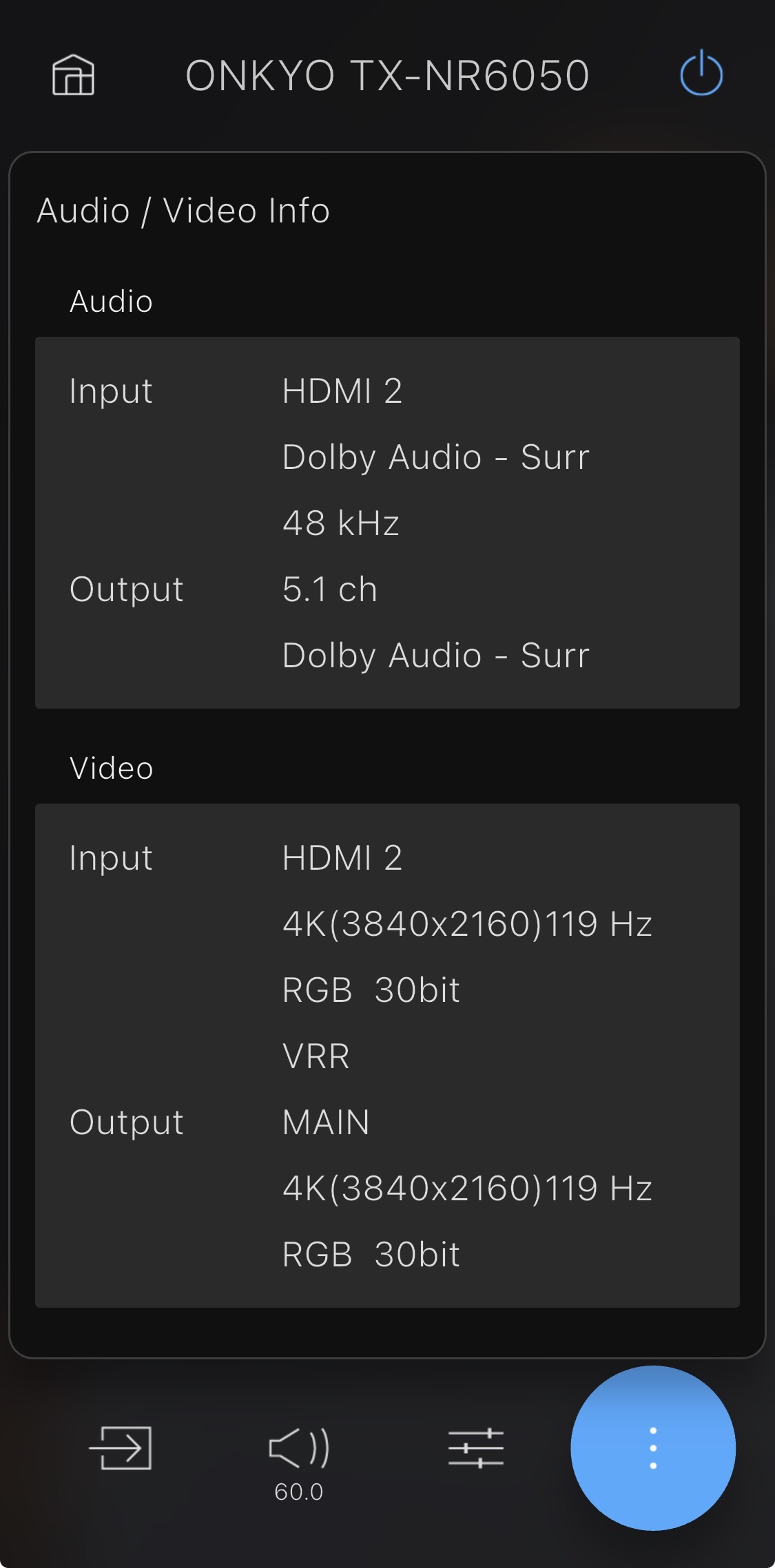

The XBOX Series S supports Spotify Connect but does not support Airplay or Google Cast. Spotify Lossless is supported at 16/44.1 but not 24/44.1. The signal is resampled to 24/48 over HDMI and there are no USB, optical, coaxial, or USB audio output ports available here.

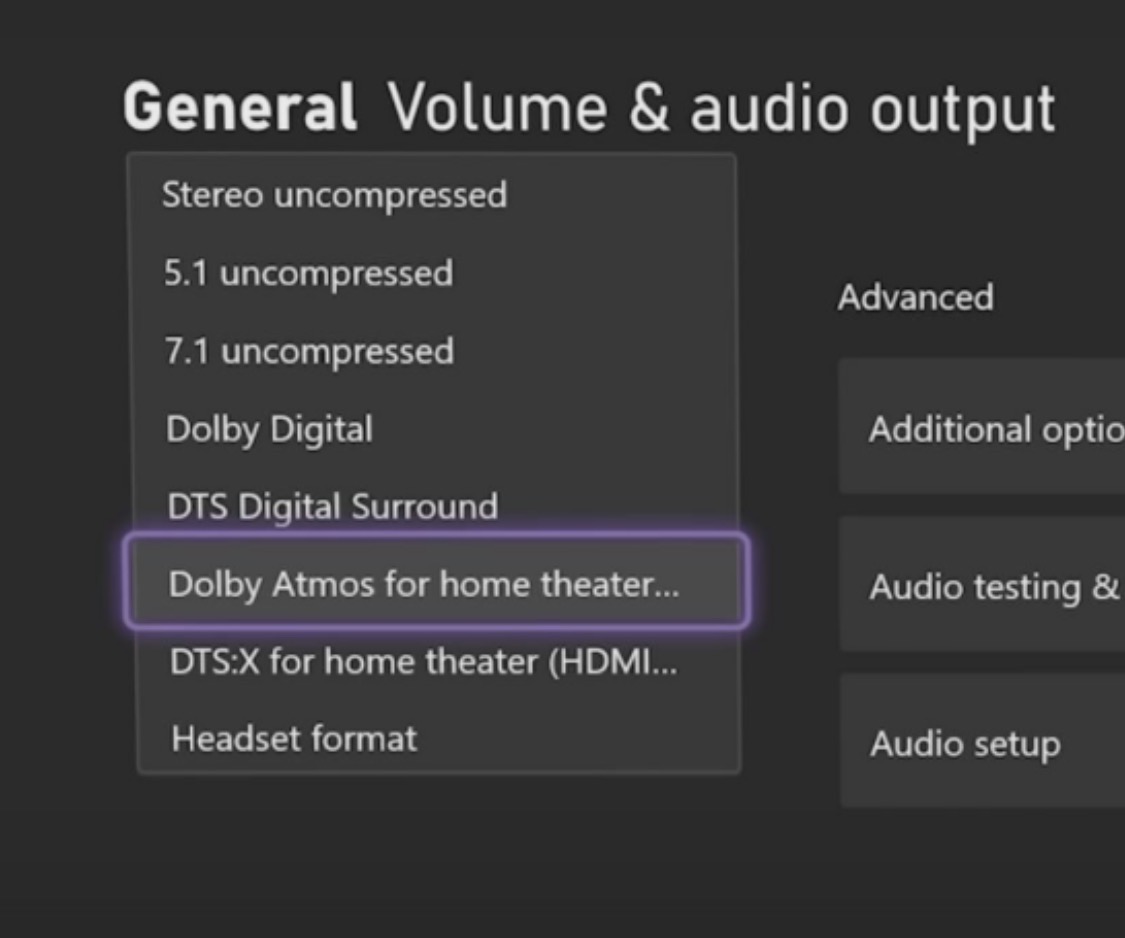

The XBOX Series S supports Microsoft’s “Atmos for Home Theater” audio output setting once the “Dolby Access” app is downloaded from the Microsoft store. When it is selected, non Atmos signals are output as Dolby Surround. My Onkyo recognizes them as Dolby Surround while my TV reports Atmos. Actual Dolby Atmos signals are recognized as such by the Onkyo.
Once downloaded like the Dolby app, Microsoft’s “DTS Sound Unbound” app allows one to select DTS:X for audio output and all signals will be recognized as DTS:X at the receiving end. Stereo uncompressed, 5.1 uncompressed, 7.1 uncompressed, Dolby Digital and DTS Digital Surround are also selectable for audio output.
When playing PCM 2.0 signals from Spotify, it does not matter which audio output setting I select in the XBOX for output as all will result in audio coming from just the Front speakers using a straight decode of each format. Dolby and DTS cross up mixing will be limited when selecting Atmos or DTS:X for output. Some might just select Stereo uncompressed for output when using Spotify.
iOS Spotify app:
XBOX Series S Audio Output Settings:

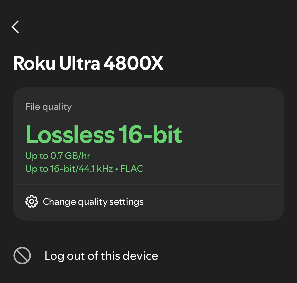

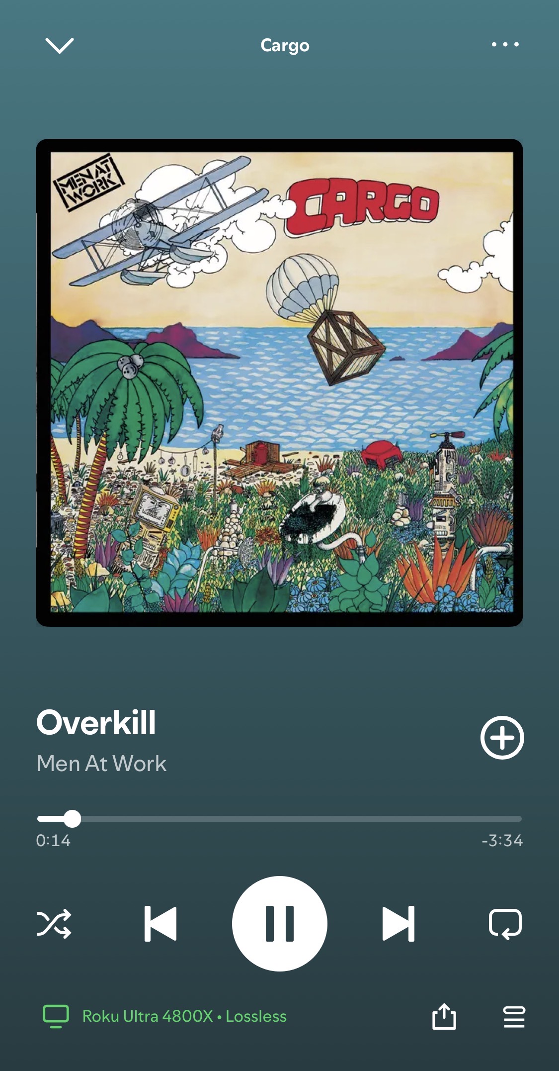

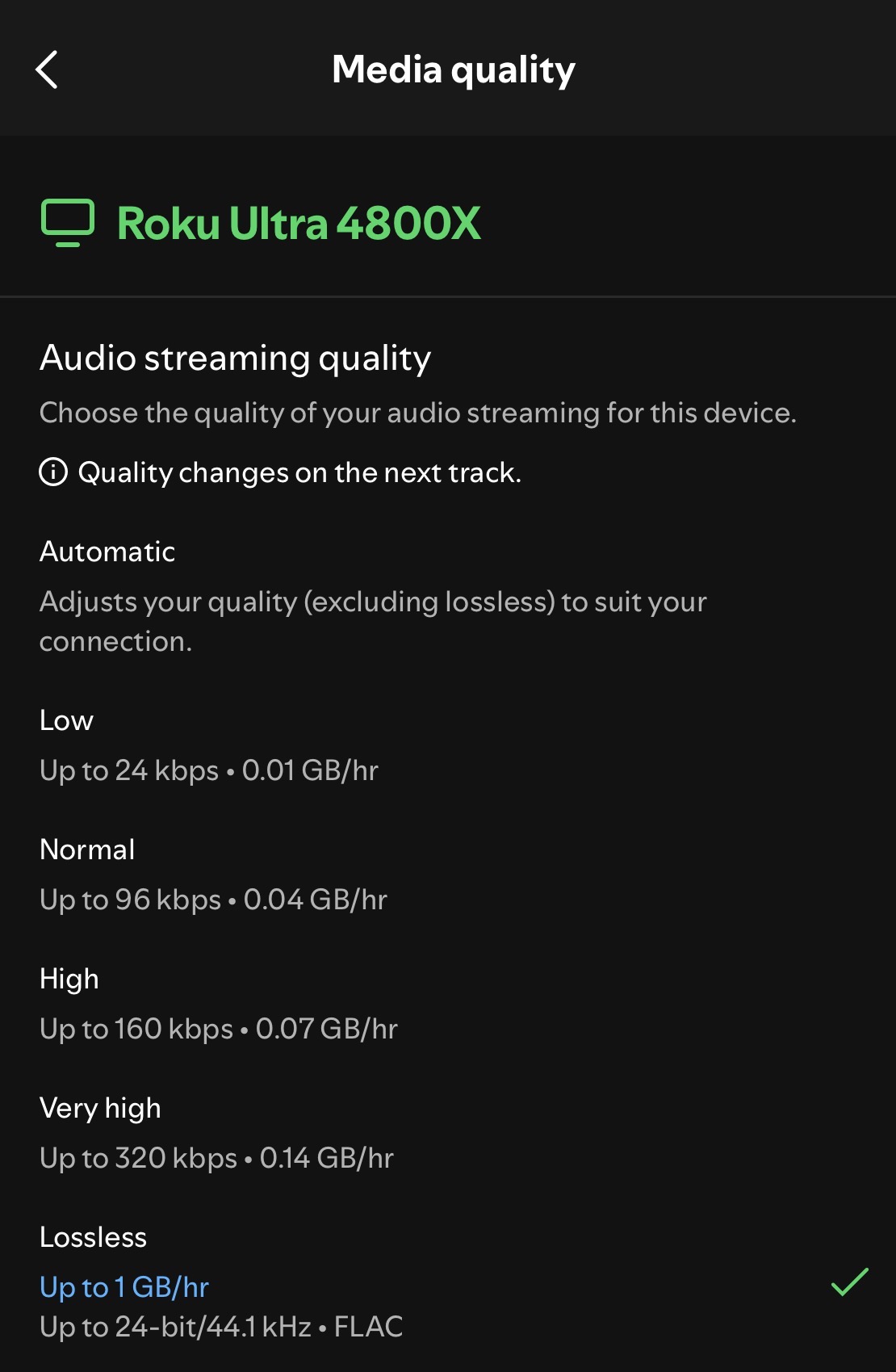

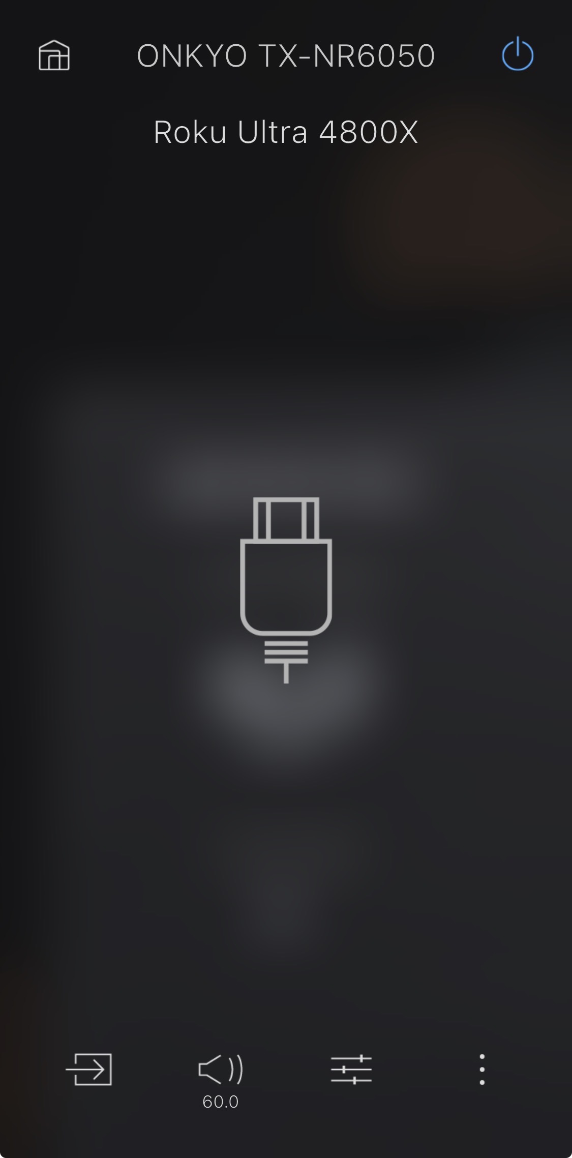

Having used all of my Onkyo’s HDMI inputs, I removed the Nvidia Shield TV Pro from the system and put in the Roku Ultra 4800X to play with Spotify. The Roku supports Spotify Connect and Airplay but does not support Google Cast.
The Spotify app is downloadable from the Roku store and like the Spotify app in other devices lacks audio settings. Again, I used the iOS app to enable Lossless in the Roku as it defaults to the lossy “Very High” setting.
While the Roku supports Spotify Lossless 16/44.1, it does not support 24/44.1. Thsignal is not resampled over HDMI like it is on other devices when using Spotify Connect. However, it is resampled to 24/48 when using Airplay to the Roku.
There are many different Roku models out there with different audio settings and results using Spotify Connect will vary among them.
iOS Spotify app:

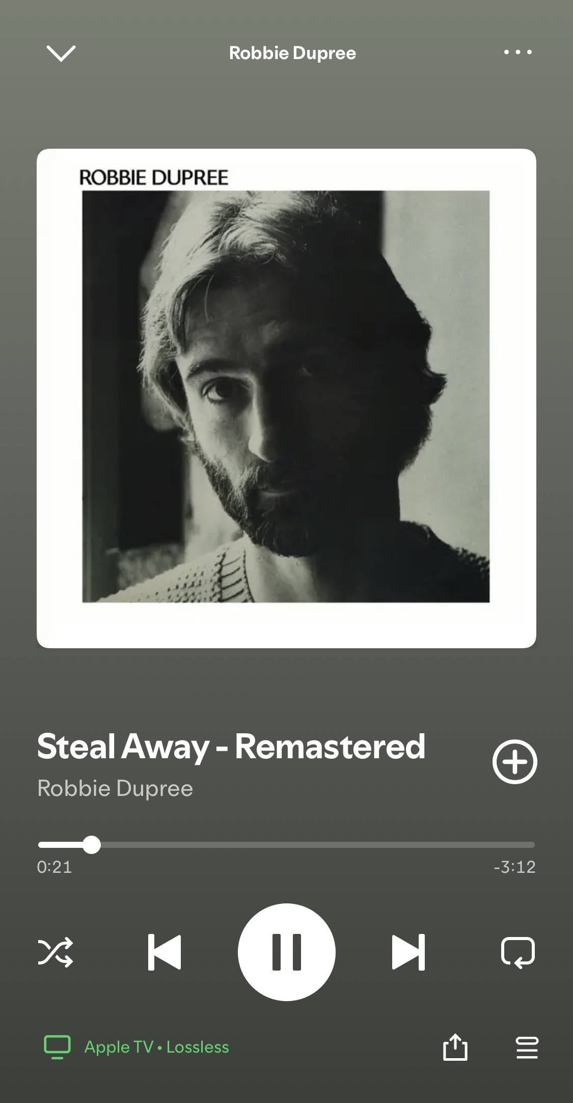

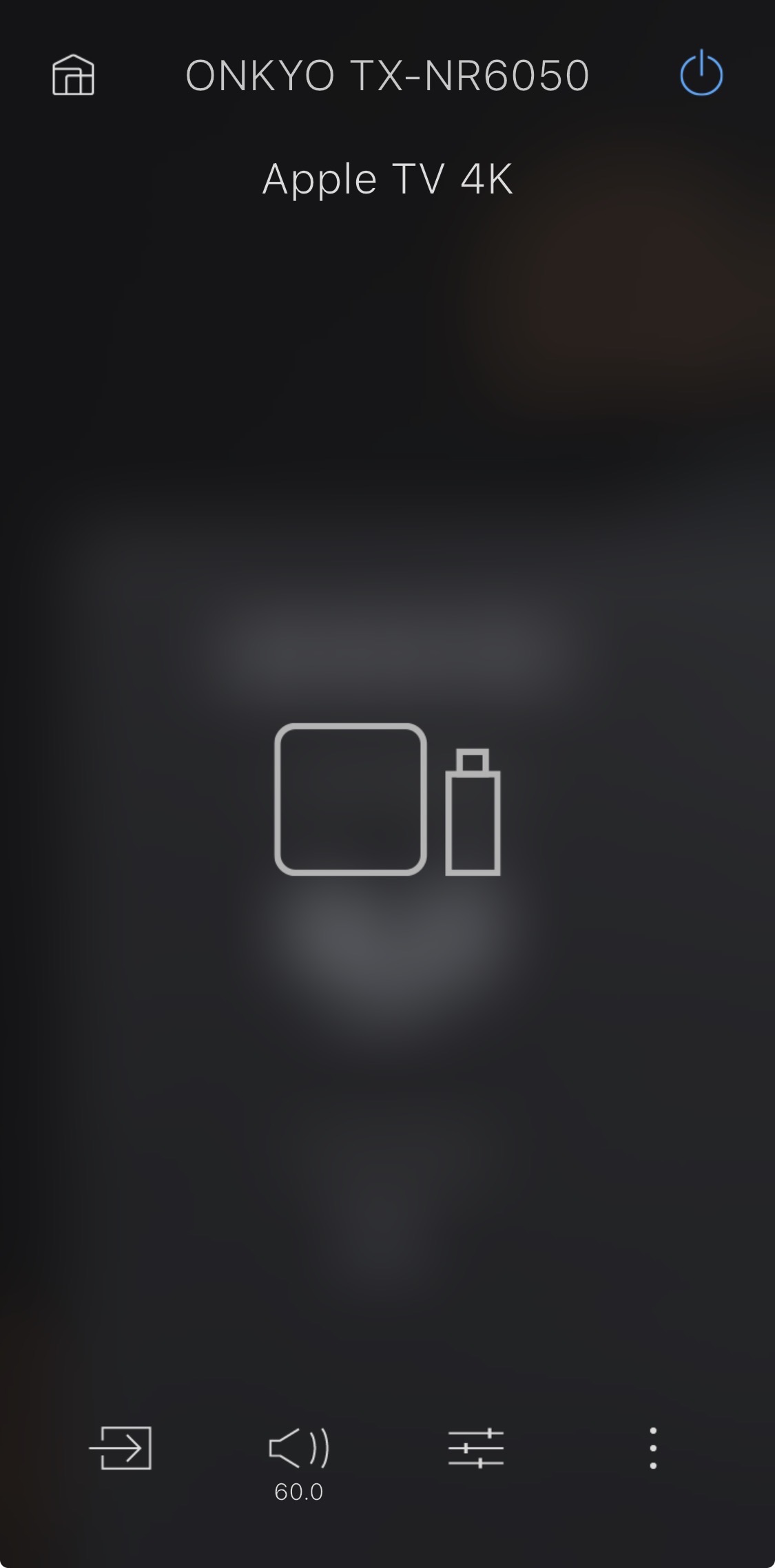

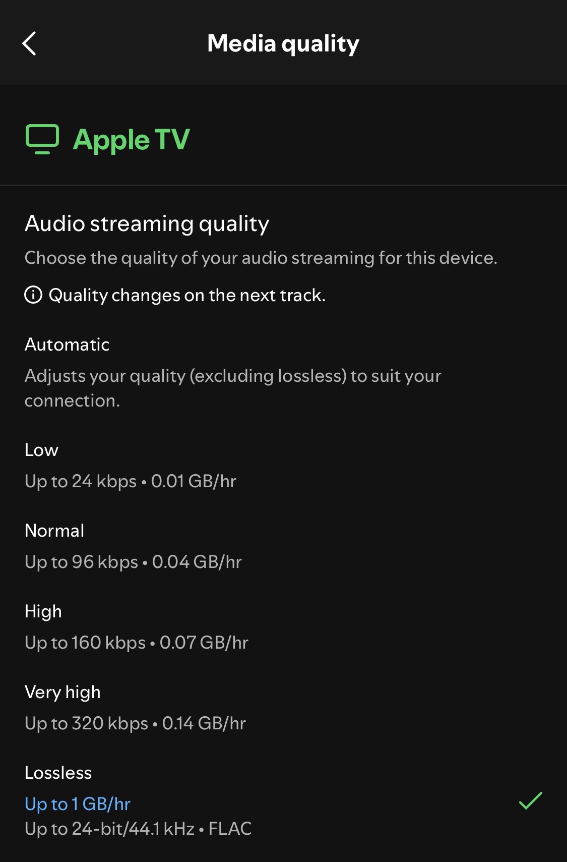

Moving along to another device, I played around with Spotify using the Apple TV 4K 1st gen. It supports Spotify Connect and of course Apple’s Airplay. It does not support Google Cast. Spotify Lossless is supported at 16/44.1 over Spotify Connect while 24/44.1 is not so. As with other devices using Airplay, Lossless 24/44.1 is supported and the signal comes in hotter over Airplay to the Apple TV 4K than Spotify Connect. Either way, the signal is resampled to 24/48 for output over HDMI.
Unlike other devices, the Apple TV 4K Spotify app does not have a “Dark Mode” setting that changes the screen to black and dims the album art and info after placing them in the lower left corner of the screen. It is a nice feature for those with OLED TVs but is not an option here.
iOS Spotify app:

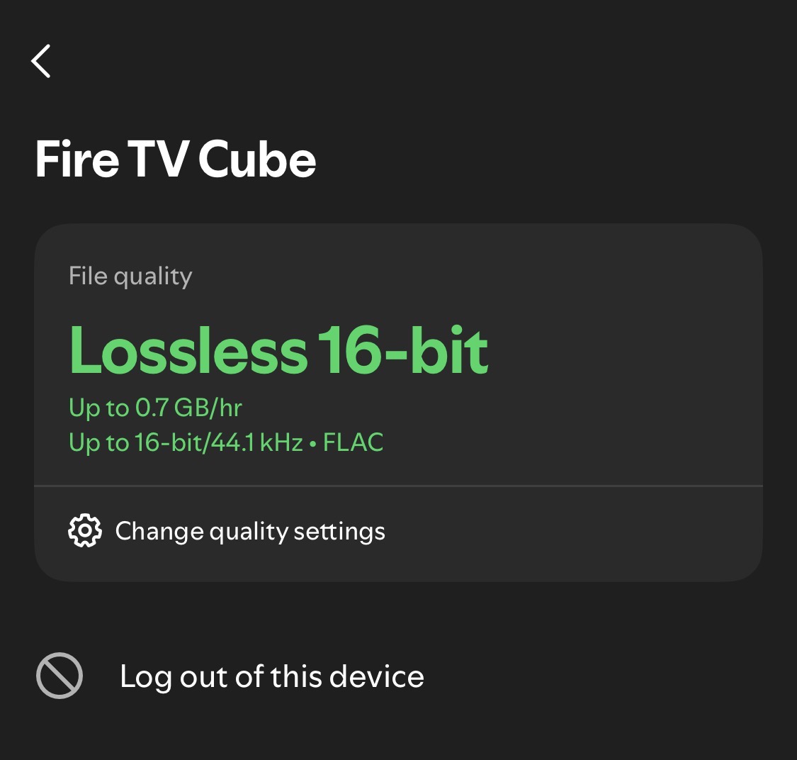

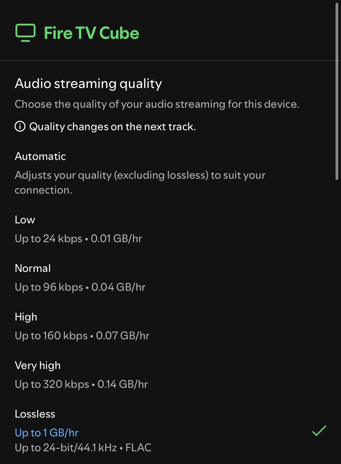

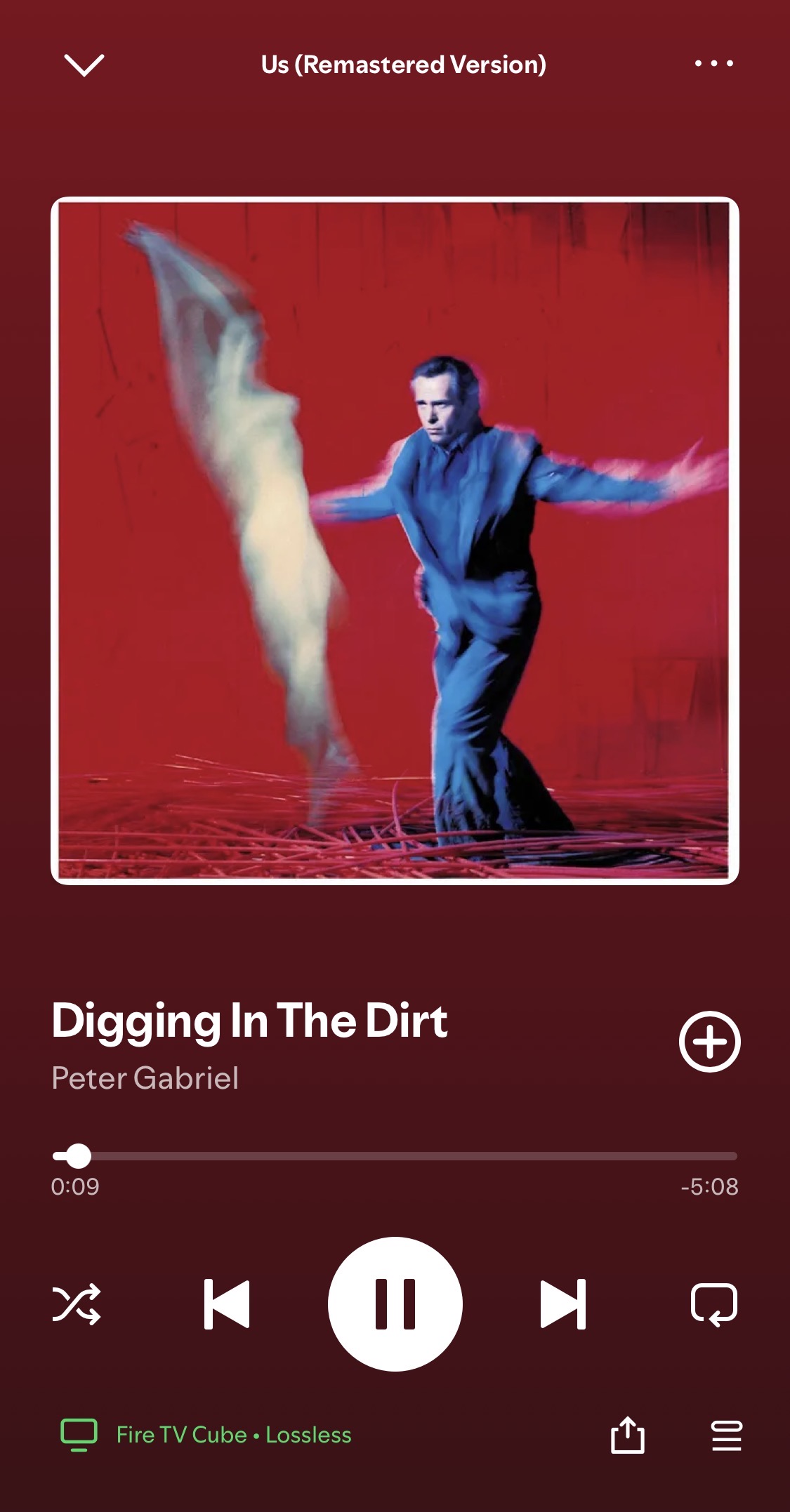

I gave Spotify a try on the Amazon Fire Cube gen 3 after switching out the Roku Ultra. The Fire Cube gen 3 supports Spotify Connect but does not support Airplay or Google Connect.
Spotify Lossless is supported at 16/44.1 but not 24/44.1. Signals are resampled to 24/48 over HDMI. Dark mode is supported in the Fire Cube Spotify app

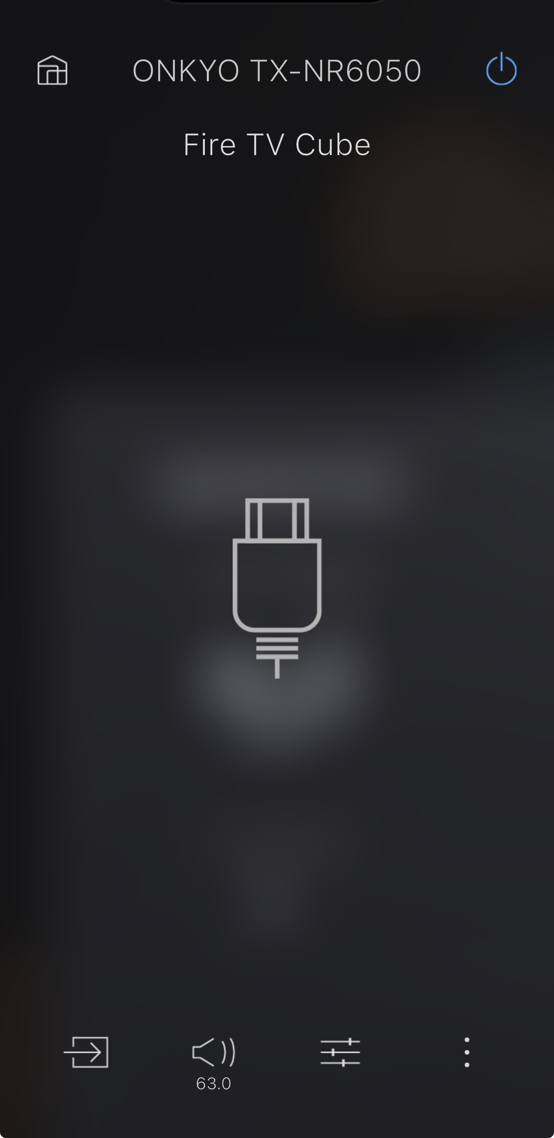

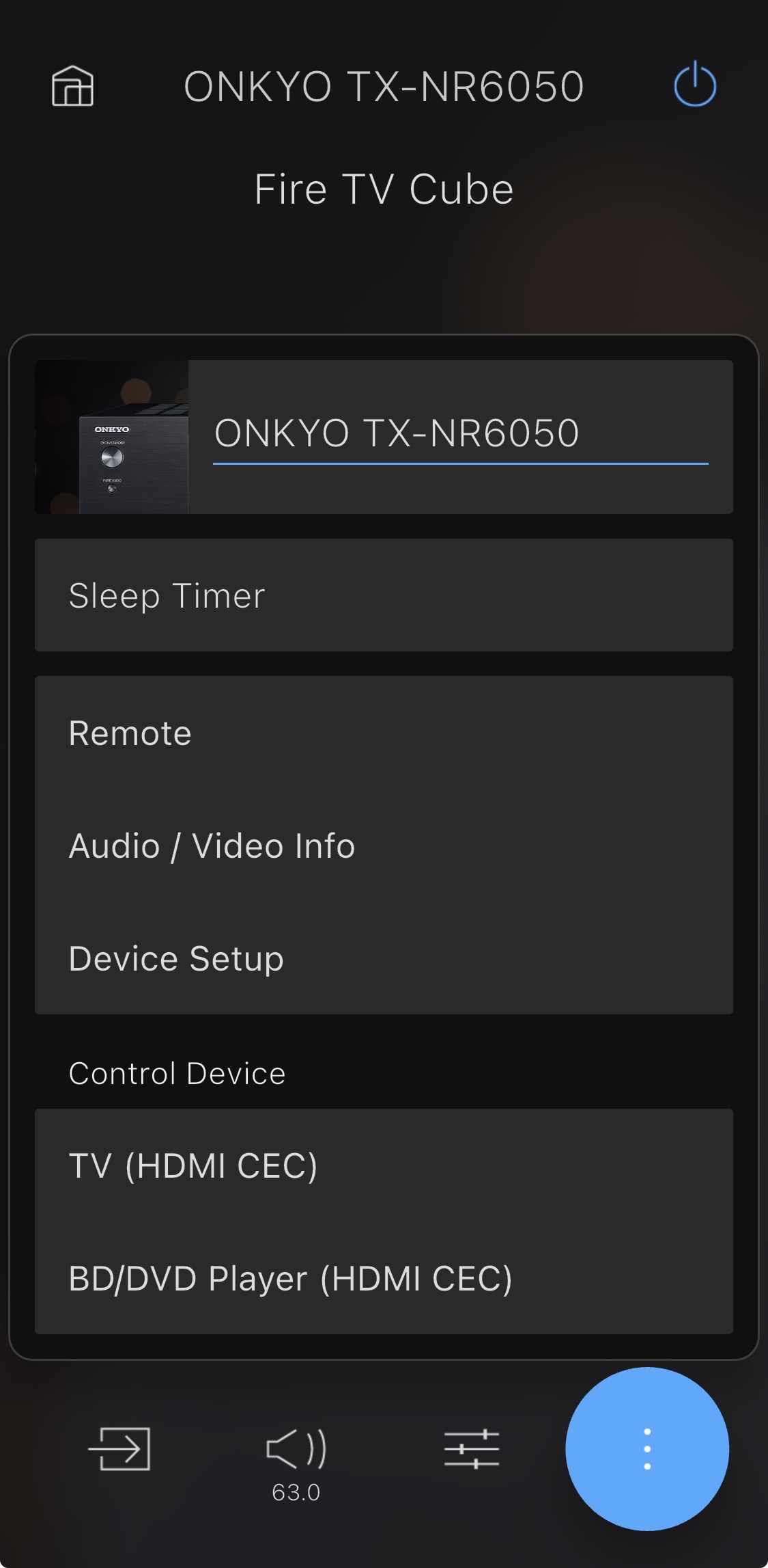

The Fire Cube exhibits some obnoxious audio and video behavior. Selecting “Best Available” in audio settings will result in everything being output as multichannel PCM with signals output only to those speakers corresponding with channels in the source signal. Setting audio to “PCM”for output results in everything being output as PCM 2.0. But, the signals come in hot and the sound level output is much higher compared to the “Best Available”setting.
iOS Spotify app:
