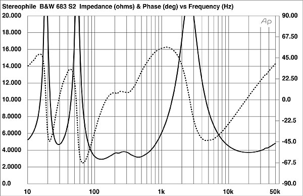

That you are getting the 2200's to heat up that much makes me wonder about the load your B&W 683 S2 speakers present.
Here is the Impedance (solid) - Phase (dashed) graph:
I am far from qualified to interpret this graph, but the conditions between 600 to 700 Hz of <4 Ohms and Phase around 45 degrees seems to be pretty tough for any typical amp!
Hopefully someone with a better trained eye for these measurements can comment.

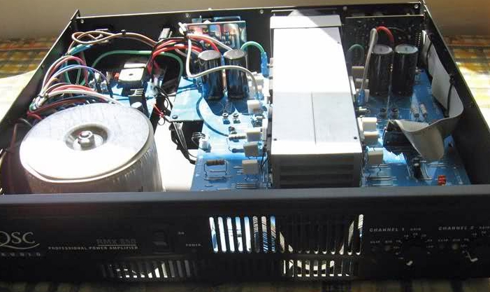

The Emotiva amp also disappoints me with how the two fans point straight into the cooling fins. In comparison to the QSC amp below, the fans in the A-300 look like they were added as an afterthought once they found out how quickly the unit overheated without a fan!:
Compare that to the QSC RMX-850 - their's has a tunnel with the cooling fins inside and the fan at the back draws air through the tunnel. This is so much more efficient!

See post #218 for impedence and phase chart for these B&W speakers that John has. Looks pretty bad to me, but I'm not the best resource on interpreting that chart.

B&W and Polk seem to be the worst common offenders. 600 and 700 series from Bowers both do it (iirc) and the older RTiA and LSiM lines from Polk have similar issues.
I don’t know how the new Polk line fairs... haven’t seen those benched yet.
