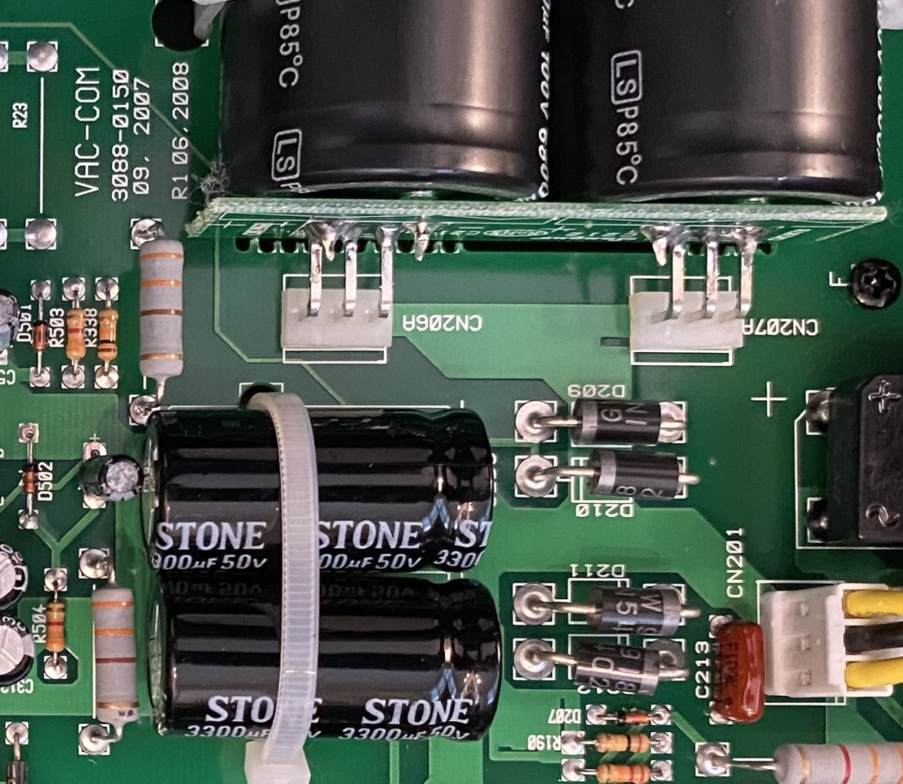

I have spent some time going over the nice images @John Galt posted and must thank him again for that.
so base on specs, @KEW did a nice job comparing the two (A300 vs M2200).
Based on the info shown by the photos, one can immediate see the following differences, though there are doubts on the Outlaw's PS capacitance and the transformers current ratings for both units.
A300:
- smaller transformer, lower voltage also, 43.5 V vs 53.6 V, that means the difference in max output into 8 ohms between the two should be a little more than 150 Vs 200 V as (53.6/43.5)^2 = 1.5183, so if the A300 is rated 150 W, the M2200 could be rated for 150*1.5183 - 227.75 W.
- Apparently a little more P/S capacitance, 2X10,000 uf (see Outlaw's below)
- Have two fans, and the heat sinks are obviously undersized and therefore the fans are needed, and as John already confirmed, will fire up when in use.
M2200:
- As mentioned above, the TX sec voltage is rated 53.6 V, that gives it an advantage in driving 8 ohm loads.
- The VA size seems limited as the current seems to be rated only 4.5 A, I have no idea how it could be rated 300 W into 4 ohms unless that 4.5 A on the nameplate is not really the maximum rated current. Hard to say without seeing the full data sheet.
- The heat sinks look much beefier than the A300, even for class AB, let alone it is the fact that it is class G.
Overall, I would take the M2200 for $299 each when on sale, especially for driving 8 ohm nominal speakers. The A300 may be do better, relatively speaking, for 4 ohm speakers but then you would have to put up with the fan noise. So in the end, the Outlaw with a fan on top may still be a better way to go.
I can't really say too much more without seeing the data sheets for the PS transformers and confirmation by Outlaw on the blocking capacitance that they claimed 2X10,000 uf on their website but the photos show 2X6,800 uf. The photos also show 2 other smaller caps but I could not see the nameplate info. If they are also 100 V rated and are wired in parallel with the 2X6,800 uf ones then it might total to 20,000 uf, otherwise Outlaw would have something explanation to do.

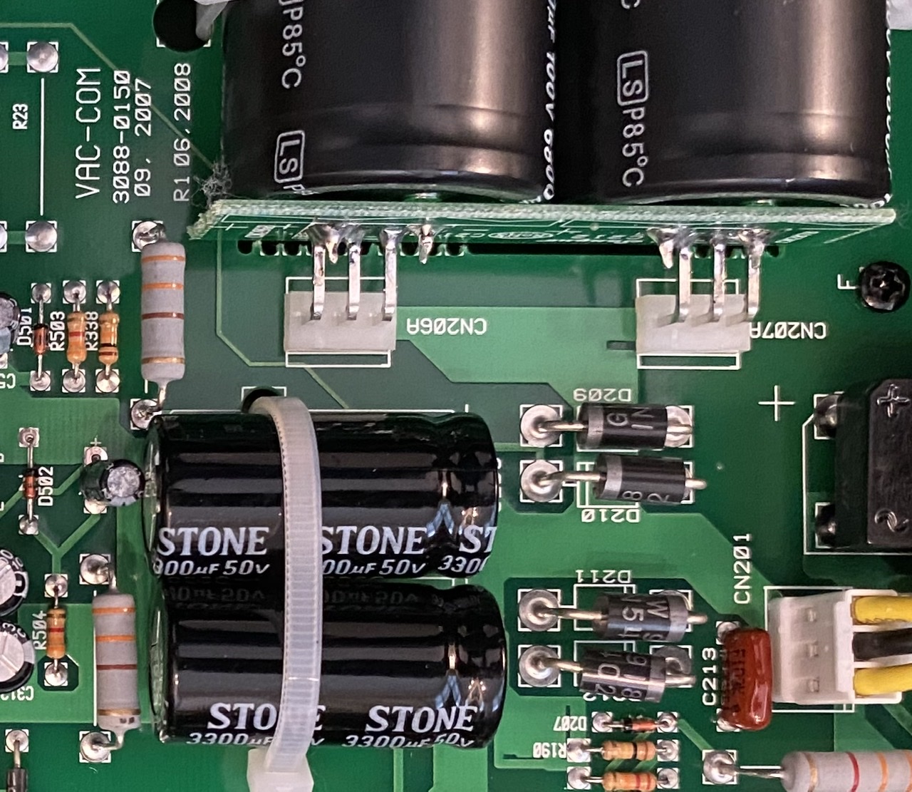

Are these the smaller caps that you’re referring to on the 2200? 3300 uF, 50 V.
I uploaded the best quality that the forum would allow, but I can email the originals if you want.
Those are the ones I referred to. So in theory if those two are wired in series, the equivalent cap would be 100 V, 3300/2= 1,650 uf and then if connected in parallel with the 2X6,800 uf + 1,650 uf = 16,900 uf total. I doubt they are connected together like that, but without seeing the circuit diagram for the power supply we can't be sure. Even if wired like that though, the total would still fall short. Hopefully they would respond to me tech support request ticket with a good explanation.
By the way, 13,600 uf (100 V rated) should be enough to target 10% ripple, 20,000 uf would be really good.

Got a response from Outlaw already, that's impressively quick. They confirmed the other 2X3,300 uf caps would make the total = 20,200 uf so their FAQ info would be correct. However, technically speaking, as Gene pointed out in more than one occasions, such calculations are not correct when caps are wired in series, or series/parallel combination as is in this case.
The correct total should be as I posted in post#268, 16,900 uf, again, technically speaking. At the time I was only assuming, but now it can be confirmed. So at least we can all breathe more easily, knowing Outlaw did not short change us on storage capacitance, though they did, technically speaking and to minor extent only that are completely forgivable because of the 100 V rated caps that are typically found in more expensive 250 W-300 W power amps.
