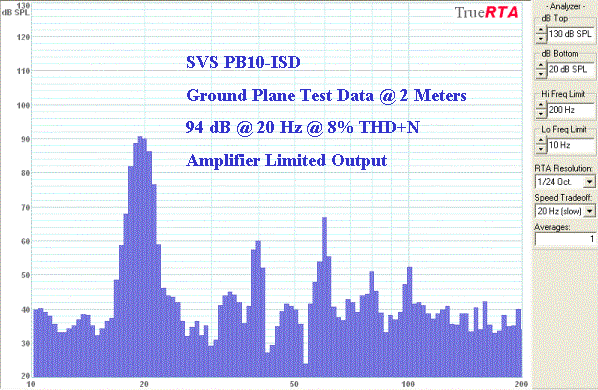

You asked for it...
5000R ground plain from AVtalk.
http://www.avtalk.co.uk/forum/index.php?t=getfile&id=4731
SVS PB-10ISD
http://www.hometheaterhifi.com/volume_11_4/images/svs-pb10-isd-fr2m.gif
Both microphones are placed 2m from the sub, ground plain. I highly doubt the equipment would make change the results.

Thanks for the graphs Sheep. These graphs just bring home another point about that SVS 10 inch.
SVS is clearly pushing beyond the limits of what a 10 inch woofer is realistically capable of producing. In trying to reproduce those sub 20 Hz frequencies, that 10 inch woofer is clearly breaking up and making all sorts of nasty distortions. Luckily for SVS, 20 Hz is the lower limit of human hearing. Those subsonic distortions are not normally audible. But you can feel that something is definitely not right. If you hear these kinds of distortions from your front speakers, you will freak out.
SVS's design philosophy in this instance clearly demonstrates that it is willing to sacrifice clarity (low distortion) for unrealistic subsonic SPL.

Am I missing something, where are you getting the distortion levels on that graph?

I can get you the distortion graphs for the SVS. I believe it was 10% limited. And BTW, distortion that low is extremely hard to detect with the human ear. It could go up to 25% and not be that noticeable.
Here are the ground plain numbers.
20 Hz: 93.9 dB (8.0 % - amplifier limited)
22 Hz: 96.9 dB (2.7 % - amplifier limited)
25 Hz: 102.2 dB
32 Hz: 104.1 dB
40 Hz: 105.8 dB
50 Hz: 106.7 dB
63 Hz: 105.7 dB
80 Hz: 104.0 dB
My DIY sub will be using the Infinity Kappa perfect 10inch driver, and it will make a mockery of the 5000R, guaranteed.

Yeah, a 10inch trying to pump out sub 20Hz frequency, impressive, but at what price?
That graph only shows SPL, it doesn't show distortion. A 10inch trying to reproduce sub 20Hz frequencies will have CRAZY amounts of distortion. Is this what you are looking for in a sub?
And just to salt the wounds, here is the distortion graphs from the 5000R. A 15inch woofer doesn't create distortion because it's bigger right?
