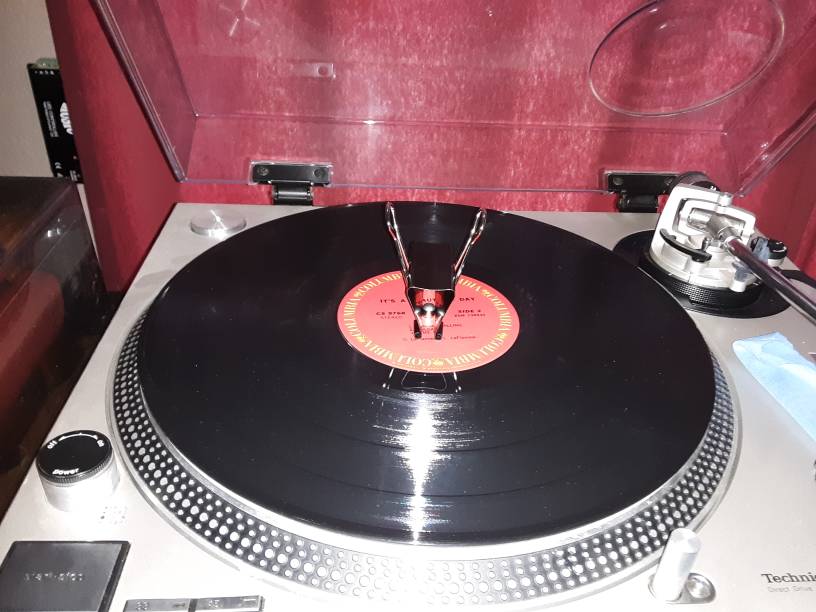

One quality clamp is cheaper than buying several records. Some people have very large record collections so chances are that more than one or two records may have a warp. Also, some records are rare or desirable pressings and may be difficult to come by or are very expensive.
I've never used a clamp or weight, suspect they're fairly much snake oil for vinylphiles. Was there any definitive testing other than the "reviews" by Fremer and his ilk?
Screw Fremer. I have a clamp- it flattens LPs and reduces the subsonic energy. I have had low filters since 1978 and they have always been defeatable, which has allowed me to see the effect and when I got the clamp, I tried it without the filter- it reduced the cone's movement significantly. If the LP is cupped, the stylus can't possibly be making contact with both sides equally and at a right angle. If the warp is like a wave, think about the force acting on the stylus and tonearm- it goes up and compresses the cantilever, which tries to resist, but has to move where it goes because the tonearm's mass makes it resist the cantilever's force. The height corresponds to the amplitude of what the cartridge produces and it's all at very low frequencies, which can modulate the rest of the signal, it wastes amplifier power and causes some woofers to 'bottom out'. If the warp is bad enough and/or the stylus compliance is wrong, the stylus can lose contact completely.
As I wrote, I recommend a clamp, not a weight, although adding weight can dampen vibrations in the base because it changes the resonant frequency- I just wouldn't put it on the spindle because it could cause problems for the bearing.
Well I think weights are extra silly, so there's that. I'm certainly not going to look to youtube for proof, tho....I'll take your word some warped records can be improved with a clamping mechanism instead of just getting rid of the defective record...
It's Physics, not silly. Nobody is saying Unicorns suddenly appear when a clamp or weight is used.
Look at an oscillogram of musical signal and then, overlay a 5Hz-15Hz signal from a warp- what do you think that will do to the signal you want to amplify? Now, think about the tonearm resonances after they encounter the vertical warp.

Depends on the warp- if it's outside of where the clamp makes a difference, it's time to replace or try to flatten it in some other way. People have come up with all kinds of ways to do that and some include heat, which I'm not sure I would recommend.
