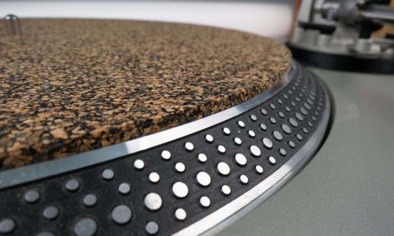

Also, I had a chance to try this mat:
The cork/rubber one. That's such sh** I couldn't believe. Not only did it not work to stop the cones jumping, but it built up such static that it came off the TT together with the record :D:D:D:D It was stuck on it like a sticker, although the package said it doesn't build static. Useless and worthless.
