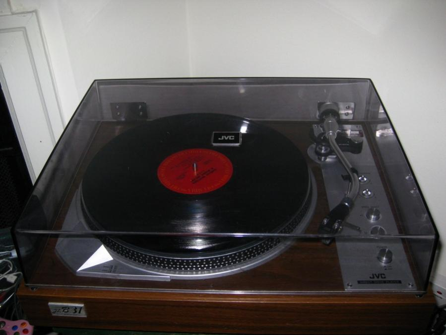

If the base is made inert by pressing on it, the sound must be affecting the tonearm and cartridge. Sometimes, the dust cover plays a part- I had a JVC turntable with an Empire 2000eIII cartridge and it didn't take much to make it howl. It was much better if the cover was open. Nice looking table, though. I never tried another cartridge on that one- I just replaced it after realizing it was a bad design.[/QUOTE]

Was the cartridge or the table a bad design? :)
I had an empire 2000eIII way back in the late 70s early 80s on a Technics and never noticed that problem. I didn't have it very long as I replaced it with a much better Shure V15 Type 3 shortly afterwards so maybe I did have the problem but didnt notice it.

It was the table- I used to call it 'The Feedback Special'. Particle board base, wood grain- not bad looking, though.
View attachment 29383[/QUOTE]
That is a good looking table. BTW I always remove the dustcover when I play LPs on my Rega Planar 3 even though Roy Gandy of Rega says its not necessary.
