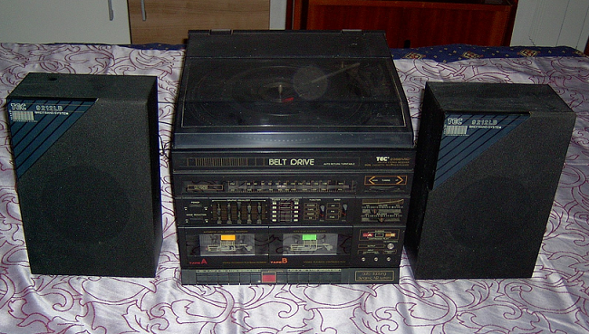

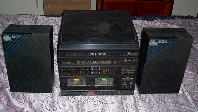

LOL!
I like the way they decided it was important that "BELT DRIVE" dominate the face of this unit!
Cant even tell if the cassette deck has Dolby though I doubt it or it would also be prominent on the face of the unit.:)
