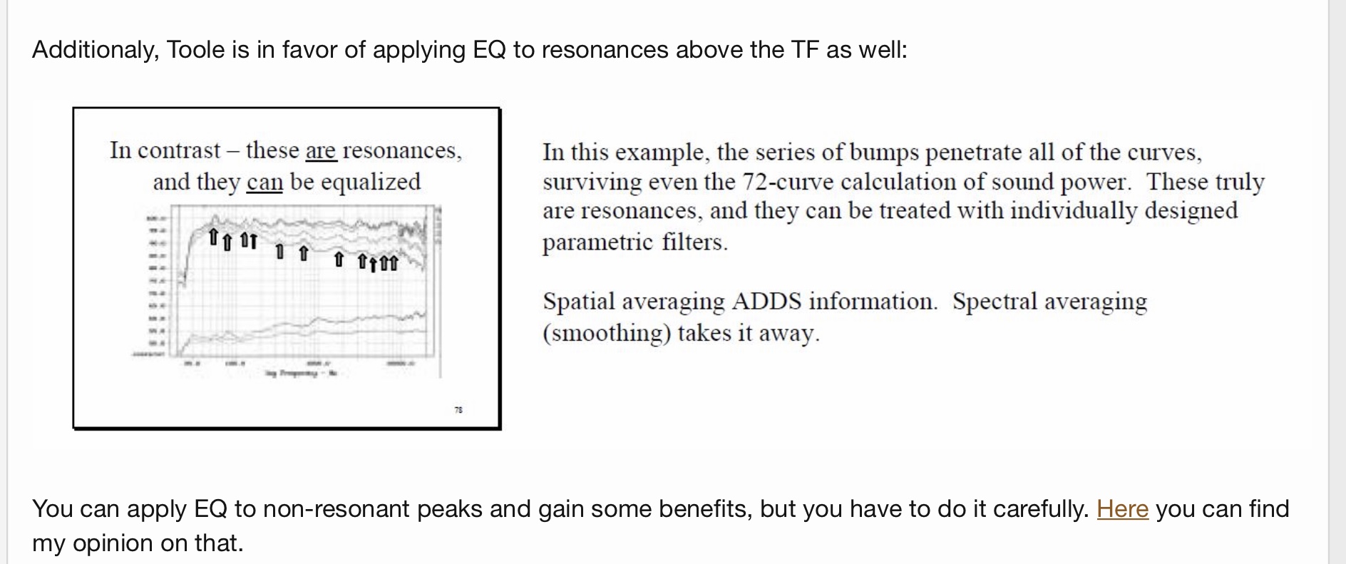

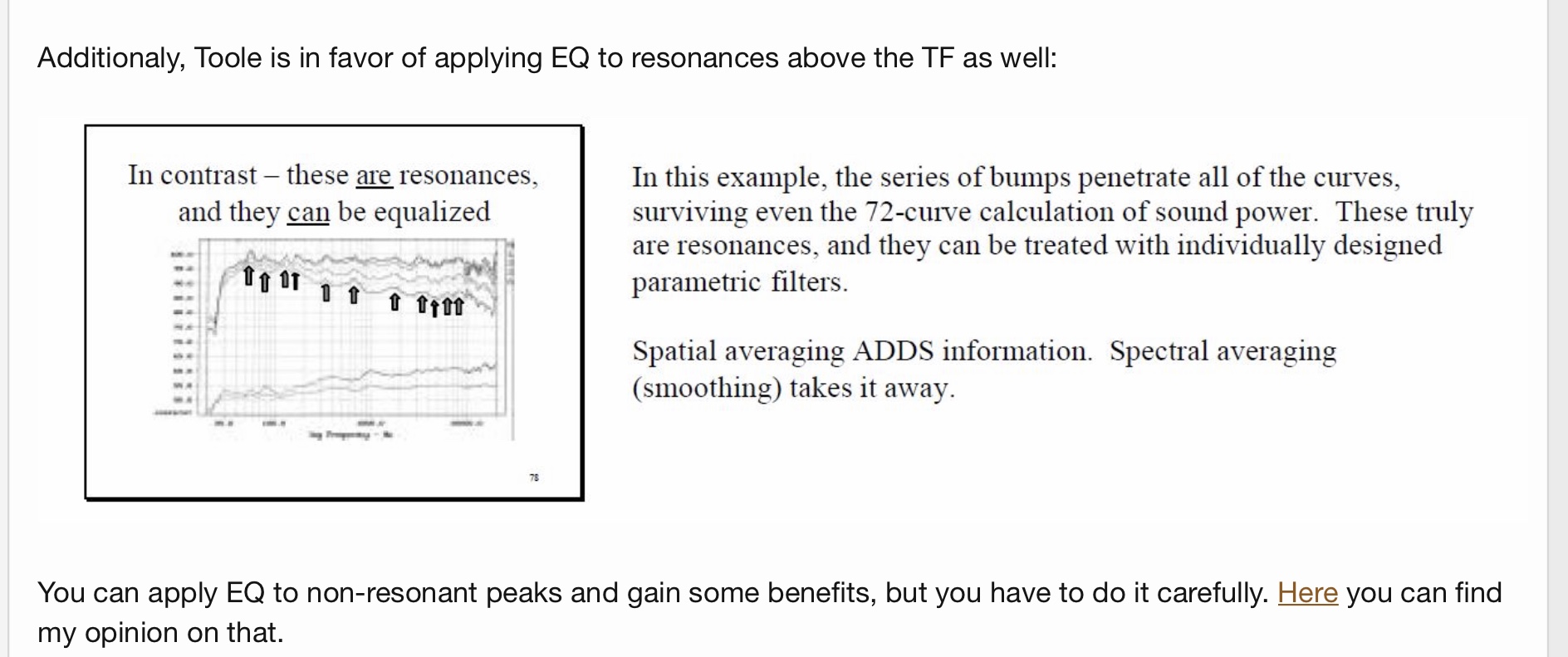

The power of Audyssey is really interesting. I think an even bigger question is if using Audyssey above 500hz, how should it (if at all) to improve the sound in your room, and not just a frequency response graph. It seems that forcing a target curve, and correcting to that curve may create more issues that they solve. To me it seems the best chance of getting better sound is to correct the speaker itself and let the ”room curve” happen naturally. This is what I am interested in and sounds like what @Jon AA is describing. The problem with EQing at the higher frequencies I have had is even though I have a tilting downward curve it compares that with what Audyssey measured in the 9 point measurement And addd/boosts cuts based on that. In my case the 9 point measurement showed a significant drop in frequency response. As a result Audyssey actually boosted the 5k-10k region Instead of cutting that region. After measuring with REW (RTA MMM) it showed that boost when that isn’t what the target curve I made looked like at all. I guess the point is it will apply boost/cuts based on what Audyssey measures and if those measurements aren’t accurate it could do the opposite of what you want. My rule is to always to post measurements in REW to make sure what has been done.
PENG
But he is in fact using Audyssey to EQ the higher frequencies above the room room transition frequency. I think he knows what he is doing. As he mentioned, Dr. Floyd did not say EQ'ing higher thant the RS freq is bad, he's just saying the data collected by the REQ systems were not reliable/could be bad. So if you are using the info from the REW measured response and let Audyssey creates filter for it, I don't see how it could get you worse results, if accuracy is what you want. If you are concerned about the so called "sound quality", then all bets are off, back to the subjective side again in that case.

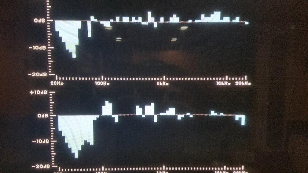

Currently, Audyssey is boosting about 10 dB around 200 Hz which is creating problems with my speaker. It is bottoming out there at high volumes. So i want to figure out how I can edit my desired curve to get rid of that boost.
See the 2nd Audyssey correction curve (right front speaker). below.
Not at expert on this at all, but am interested for sure in the possibility of using audyssey differently if it results in better sound. You are correct, that Toole does not say EQing at higher frequency is bad necessarily. I think he is saying that only speaker resonances should be fixed. These are the dips and peaks that are found in all of the spinorama type of measurements. Other humps/dips should not be have EQ because direct sound and reflected sound will be different. In order to know this level of detail, we will need speaker measurements.
My other point was my Audyssey measurements generally track my REW measurements but at higher frequencies they seem to different quite a bit. I of course trust REW with MMM measurements with a calibrated mic much more than Audyssey. If your original measurements aren’t accurate at high frequency, don’t blindly trust Audyssey calibration at the hithere frequencies. Be sure to do a post measurement to verify what it did. In my case I was trying to have a downward sloping curve and it tilted it up from 5-10k due to the inaccurate initial measurement of Audyssey.

Currently, Audyssey is boosting around 200 Hz that is creating problems with my speaker. It is bottoming out at high volumes. So want to figure out how I can edit my desired curve to get rid of that.
My other point was my Audyssey measurements generally track my REW measurements but at higher frequencies they seem to different quite a bit. I of course trust REW with MMM measurements with a calibrated mic much more than Audyssey. If your original measurements aren’t accurate at high frequency, don’t blindly trust Audyssey calibration at the hithere frequencies. Be sure to do a post measurement to verify what it did. In my case I was trying to have a downward sloping curve and it tilted it up from 5-10k due to the inaccurate initial measurement of Audyssey.View attachment 36411
I think Floyd is right in saying it the way he did. He knows if people play around with the higher frequencies without knowing enough to not get into trouble then they would more likely make things worse.
Sent from my SAMSUNG-SM-G930A using Tapatalk
In post#1, I listed the boost and cut limits:
- In AVR systems, the filters are set to +9 dB max boost and +20 dB max cut.
9 dB can of course be not very friendly to to the mid woofers/woofers of many speakers at even moderately loud volume if you sit a few meters from the speakers.
On your graphs, I don't see any 10 dB boost though, it looks like there is a slightly higher than 5 dB boost at just below 200 Hz. That can still cause the driver to bottom if you crank things up too much, but again, it always depend on how loud you listen to and how far you sit, obviously how much can the driver take.
If you have the Editor App, you can definitely do something about the boosts. Without it, it would be tough to find a good way.

I thought the cut below 100 Hz was due to bass management. I use ls50 which is plugged with a bung so no inherent output below 100 Hz should be.
Now, how do I know that the bottoming out is due to this boost at 200 Hz? I don't. But the bottoming out is only on the right speaker and it goes away if I exclude L/R from Audyssey correction.
I was hoping that I can edit the desired curve sufficient enough to get rid of this boost.
Is there any other way to get rid of this boost? Other than this, Audyssey does improve sound quality substantially.

I never listening to any more than 80 dB average. Most of the time it would be between about 68 to 75 dB average at the most with the amp (any of my amps or receivers) outputting less than half a watt peaking to no more than 25 W or so. So I have never experienced any bottoming whether I have Audyssey or Dirac Live in use.
shkumar4963
I also don't hear these speakers very loud and with most music, there is no bottoming out.
But with some music at moderate volumes in some passages the right speaker does bottom out.
Besides, it is just bugging that Audyssey is boosting 6 dB at 200 Hz in just one speaker and that limits my ability to play these speakers.
So I am looking for some easy way to tell Audyssey not to boost.
Other than this Audyssey does improve the sound quality.
Here is what I tried so far with less than perfect results.
1. Exclude Audyssey from L/R
2. Limit front speakers Audyssey correction to 110 Hz
3. Put an additional slope of 12 dB per octave on the front speaker desired Audyssey curve at 100 Hz. (Start of the slope at 180 Hz to -24 dB at 50 Hz). Crossover set in Audyssey at 100 Hz.
Correction: it seems that the max slope in MultEQ could be 6 dB per octave. (180 hz 0 dB, 50 Hz min -11 dB.)
