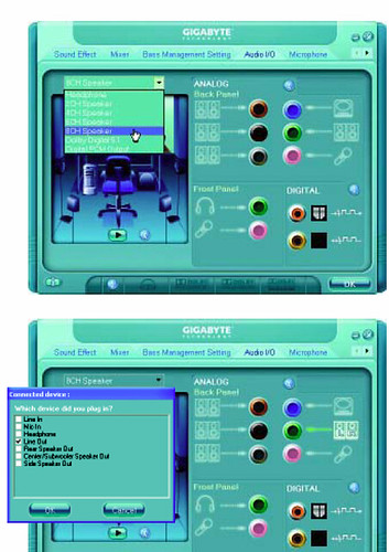

When you plug in the cable to the center channel/subwoofer output on the mainboard and into the amp do you get this screen:
Yea i got that screen but it still gave me signal that didn't hit any lows.
I played around with that for a few minutes and still it was clear something more significant was wrong. The subwoofer barely moved at all, for me, that was a major problem.

I think he is getting the center channel output from the sound card. He is picking up a 1/8 to stereo RCA then adapted to 1/4" to find out which channel the sub output is on.
Shame on Gigabyte for not being clear in their user guide.
