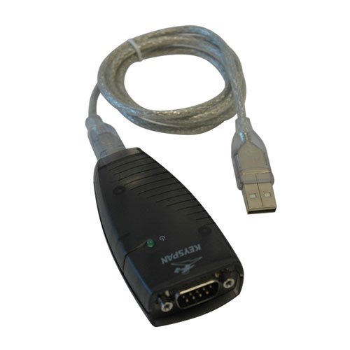

Wmax - What brand / website did you order your serial to USB converter for your DCX?

Keyspan is a pretty well known unit
http://www.amazon.com/Keyspan-Speed-.../dp/B0000VYJRY
You can also get a PCMCIA to serial card that will work very well if your using a Laptop...
I am using this one, I got off ebay...
search PCMCIA to serial on ebay or google

Thanks Warp. However, I have one similar but the problem is... on the back of the DCX the serial connection also has the small metal screws. Most Serial -> USB connections have the metal buttons also.... making it impossible to connect.

Monsterman, the cable on the USB to SERIAL is too short for practical use. Use a serial extension cable; this will take care of the length and screw end issue at the same time.
Yes, you must get an extension cable also in order to use either device I listed.... I would suggest a nice long one at least 20ft for flexibility.
I got a 6ft cable used off amazon for $9 shipped. That should work fine for now considering my DCX and PC are right next to each other.
