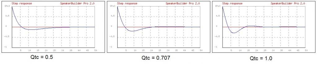

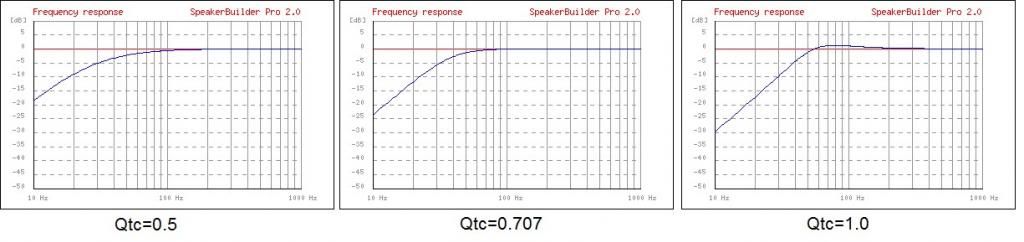

Qtc (system Q) relates to sealed enclosures; in this case, I'm modeling "driver X", which yields a Qtc of 0.5 (overdamped) in a 157 liter cabinet, a Qtc of 0.707 (critically damped) in a 56 liter cabinet, and a Qtc of 1.0 (underdamped) in a 24 liter cabinet.
So, I'm not sure I adequately understand step response as indicated in the bottom 3 graphs. What are the labels, i.e. what's being measured in those graphs?
In the top 3, we see a typical sealed response with a more shallow low frequency roll-off than it's ported brethren (though, assuming a larger cabinet and proper design, the ported sub will not start rolling off until much lower).
Sound pressure vs time.

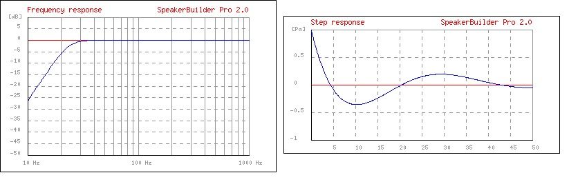

Indeed. Same driver in a ported box (tuned to 22Hz, 111L)
Note that step response does depend on frequency response; the ported box has much more output down low, which takes time to settle.
