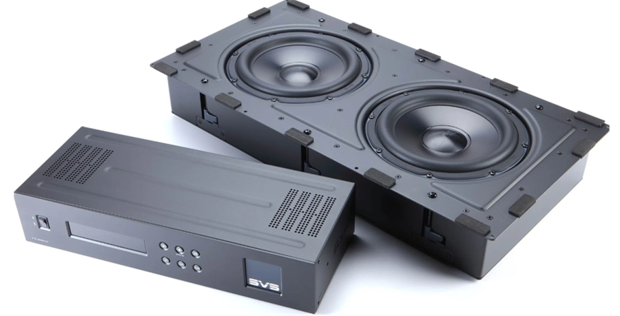

SVS 3000 In-Wall Subwoofer Review
  • Thread starter Thread starter shadyJ
Thanks for an extensive review, Matt.
To me, running four on-wall dual-10" subs with many of the same design limitations (minimal cabinet volume, high Fs, limited deep bass output), from Artcoustic around 2010, it's interesting how close in design thinking these products are when considering the time-gap. Biggest difference is DSP and more efficient and powerful amp, both things I've solved externally rather than through a boxed solution.
For me personally, I ended up removing a driver from each enclosure. The chosen Peerless woofers simply cannot reach any meaningful excursion in the given volume within their power handling.
Four drivers in four enclosures give me more than 3dB more output for the same power due to being able to better utilize the mechanical properties of the individual driver.
All of this to say, I'm kinda curious what led SVS to decide a dual-driver setup was their best course of action. Sure, the drivers are probably better suited to the enclosure than what I'm working with, but it seems Qtc and Fs are much the same, as is the CEA burst numbers, being close to validating what I've observed with my subs in my room re. deep bass.
I'd love for you to compare this 3000 in-wall to the Next Level Acoustics in-wall which uses the SB Acoustics shallow-mount subwoofer drivers. Those are specifically made for small enclosures but available stand-alone.
Best regards
The SVS performance is near textbook for what it is. It has about as much output as you would predict from a model based on its power and displacement. With that being said, I expect the SB driver to perform a bit worse. It has less displacement.
Next has nowhere near as sophisticated of an amplifier/dsp solution and that is critical to the performance of a sub like this. A lot of the value is in the amp/dsp. I actually expect this to be better than the next sub. Now if they want to send me a sub to review, I am happy to test it and be proven wrong.
At least the spec page is honest. 107 dB at 32 Hz, 1/8th space lines up with the CEA-2010 2M RMS testing seen here.
I do find the marketing a bit hyperbolic. "No compromise", but you need 4 of them to hit reference at 30 Hz. That seems like an expensive No-compromise to me
In its defense. It makes the least compromised of its packaging. That was the biggest delay in getting this review out. I was initially really disappointed in the performance. I had read other people claiming to use it as their main home theater subwoofer and finding it rewarding. I eventually re-evaluated my expectations against what it was. If you get past the over hyped marketing and over the top reviews, you realize that it’s a really good option for a difficult product type. Lots of integrators need retrofit subwoofers that don’t totally suck. Most totally suck. This one doesn’t totally suck. It will easily be flat to and below 20hz in most residential rooms it would go into. It plays loud in the midbass, not the deep bass, but with boundary and room gain, you will probably find it fine for casual listening.
