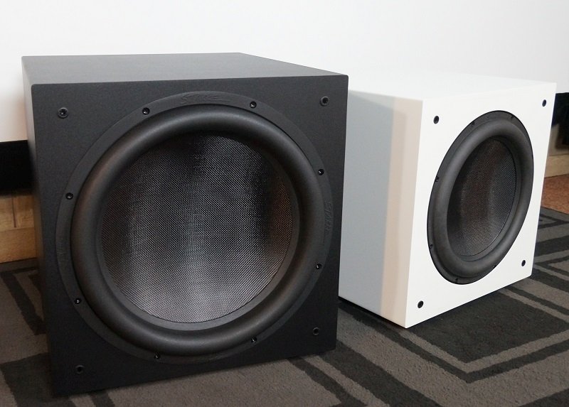

Starke Sound SW15 and SW12 Subwoofer Review
