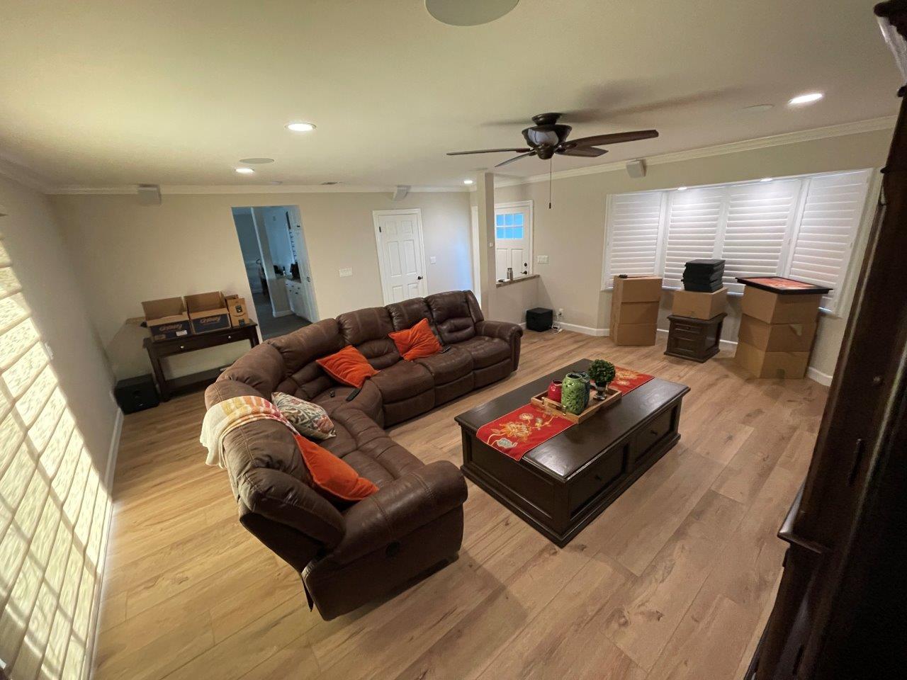

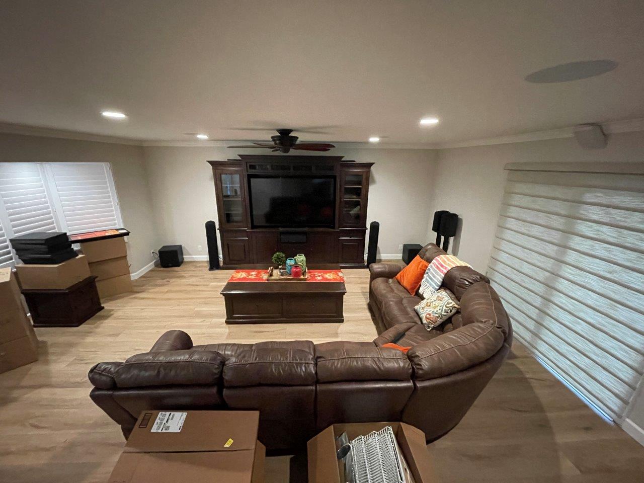

You have two front looking pictures, nothing back looking.
From the picture it seems your front Atmos is over your front speaker? If this is so, that is not good at all.
Can you relocate them backwards?

The front ceiling speakers are closer to the couch than the front tower speakers but only by 2-3 feet.
I will take more photos tonight.
Construction is done and we are on to other things. Access it really difficult and we won't be relocating anything. Some of the stuff is where it had to be or I had to go without. I chose to do the best I could at the time.

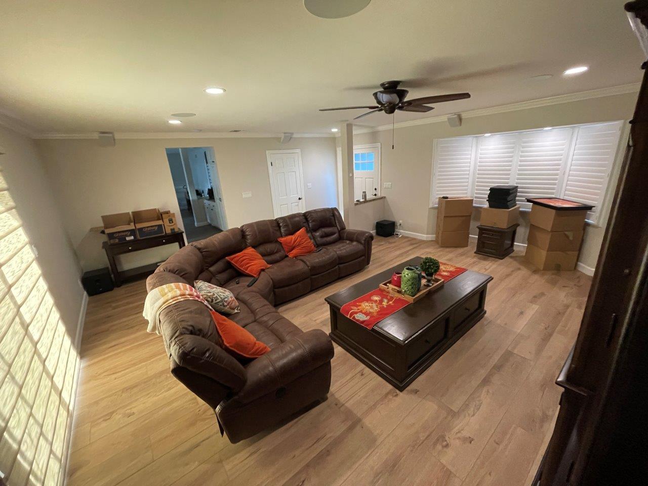

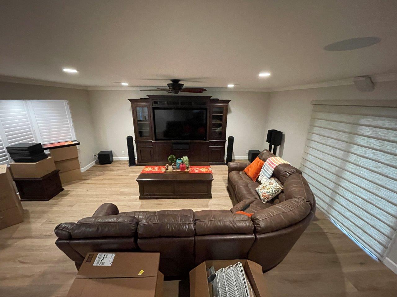

I think someone asked for a picture of the rear of the room. Here are both in one post.
