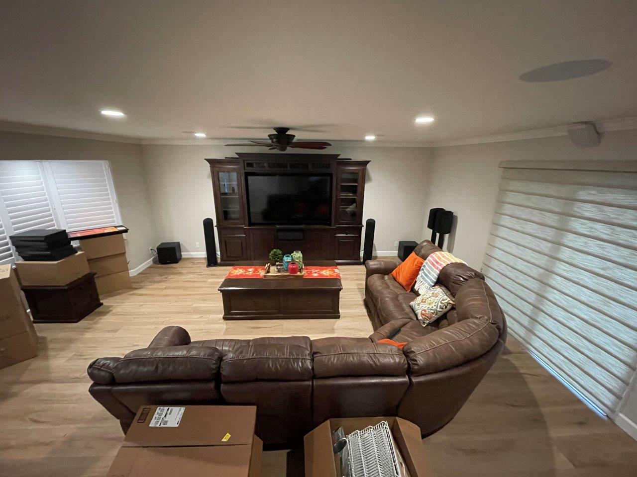

Here is a shot of the space I have. All the subs and speakers will go away. I plan to sell all the Pioneer towers and bookshelf Atmos speakers since I now have in ceiling
speakers.

Nice space. Looks like you have room for decent size towers and two subs, but bear in mind that if you place the subs in the corners the bass will get more pronounced due to corner loading, which can make the bass sound boomy and less detailed. You can experiment with having the subs in the corners or moving them between the towers and cabinet. Mid-points along a wall can work better to smooth out the room response. We also have members that added a third sub behind the couch (maybe behind the rounded corner). Having a sub near field will yield a more tactile response if you want to feel the bass.
The rest of the room has been planned out and is set in stone. The only area that I have to work with is the back wall on each side of the cabinet. Aside from a budget I can do anything I want as long as it "fits" the room.
I agree. The subs look small and cheap. My room is larger than yours and I have only a single sub. But it is a well powered 15" sealed unit. It can shake the walls literally if I turn it up but I don't really want my walls shaking. Shaking walls don't contribute to good sound. It wouldn't even occur to me think I need more subwoofer. Having four subs isn't the answer if the combination of them doesn't do the job for you. I agree with the posters above.
