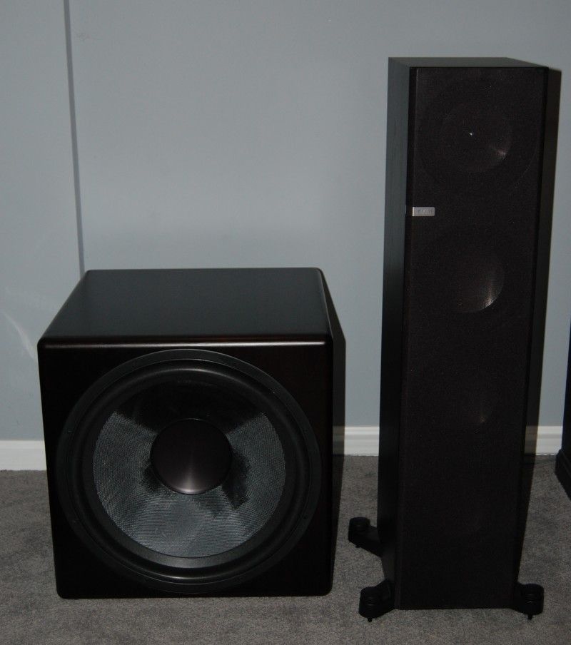

Doesn't look like a 18 inch sub next to your speakers from the pics, but I bet in person it's huge.:eek:

The driver itself is pretty imposing on its own, but overall the sub is relatively compact. It's ~65% of the old Ultra by volume, which is a nice change (and one of the big reasons I went in this direction).

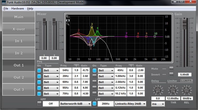

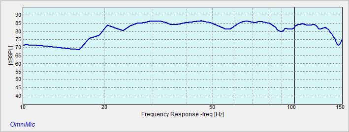

Spent some time massaging the Funk's FR with the built in EQ (no help from EmoQ):
For those curious to see what the Funk back end looks like in that regard:
I started off with the "Rock" setting which added the first two EQ points, and then added in the four relatively narrow band EQ points to cut down some peaks and help fill in some dips (though I aimed to avoid a net boost). I also eased off the boost at the 20Hz mark in exchange for disabling the HPF/rumble filter at 20Hz. The white line signifies the net result of everything.
Also worth noting, the EQ available is much more than the section title "PEQ" suggests; you can set shelf filters among other things which could be used to boost or cut the high/low end as well as additional HPFs/ LPFs, etc.

I had sent the above info to Nathan earlier, but didn't had time to implement his suggestion until now. His thought was to trade some sub-10Hz output for the 10-20Hz range by re-engaging the 20Hz high pass filter, but at the same time changing EQ2 to a low shelf filter w/ Q7.9, +12dB. The net effect isn't huge (basically give a couple dB / take a couple dB), but the thought is that it adds to the effective extension while keeping the system out of trouble in the deep infrasonic realm.
