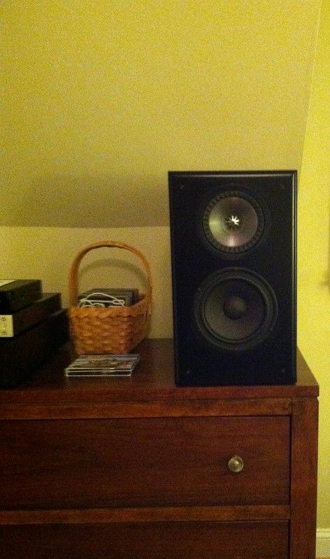

So, does the eagle sing the song that you anticipated?
Im guessing yes based on where you had it trained:D
Indeed it did. The family resemblance is very much there, with a broadly similar sound to the Philharmonitor.

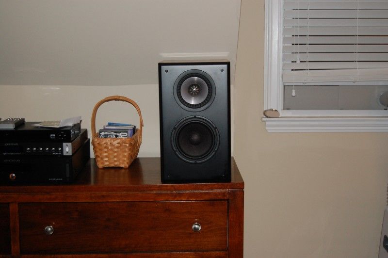

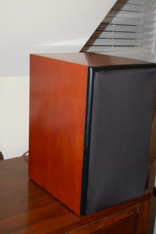

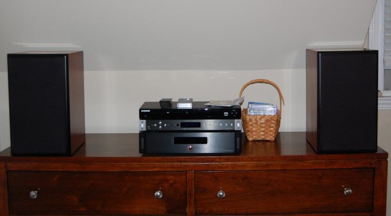

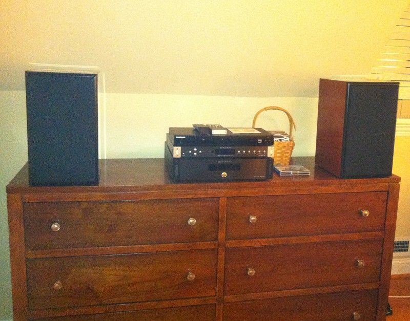

Here are a few slightly better quality pics:
Aesthetically the Dayton cabs aren't too shabby; only real complaint with them is that the magnets holding the grills are a bit weak.

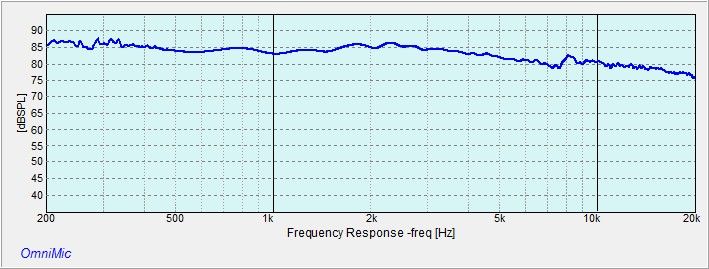

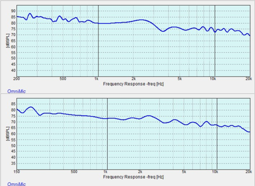

On tweeter axis FR, unsmoothed, mic @ 1 foot.

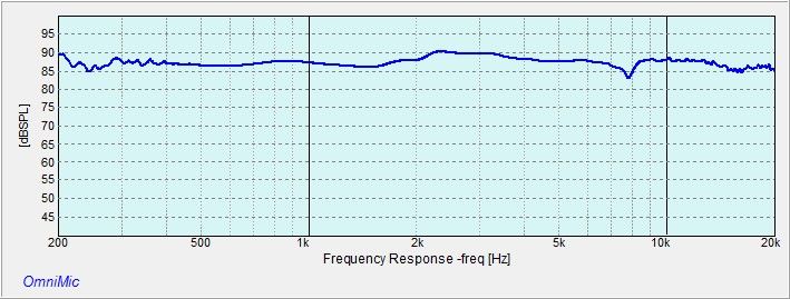

And an off axis shot (didn't sit an measure out how many degrees off, but eyeballed around 60 degrees)

Everything looks good and weak magnets can really be a pain. Any reason you went with 1ft instead of 1m for the measurements?
None in particular, though it does help to further control early reflections at the expense of not getting the woofer fully integrated into the mix.

I would think omnimic would give you gating options so that you could still get rid of those early reflections from the measurement.

It does, but the more you gate, the more resolution you lose at the same time.

This is true. I don't think I've ever had any issues with REW and gating, but I've never compared against a 1ft measurement. Perhaps an experiment this weekend, or tomorrow if I don't get called in, to see what's what with my own rag tag measurement setup.

This is what the 1m ~60 degree data looks like with a bit of smoothing (took this yesterday): top curve is the Q700's for comparison
No real issues with either method IMO, just different perspectives.
