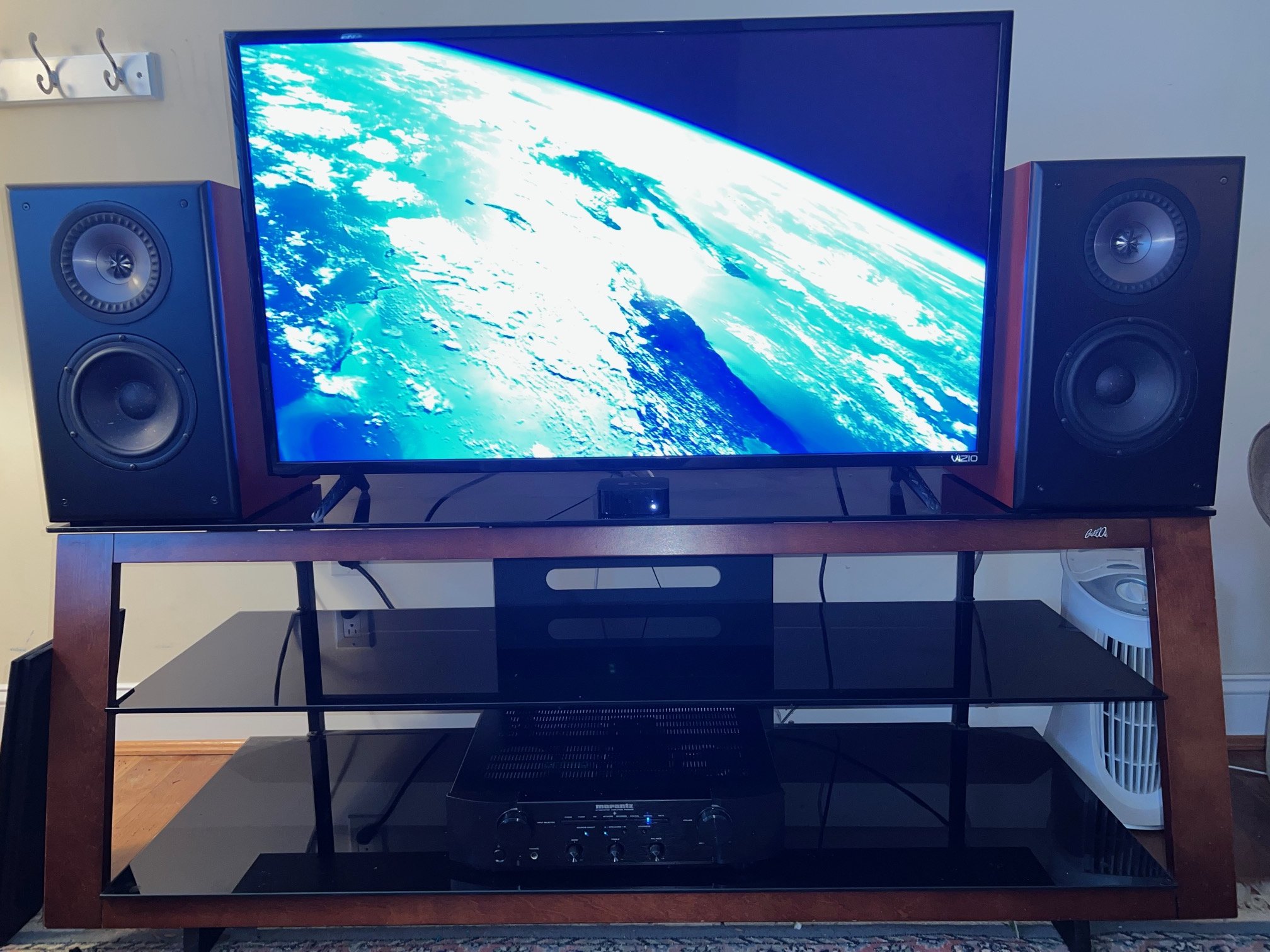

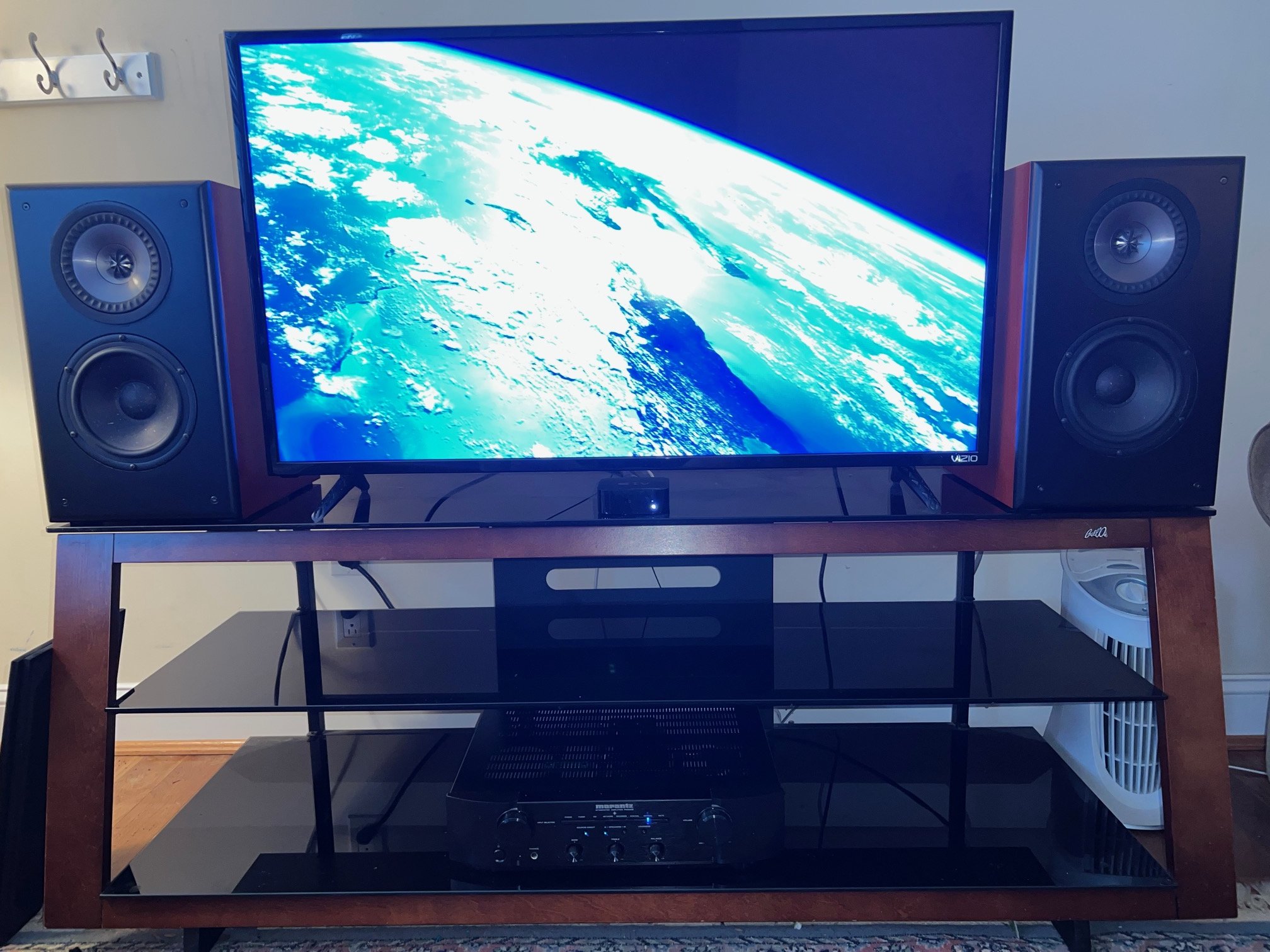

The “Home Alone” rig…
An older 43” Vizio D-series 1080p fed by an Apple TV in stereo. The Vizio feeds a Marantz PM6005 via optical, which then feeds the old Dennis Murphy customs. Seating distance, ~45”.

That’s how I roll these days.
The dang kids ran off with the Xbox and Nintendo Switch, not that gaming appeals as much to me in my “old” age. Don’t really need much else to enjoy some TV and the occasional flick. The bookshelves give me good response down to 30Hz in room, which is perfectly adequate.
Looking to move to Ohio at some point in the not too distant future, and may have a buyer for the entire lot of everything else, so I’ll have funds for a future custom active project with Funk if I’m so inclined. I wouldn’t mind a higher sensitivity concentric mated to a pair of decently sensitive woofers in a sealed alignment. Get me an F3 around 50Hz with a Qtc of 0.707, the ability to EQ to the room, and I’ll be golden on the audio side. A nice 4K TV that fills up the stand, and I’ll be good to go on the video side as well.
