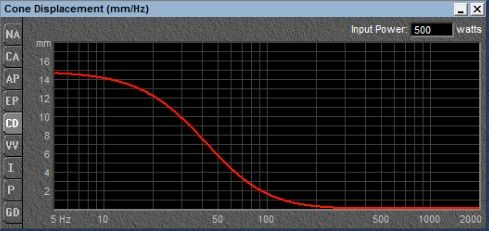

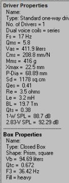

Of course, as I mentioned on the boring thread, the hunt is now on for a pair of capable sealed subs to replace the PB13U. Fortunately, I might have myself an idea for a custom sub: a side-firing enclosure about 16"W x 22"H x 22"D and either the Dayton HO or Stereo Integrity 18" driver. As they don't need a lot of juice, I'd probably just stick with a ~500W plate amp for each. Reckon a Q of 0.8 or lower should be achievable with those dimensions. Just have to wait...and lose weight :D

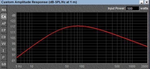

Stereo Integrity 18", side firing, 1.5" driver baffle, .75 walls, heavy fill, external dimensions as specified.
Not too shabby looking. Should actually work pretty well in my room. PS: Any thoughts on the Hypex amps over at Madisound? The 400W ought to do the trick pretty well, though they're not cheap.

So you're going to need some EQ in order to get these things flat any lower than they are, even with room gain. If this is the amp you're talking about, and getting two of them, I think that's too expensive if you're then going to need EQ as well. At least when you could do one of these and have a good EQ built in along with the fact customized REW filters could be sent to it as well. However, if you're going to power them both from a single plate amp, then it would probably make more sense to build a small separate enclosure and just run the neutrik cord to each sub, but at that point a plate amp no longer makes much sense and a pro amp would probably make more sense, since you can get a Crown XLS for pretty cheap to power both and a miniDSP 2X4 for the EQ.
If you're dead set on having a plate amp for each and powering separately, I would think that a BASH500 would probably make the most sense and save money as well with a miniDSP added on.

I'd prefer a plate amp for each (not much room for a pro-amp at this point in the cabinet); wasn't sure how the basic BASH would stack up against the Hypex. I know that Rythmik seems to work some magic with their relatively low powered Hypex amps, but obviously I don't get into this stuff all that much. Of course, one idea I have thrown around with myself is sacrificing some output and just running the spare channels from the 7125. With 200W into 4 ohms on tap per side, it'd still be fairly potent (and free :D), and I'd still have an upgrade path later. On the down side to all of this, a pair of E15s still look like a very compelling solution that doesn't give up much performance to this possibility.

With this new information, I vote that you build 2 with the 18" SI in a box 21.5"H X 21.5"W X 20".25D, making them only marginally larger than the E15's. Power them with the Outlaw, add a miniDSP, EQ them flat, but add a HPF at 20hz with a shallow rolloff or 15hz with a steep rolloff and enjoy until you feel like throwing more power at them. You should be looking at ~107-113db from 20-100hz+ not counting room gain or doubling up, given 200W each.
($220 X 2) + $135 + $200 = $775 for two subs and miniDSP (finish dependent).
