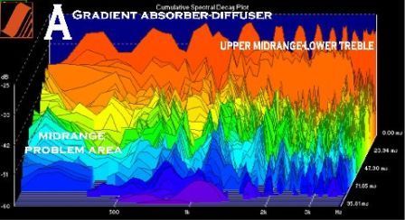

Can anybody make heads or tails out of this graph. This is from a Gradient- Absorber Diffuser Panel. I have no idea what I am looking at. I am going to start with some room treatments but I am totally new this.
Sorry I posted this in the wrong tread, it's been an 18 hour workd day. Moderator please delete this post if possible.
