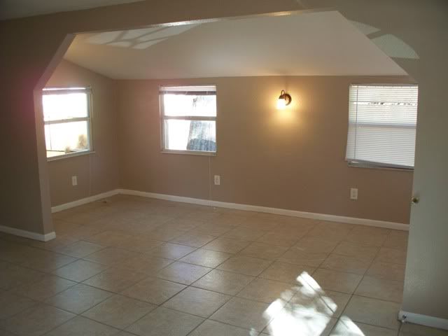

Come on! And you live in Florida, too! Land of ceramic tile! :D
Yep. The new home has just that. Very odd layout too. No problem, I'll solve it at the source ;).
My room is so live that you can hear it breathing. :)
As long as you don't have to pass notes to your friends on a string, you should be ok ;).
Now head for Ikea :)

Nice little bungalow. Looks new. The reflections on ceiling, are they from the front door?
