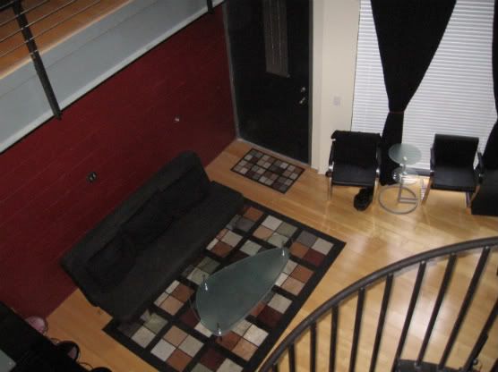

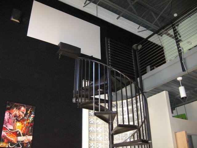

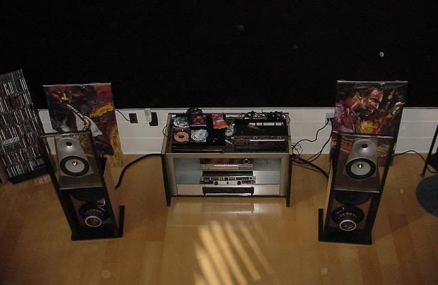

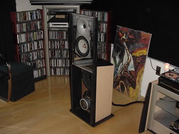

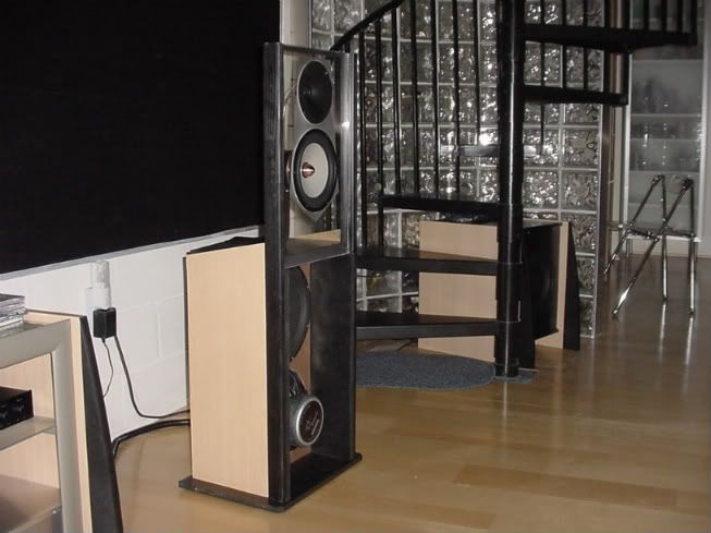

Are those Linkwitz Orion+ speakers?
Those are wood floors (over concrete), painted cinderblock walls, glass block tiles, etc, etc., with rugs, sofa, chairs, blinds, curtains, media holders, etc, etc.
No need to waste energy as heat and have a dead, lifeless, lower clarity and spaciousness soundfield that won't fool anyone...except those computer owning basement dwellers who wouldn't recognize a live violin from a live kazoo (the same people I'll never see at classical or jazz shows).
Oh the acoustic sources?? They were based on the Orions, upon hearing them and analyzing the design, circa early '04.
