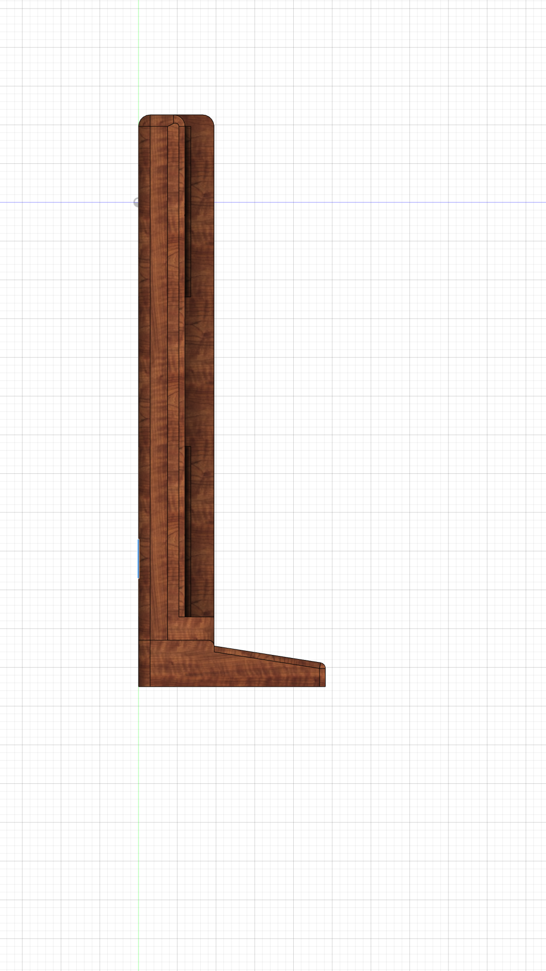

I WAS WONDERING IF ANYONE ON THIS FORUM HAS SOUNDEASY 23 an knows if it can import an obj. or any cad file from autocad
ive got a design id like to if it would make a good quad 3-way open baffle tower
using the design dims an driver specs an a custom xover
baffle dims are for each woofer is a chamber of 13in wide by 13in high by 6in deep with a 1/2in flush cut an a 10in by 10in by 4.5in rear chamber
an the mids an tweeter 1/4in apart
my room dims are 15ft wide by 8ft high by 40ft long
my amp to drive a pair of these is the crown xls 1002 with 2ohm 550watts output per channel
with each of the preposed towers at least 24in from the wall an 13.5ft apart
my preposed custom xover is a fourth order 24db octave 3 way x over at 1500hz / 4800hz with 63hz highpass an take a max of 600watt at 2ohms
an have 200watts at 1ohms (four 4ohms 10in woofers in parallel ) for the lows
200 watts at 4 ohms (two 8 ohms mids in parallel) for the mids
an for the highs 100watts at 8ohms
MY DRIVE SELECTS ARE
1 x visaton-hth-87--professional-constant-directivity-horn-8-ohm
2 X PRV Audio WG275Ph 1" Horn Loaded Midrange 8 Ohm
4 X Goldwood GW-210/4 10" OEM Woofer 4 Ohm
ill be puting a -16db attenuation on the mids an highs to macth the low (id love to find a woofer the has the fq range a qts of the gw-210/4 but with
a 98db efficiency an 10mm plus of Maximum Linear Excursion (Xmax) ) if anyone can suggest one thats under 80$
also
i recently saw a youtube vid about open baffle sub builds an that any sub driver with a qts of .7 or more is a good starting point
so ive been lookin for both 10in woofers an subwoofers that fit that spec for some tower speaker designs
prefurbley with this config
40hz - 1200hz
rms - at least 200watts at 8ohms
xmax of at least 10mm
qts of at least .7 or more
spl of 98db
an under a 100$ that includes shipping an tax
but so far iv found that trying to find very hard
so any help finding would be great
i also try to get a .WRD FILE so i can model the build in winisd
iv also recently considered
Pride Eco 12
an
Power Acoustik GW3-10
neither are 98db eff but the high rms range gives my some wiggle room for gettint to the desired listening level
