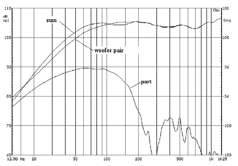

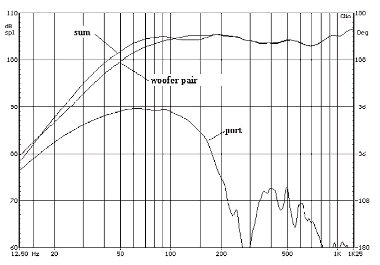

http://www.seas.no/images/stories/diykits/pdfdataheet/thor_measurement.pdf shows the final result of d’Appolito‘s Thor TL. In the very interwsting article linked above he writes: ”The resulting line produces a uniform 3–4dB bass response lift from 110Hz all the way down to 20Hz with less than 1dB ripple.” The effect of the port with the right amount of padding is from the article and shown below.
The design of d’Appolito is from 2002, when there was a lot more about knowledge about how to design a TL speaker.
The design of the housing can be seen using a link on http://www.seas.no/index.php?option=com_content&view=article&id=382:thor-seas-diy-kits&catid=66&Itemid=250 .
TLS Guy, do you have any remarks with regard to d’Appolito’s design of the Thor speaker? Do you know of any other published TL designs that are as good as this one?

I read in other forums that the Thor seem to be a bad design with improper TL tuning and not really good bass response at all, am I wrong here? :rolleyes:
From the frequency response curve, one can only be impressed. Maybe because the port is on the back, it is more critical where you place the Thor. Also see TLS Guy’s remark. Further there is the matter of taste and expectation. If one expects the Thor to be great and to produce a lot of bass...
It is true, that Joe did reduce the line volume Pv somewhat for cosmetic reasons. This probably compromises output a little. However it is a really good sounding speaker.
