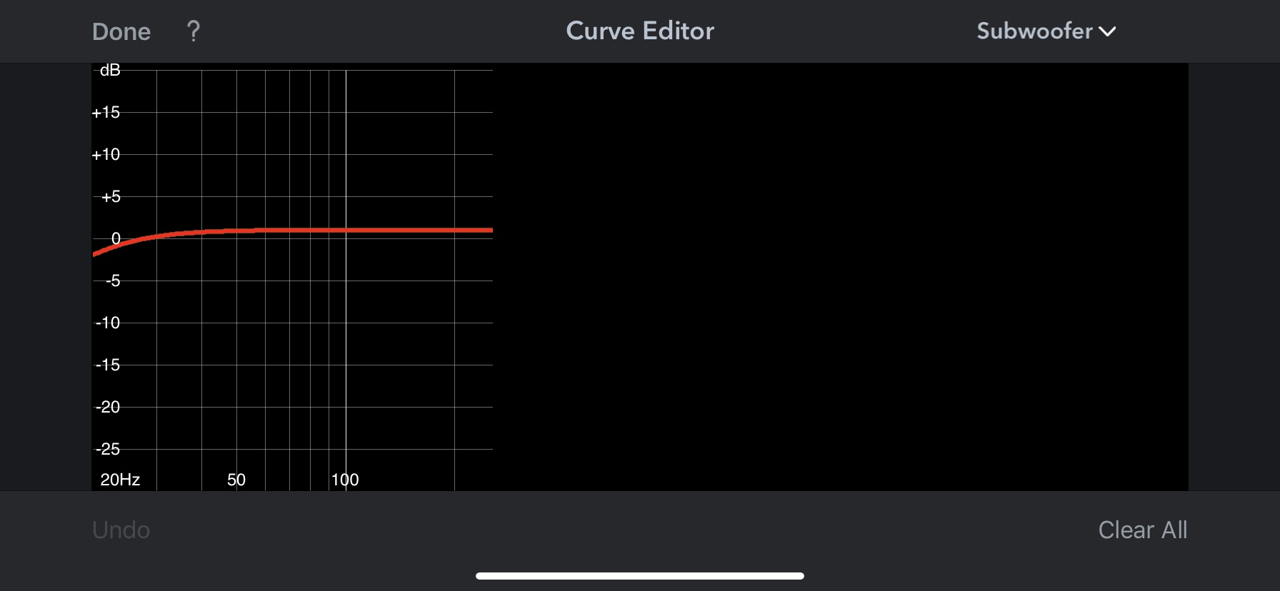

On a side note the MultiEQ App was updated!!! NO MORE 3db ROLL-OFF at 20hz. Sorry for telling but that made my wet Monday good. Cannot wait get home and send the updated results to my Denon.
Wow, two good news in 24 hours! Not doubting you but where did you get that update info from? My App just say last updated April 11, bugs fixed blablabla but not much more than that.
Yep. The members over at AVS said it was released. Will be doing the update and sending as soon as I get home.

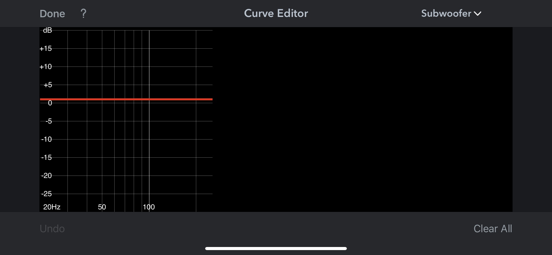

Updated the App, the changes are obvious and it seems more than just a <20 Hz roll off.
These are just the target curves, I am going have to upload the updated curves, and then run REW again to see how the actual results for before and after compares.

So, I just need to update and send to the AVR? No recalibration?
That would be nice!

Yep, I did mine when I got home. I have 2 small dips I’m trying to get rid of. I actually turned DEQ on to test after the update. It actually sounded great.

I noticed a big difference with the update. I tested Dark Night Rises, Saving Private Ryan and Fallout.
I always had a couple of dips after each run, upping the FR/FL XO to 80 or 90 Hz post Audyssey run fixed those, not completely but good enough and better than most posted graphs I have seen.
