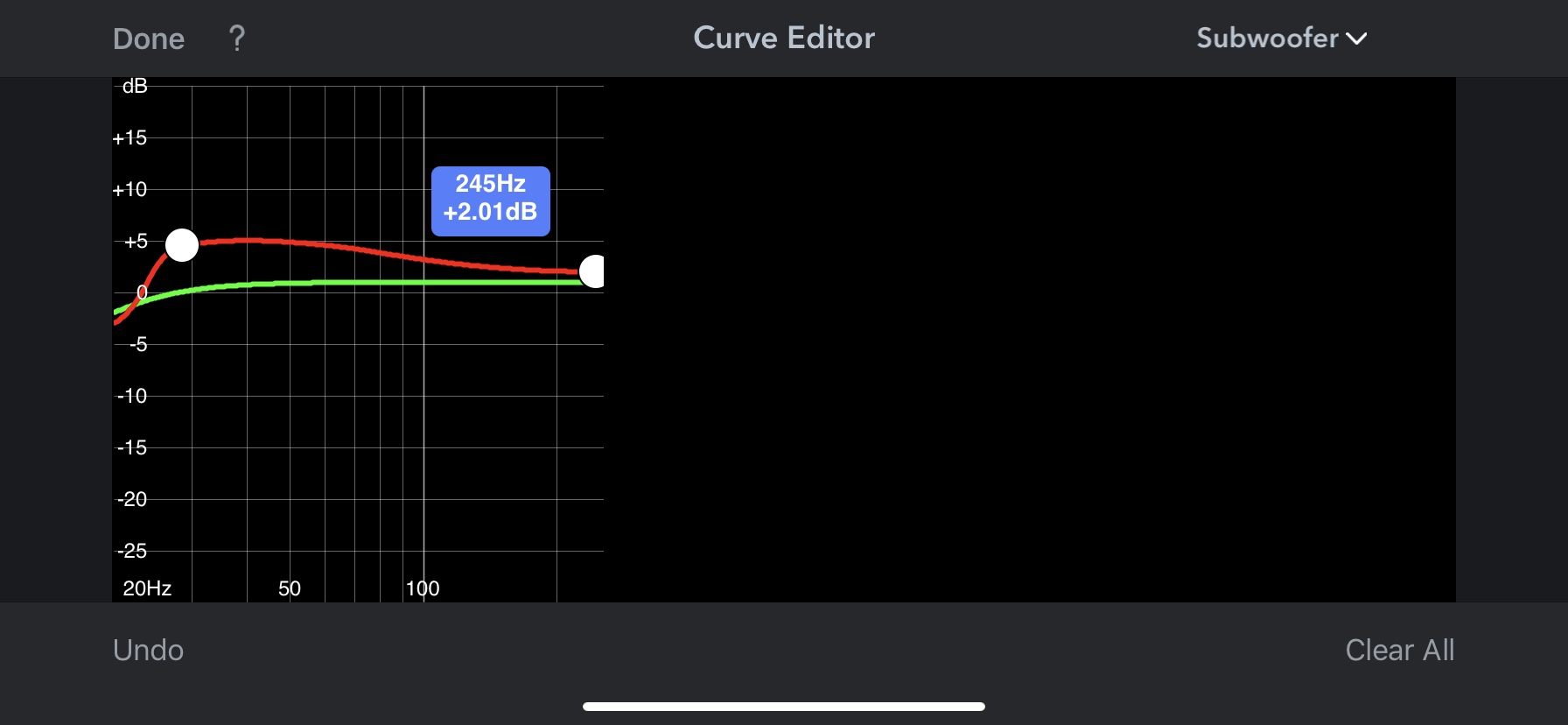

Yeah, most of us bump the subs by anywhere from 2-5db.
In the app though, you can do more of a house curve with the curve editor. Go to the sub, and set a shelf at say 20hz or 25hz and raise it like 3db. See how that works. I believe that’s better than just radiotherapy sub channel since it creates a nice slope.
Pic is just for reference only.
As you can see I selected two points to illustrate a curve. Depending on your subs and listening habitsI would set the low shelf for 20hz and maybe up to 5db. Then it’s like Deq, but all the time!
Thanks, yeah I tried adding a bit of a boost like you did. I’ve since left if Flat, I focussed my efforts on sub placement and it’s worked out in my room. Subs blends perfectly not calling attention to themselves and hit hard when they would.
That was just an example. I actually use my minidsp to set my house curve. Sub placement is definitely rule number one. I can appreciate your feelings as I prefer my bass natural, but I do like my couch to shake when appt too!
