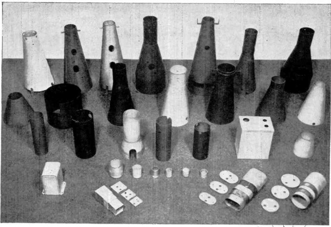

With that setup, electromagnetic interference will be a much higher risk than RF.
The only way he could deal with that is a Mu-Metal shield, which would likely be costly.
The transformer in the charging unit, will emit a significant electromagnetic field.
Exactly (WRT MuMetal), but shielded transformers do exist, so they could be used.
I used MuMetal for shielding in some car audio systems- awfully sharp, but when used correctly, it did work.
First that I've heard of it. Interesting.
If you ever need to use it, be sure to protect yourself- it's insanely sharp and very stiff.for its thickness. It's easy to solder a ground wire onto it, fortunately.
