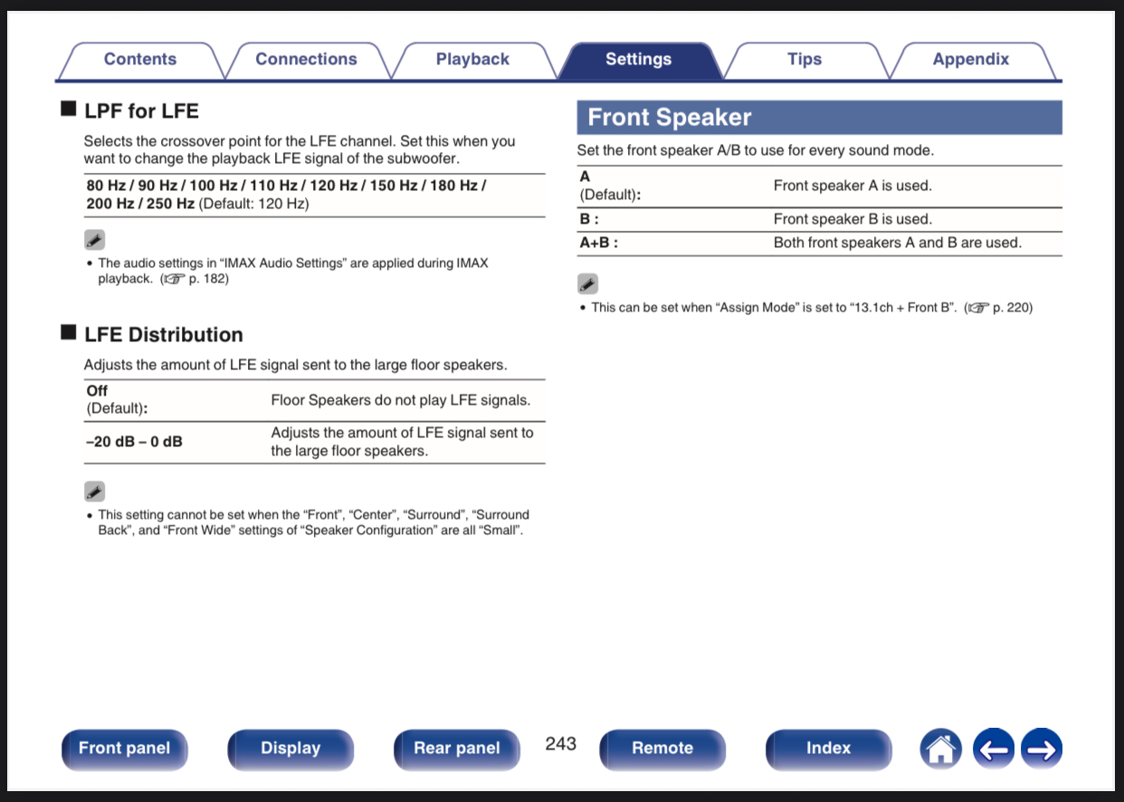

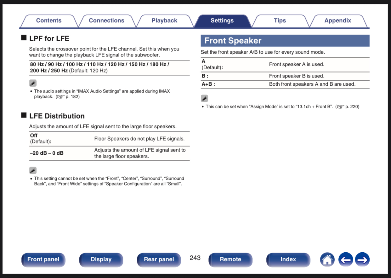

I would be interested to know if you have used the LFE Distribution feature at all since your speakers are Large.

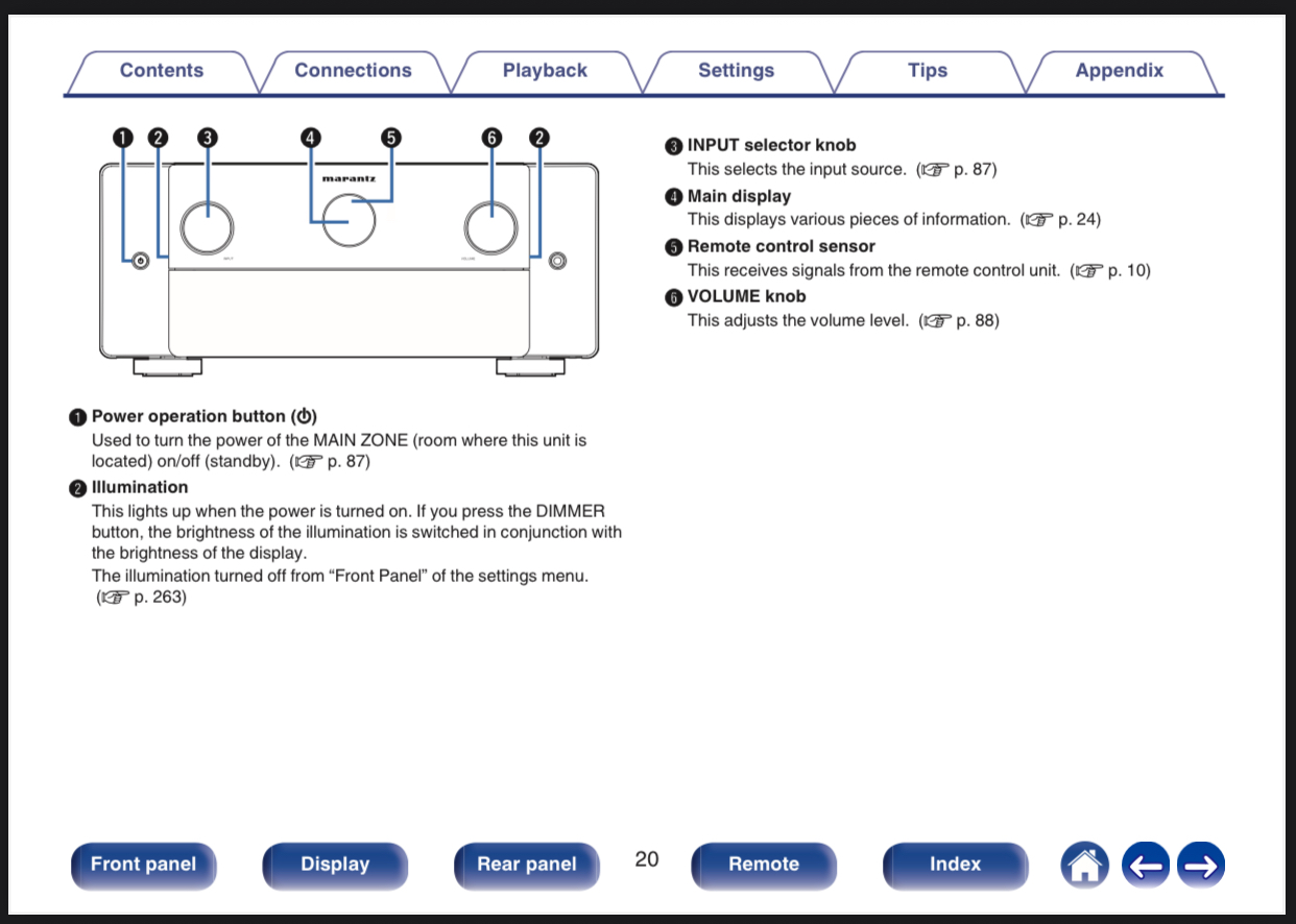

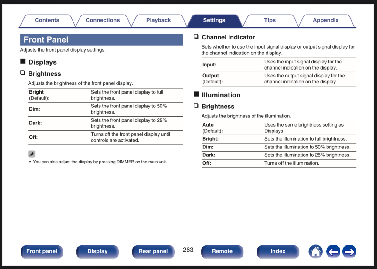

Oh, you can turn OFF the illumination feature if you find it offensive.
...unless you changed you mind and believe Dirac Live ART and Trinnov's RC systems will take things to a different level.;)
Only in heaven. Just not here on earth. :D
gene
gene
Audioholics Master Chief
Administrator
Trebdp83
I got that feature added to all new Marantz and Denon 4sub enabled products :)
Yup, and those using speakers set to Large wanting some LFE sent to them owe you one. I don't think those using older models realize that when assigning a sub for use, no LFE was being sent to any Large speakers and only the low frequencies actually in those channels were being sent to a sub when speakers were set to Large and the sub was set to LFE+Main. That setting does nothing for getting LFE to Large speakers and the new LFE Distribution feature is needed to do so.

Just in case you didn't see it, I found this in General, Front Panel- maybe it will help with the lights being too bright.

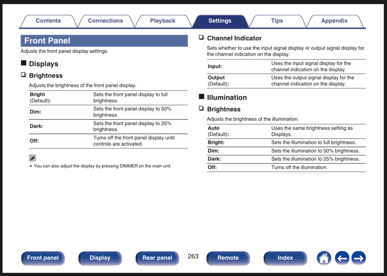

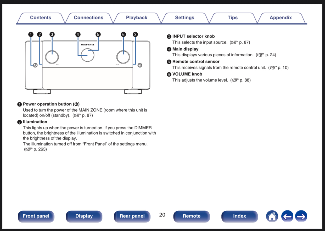

I have it that way. If I am wrong about this correct me Gene, but I set all the bed layer speakers to large, and only the ceiling speakers are crossed iver, and I checked the LFE + main option.
On my previous units you set a speaker to large and had the option to check LFE + main for each speaker. So rightly, or wrongly I assumed the end result was the same and just saved a few steps. As far as I can tell the measurements are the same.
I will try it, and see what happens. However, I need to see the LED panel from my chair when the window blinds are up in the day time, when I don't have the screen on.
