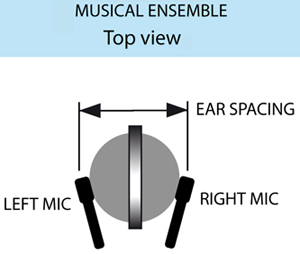

I think you are correct. That is why I think intensity techniques produce a much better sound stage than phase difference techniques. The problem is that omni microphones as a group tend to have a smoother frequency response than microphones with directionality. For an intensity microphone technique you need mic capsules with directionality.
If you take two omni mics and space them (commonly done), what you really have is two mono sources. So if you put two spaced omni mics in front of a piano, you have two mono sources of pretty much the same amplitude. The only difference is phase, and I don't think that is an ideal fit for human hearing localization.
I'm really sensitive to phase problems and it's not just low frequencies. Some speakers are just plain hard for me to listen to and it's not a comfortable feeling. I know someone with a small recording studio and he asked if I was able to borrow the RTA from work because he was having a problem with his mixing, but couldn't identify it. Before we set the mic up, he played something and I told him that he had something out of phase and I asked if he had recently replaced a horn driver. He had replaced one but he didn't do it himself and the other guy didn't think it would be a problem. The RTA showed a deep V at the crossover frequency and this was over 20 years ago, when a good RTA was a lot harder to come by at a reasonable price.
Highly directional mics are great for close-mic-ing but never for capturing the sound in a room. I recorded the band some friends were in and it sounded very real, but the room was terrible, acoustically. That's the only reason it sounded real- the side reflections weren't attenuated much, if at all. With headphones, the sense of space made it very much like the room that night, especially if I closed my eyes. As far as I know, it was one of the first digital recordings done here- the store where I worked sold the Sony PCM-F1 and I did this within a week of us getting it. I also had a customer who recorded Classical and Jazz performances, using Studer recorders and Schoeps mics.
I don't like directional microphones unless you can open the back. The old STC microphone that is now the Coles 4083 is a fantastic microphone. That microphone has been virtually unchanged in over half a century!
I think a figure of 8 microphone works very well in a big space with good acoustics. If I use omnis, I usually adopt the baffled omni technique.
