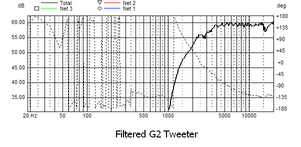

Dennis Murphy asked me if I would post this for him as he had trouble getting these figures to attach. His text:
I would agree that particular waterfall (published by the G2 manufacturer) doesn't tell you much. But while we're posting plots, I thought I would show what the unfiltered response of the G2 looks like in the HT3 cabinet, and then what a little crossover filtering does. (I don't have anything else to do today -- 25" inches of snow out there).
I think you can see from the unfiltered plot that the gently rising top end response is the least of your problems. That huge dip and peak at the bottom end will show up in some form with just about any tweeter, dome or ribbon. It's caused by diffraction effects from sound waves <#> hitting the sides of the baffle and then reflecting back to cancel or reinforce waves that are just emerging. The little notch at 15 kHz is probably inherent in the G2, since you can also see it in the waterfall plot. But at that frequency, it's more a concern for musically gifted Golden Retrievers.​
When comparing these two frequency response curves, please note that they have different vertical axes. The unfiltered tweeter is about 15 dB louder than the filtered response. This was intentional, to more closely match the tweeter output to that of the midrange (not shown).

Thanks Richard. I really did have to pad the G2 down that much to get it in line with the rest of the speaker. The woofer set the maximum sensitivity. It's pretty much impossible to get bass extension down to 29Hz in that size cabinet without a massive sacrifice in sensitivity. But that's what amplifiers are for.
