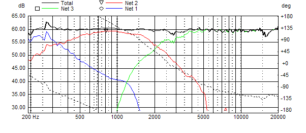

I see after filtering the G2 is rolling off at 4 kHz.
This is the unfiltered response of the SEAS Exel W 18.
The sudden 4.4 kHz break up mode is what makes this a difficult driver to use, and a notch filter mandatory.
Now the 3db down point of your filtered G2 is 3 kHz. Now that is the start of the base of the large magnitude 4.4 kHz peak of the SEAS driver. Added to which you have a huge peak in the tweeter response centered on 1.5 kHz.
So it seems to me the lower frequency of the base of your notch filter is right at your crossover point. Added to which you have the tweeter peak, not owned up to in the manufacturer's specification, to deal with.
This gives rise to a concern that what was bothering me might not actually have been entirely due to the ribbon, but related to the break up mode of the Exel driver also
I hate to ask you to divulge proprietary secrets, but this has got me downright curious, as I would be highly reluctant to work with that set of circumstances to say the least. So you are a brave man. I would have declared that unpromising and moved on.
This is what makes speakers so interesting, as your set of decisions seems, at first glance, to be very different from mine, when using that SEAS driver. But may be not.
I have composite fourth order slopes centered on 2.5 kHz. The SEAS W 18s have a second order electrical slope transitioning to third. Actually roll off truly starts first order at around 400 Hz before the rising woofer response. There is a notch filter centered on 4.4 kHz. The tweeter slopes are third order electrical transitioning to second. This makes a fourth order crossover centered at around 2.5 kHz when combined with driver roll offs. I'm helped by the fact that the tweeters acoustic roll off does not start until 2 kHz.
The rest of the crossovers in my speakers are active. The lower 10" SEAS is cut rolls off second order electrical above 80 Hz. The upper 10" driver has its response extended to provide the step response compensation. The dual lines are tuned half an octave apart, which was a trick I leaned from John Wright. So my SEAS drivers have an entirely acoustic roll off on the bottom end.
Anyhow I'm glad I have myself to please. I think to be truly happy with a speaker, you have to design it yourself, to avoid the speaker ills that really bug you and provide the sort of sound stage that is to your liking.
