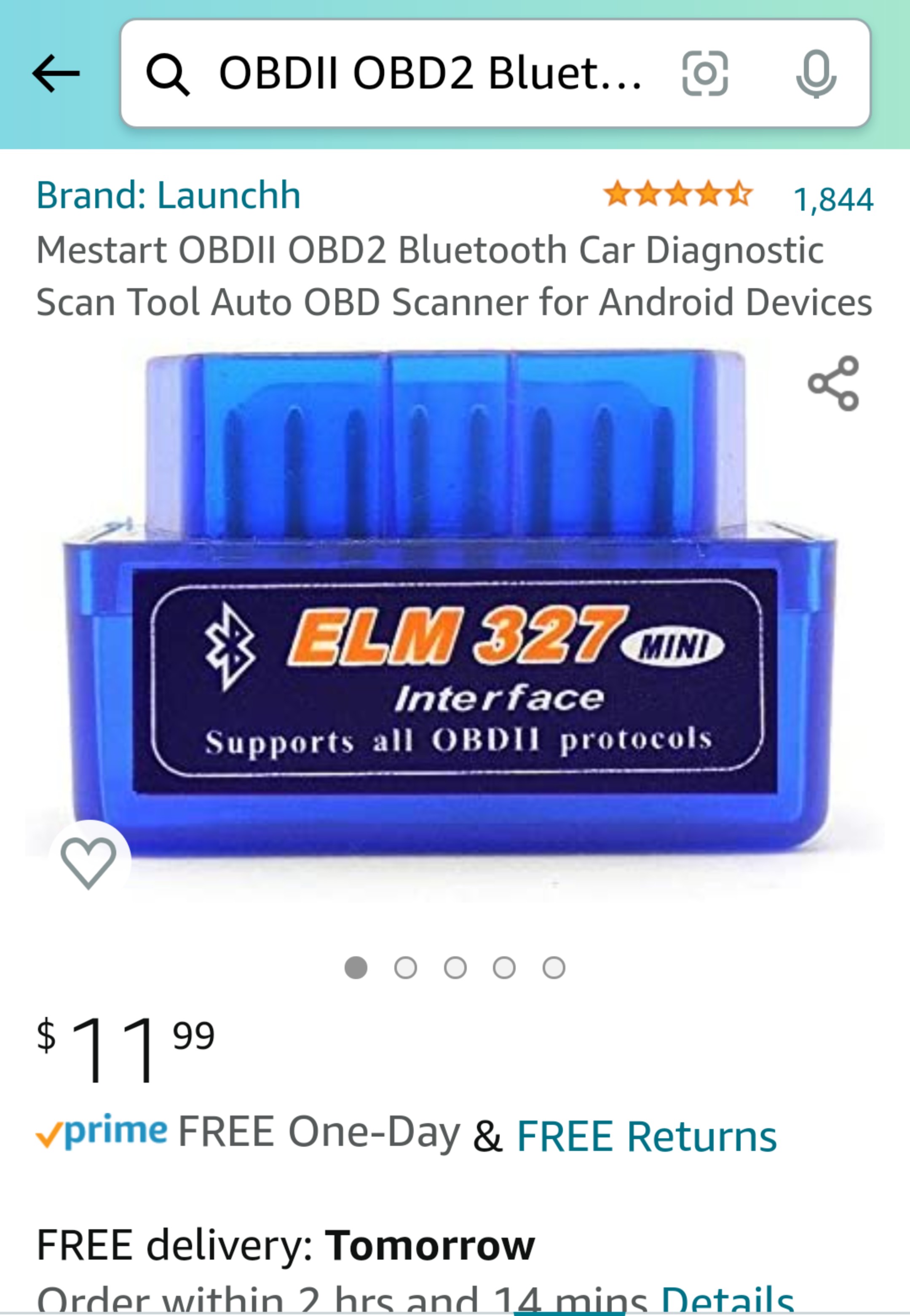

BoredSysAdmin
BoredSysAdmin
He had no code reader, but checked what he could without it. Damn dunno what to do.
btw: OBD2 scanner doesn't have to be expensive:
you'd need two parts:
a) OBD2/BT dongle like this one:https://www.amazon.com/obdator-Bluetooth-Scanner-Automotive-Diagnostic/dp/B074DWH8JR/ref=sr_1_5?dchild=1&keywords=elm327+bluetooth+obd2&qid=1631468144&sr=8-5

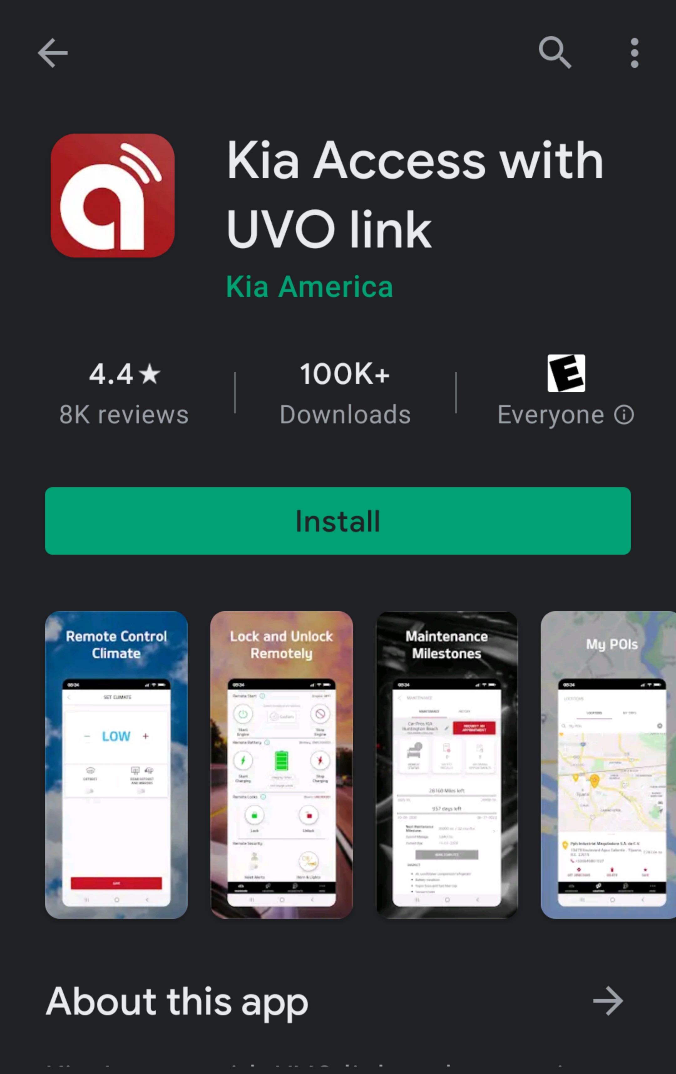

b) OBD2 tool for smartphones like this one (ios shown, but plenty of them for android as well)
