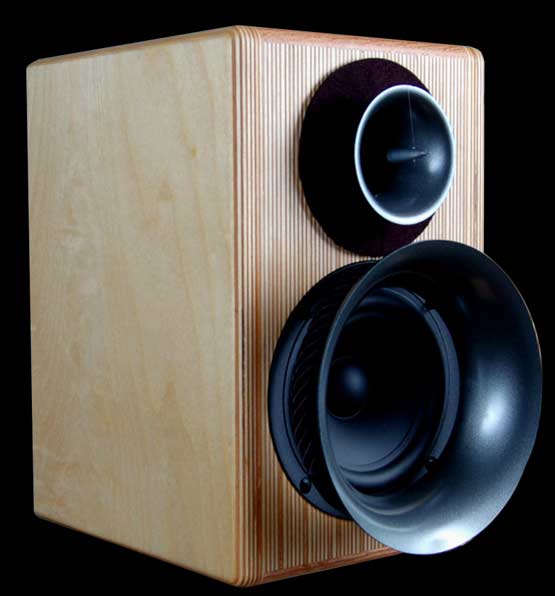

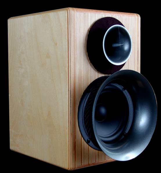

When I think of whizzer cone speakers I always think of Wavetouch Audio speakers

When I think of whizzer cone speakers I always think of Wavetouch Audio speakers View attachment 19705
LovintheHD:
There is a punchline in that sentence about whizzer cones somewhere. I just can't come up with it. I think I will stay with the nano-sanctification as the key takeaway from Zu Audio. Those are two hyphenated words I just don't recall ever seeing together. It sounds like a topic for a Gene video.
LovintheHD:
Nano sanctification is hard to beat. The technology page for Wavetouch doesn't have anything quite that good on it http://www.wavetouchaudio.com/tech.html
