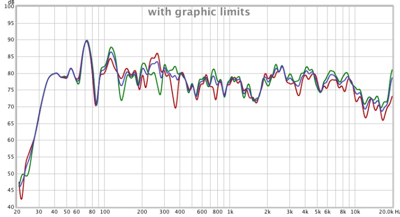

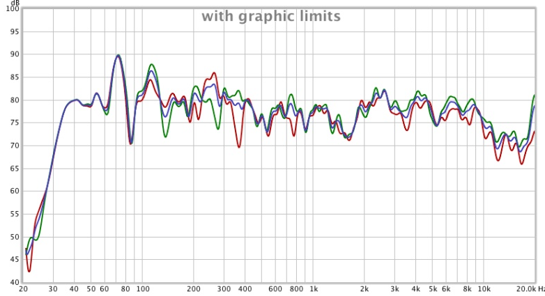

I took the corrective actions you suggested and the graph begins to tell a much clearer story for sure.
I have it attached. The data file is pretty porky so I can't attach it here. I will have to see if I can get it up on Box or Google docs or some place I can point a URL to. But, here is the corrected graph and it has some interesting things to say. Thank you for being willing to take a look and see what I can learn.

That response isn't bad for an in-room response. The ragged low end is expected, and you would benefit from some EQing there. The dip at 90 Hz may mean the subwoofer is not fully in phase with the speakers. I would guess that the dip at 1.6 kHz would be due to the angle you are listening to the speakers at, and is probably due to some slight cancellation effect of the woofer and tweeter overlapping each other, since the crossover is at the same area (1,500 Hz). This can also be seen on this graph, where the purple trace is the RB-62 IIs. Some of the character of that measurement can be seen in your measurement.
Anyway, I do think you could benefit from a more neutral speaker. A speaker with a flat response could shore up the dips at 500 Hz and 1500 Hz, and these are pretty crucial frequency ranges. I think you should get something to trim that peak at 70 Hz. If you do that, you will have a very good subwoofer response for a single sub in a small room. It doesn't dig deep, but upper 30's Hz response should cover almost all conventional music recordings. I wouldn't bother adding another sub, as long as you get the speaker in synch with the sub to shore up that dip at 90 Hz.
It will not take $3k to fix these problems, although that is a nice healthy budget.

I looked at the Mdat file. It is telling the same story as your graph. Thanks for sharing. When I advise people to measure their setup, they mostly just brush that suggestion off, but it can't be known for sure what is happening and areas for improvement until these measurements are made. You have done this, and you know how you can benefit, so it's nice to see someone who is seriously looking to improve their sound instead of just looking for an excuse to buy a shinier speaker. I tip my hat to you, sir!

Thanks so much for taking some of your time to look at the data and give me some pointers on what my room is doing. When I first started this thread, I was just interested in speaker size for a purchase: stick with bookshelves or could my room handle a floor standing speaker. Now, I am intrigued by the challenge of what I may be able to accomplish by taking actions with the existing setup.
Woofer/speaker mesh point was the one thing I could see in the graph that looked pretty rough. My Klipsch subwoofer has phase adjustments, loudness adjustments, and I believe the crossover point is adjustable. Is there a pattern to follow for those adjustments, or is it just easter egging them? I can tell you anecdotally that there is a discernable peak in bass response with some music. Many choices are not affected at all, but there are some that its noticably too much. I can graphically see why that might be the case. Now, I would like to see if I could fix it. Its now a challenge!
At the other end of the spectrum, I find it interesting there is a drop out at 1500hz. I have always considered the Klipsch speakers to be too bright. And the way I have the Audessy adjusted, I have the high end tuned down as much as it will let me. And the speakers are still able to tire me out and are a little too much at the high end with some material. I would probably not find more punch in higher range enjoyable.
Another anecdote: I visited a high end music shop in Scottsdale Arizona a few months ago. Their view of cheap speakers was $10,000. They had 2 setups over $500,000 onsite (the whole system, not just the speakers). What made the visit interesting (besides the incredibly over the top prices) was their take on measuring and understanding your room. The advisor there told me not to waste my money on buying speakers until I understood my rooms affect on the total system. In fact, he would only sell most of their products by including on site service hours to do a complete workup of the room. He said spending serious dollars on speakers is largely a crapshoot if you don't measure and understand where they will live and perform.
This exercise is giving me a little intro and some insight. Now I'd like to know how to do EQ. I honestly don't have a clue how to EQ a system. I should know. But I don't. I have seen references to generating EQ files from REW and then applying them to your system. Again, I have no idea how to do that. Insight?
I have enjoyed the process in this thread. I would like to learn the next steps

The next step is to set the sub in phase with the speakers. Your sub has a continuously adjustable phase. Assuming it is set to zero right now, set it at 180 degrees and measure the response. If there is still a dip at the crossover frequency between the sub and speakers, try different phase settings until that dip is gone.
After that, you should get an EQ system for the bass. This is one of the few things automated room correction is good for. You can get something like Audyssey, or something manual like miniDSP. MiniDSP is the most surefire route to getting a good response, but, of course, it takes more effort. Here is an application sheet on how to use miniDSP is EQ your bass. I haven't used minDSP myself, but there are lots of good tutorials out there, and it looks easy enough.
It also sounds like you will need better speakers. I would encourage you to get speakers that have a flat response and uniform dispersion. I would get bookshelf speakers. Some brands to look at which can fit these qualities: Revel, Philharmonic, Salk, JBL Pro (especially the LSR 7 series), Genelec, KEF. Some other speakers that look interesting: Emotiva Stealth 8s and Hsu CCB-8s.

Interesting process. Part of me wasn't as dumb as I thought when I set the system up apparently. I can make the bass bump and dip worse with adjustments, but I can make it no better. That tells me the settings I ended up with were the optimal ones (although certainly not perfect). By adjusting phase, crossover frequency, loudness and positioning, I can make the bumps/humps worse than my initial measurement settings, but I can not close either problem area. I can live with that because my initial reason for getting in to this discussion was to use the information learned to help me buy a better set of speakers. Short of buying a MiniDSP, I can't really do much more to affect the sound with what I have installed.
Its not clear to me that the MiniDSP would be able to mask the bass problem because its the subwoofer itself that's producing that waveform not the receiver. It may be able to, but I may take the cost of the MiniDSP and apply it to the new speakers. Perhaps even do away with the subwoofer entirely.

It's not the subwoofer that is causing the problem in bass- it is far more likely the room. It is frequency where the wavelength is overlapping itself in that small room thereby causing a summation and cancellation. I wouldn't be so quick to toss the sub. All you need to do is bring down that peak. Any parametric equalizer will be up to the task. Audyssey would probably do the job just fine, to be honest. As for the dip, or cancellation, the only way to deal with that is either to move the sub to another position (which will more than likely just shift the frequency the problem is occurring at), move the listening position, or get another subwoofer that fills in that null. Adding another sub is the best solution, in addition to EQing down the peaks.
Another thing you might try to iron out the bass response is to lower the crossover point of speakers to the subwoofer. Try a 60 Hz crossover and see how that affects the response.

That makes sense to me. I was wondering at what point in this conversation the actual room and the problem of standing waves would come up. It was my chief fear about the room when I read about room size as a major factor in the sound of a system. So far, I haven't seen major issues. If this is the first and most troublesome issue (the bass hump/bump) I will face with this room, I'm a happy man because although it looks ugly on the graph, there are solutions. Additionally, the system sounds pretty good to me.
I may yet try the miniDSP and an EQ effort to see if I can remediate the response and get it flatter across the spectrum. I tried moving the sub when I set it up. There were lots of worse locations for how it sounded, but none better than where it is. Its located on the left wall , about a foot front the front corner.
Your suggestion of a second sub and EQing down the peaks is solid advice. I have a second Klipsch sub that matches the one I am using. Unfortunately, the bash amp in it is ailing. The estimated cost of fixing it is halfway to the cost of a new SVS sub. I think I would opt for the SVS sub instead of fixing the Klipsch.
I did play with the crossover frequency on the sub. No visible result on the graph. I did not play with the crossover frequency inside the receiver. I guess I could try that. If its the room, it will stay the same but it is a variable I did not try just yet. Thanks again for the insights and thoughts. very, very informative and helpful
