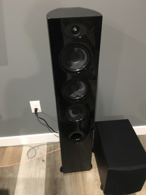

This definitive sub looks like the soundstage one I returned lol

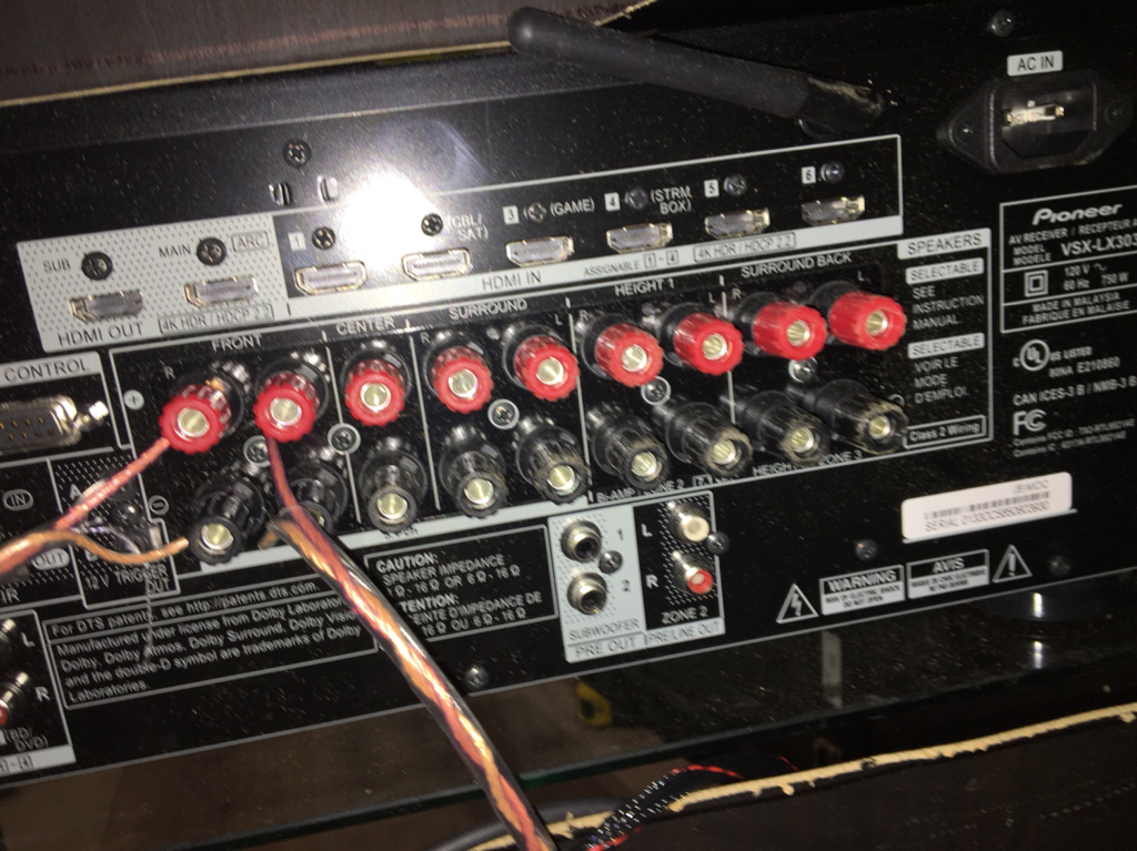

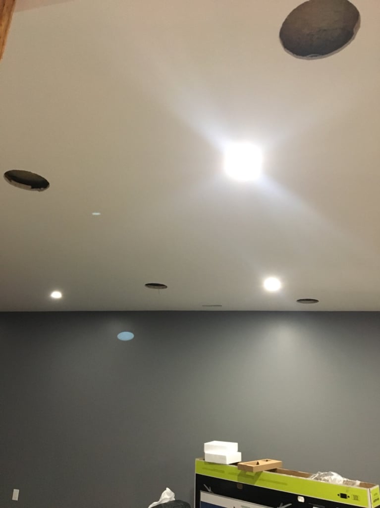

Which outputs do I connect the ceiling speakers on. Since they are heights but are replacing the side surrounds And the other 2 are back surrounds?
So would the middle pair be heights and the back pair be back surrounds?
Also I’ve read there’s no point hooking up the rear firing speaker that’s in my loud speakers.
The ones replacing the side surrounds would go to the “surround” L/R terminals, and as you said the rears would go the the “rear surround” terminals. None of them will be used as heights despite being in the ceiling. If you wired them as such you’d have unsatisfying surround performance.

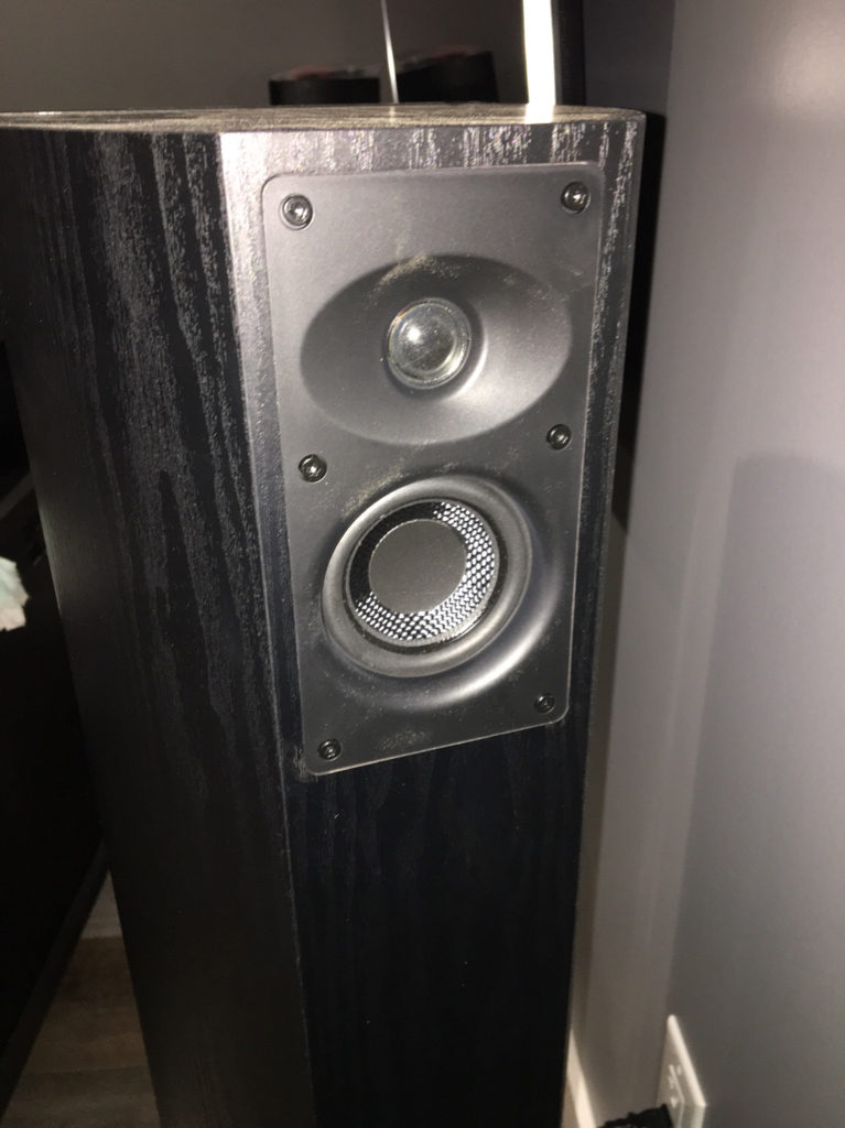

Ok I will wire them like this. The loudspeakers are soundstage signature think I quoted model earlier in a post.
William Lemmerhirt
William Lemmerhirt
I guess if you wanted to try it you might sad well. I’m not a fan of bipolar speakers but many people are. They’ll take some futzing around with placement to get right. Curious what you find out wether you like or not.

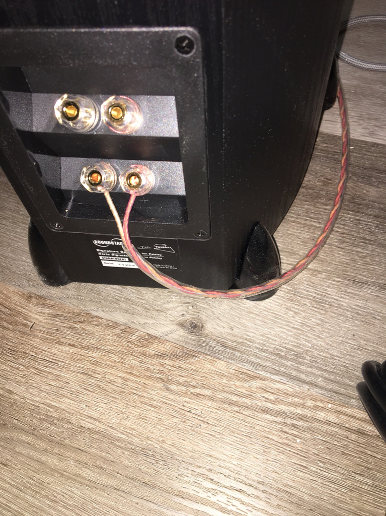

I can give them a try after initial setup. I think this receiver uses a mic to detect speaker placement.
I will see what I think and then maybe attach the brass jumpers and see. But I would expect a bit of sound delay. I don’t think my receiver would fire these off another channel unless they owuld now be considered heights.

Taking a guess but I think you could Biwire them.

Biwire? That would just be using the supplied jumpers?

Actually depending on your avr(sorry can’t remember which one) you can run a second set of speaker cables to the second terminals. But, since you’re going 7.2 you might have the extra channels to do it. Also, I wouldn’t ordinarily recommend “buy wiring” but they’re bipolar. Not that it would sound different but just because you could. I would just try the jumpers.

It’s a pioneer vsx -lx303. 9.2 and atmos capable.
Just gonna put transformer on here with the boy and for some reason it shows the 7 speakers but not the sw on the display and I have no sound from the subs. Yet the mcacc used them to adjust everything in initial setup.
What sound mode? Is it in direct or something? Should be multichannel or something iirc. I have a pioneer in my bedroom....
Try the “surround” button.

Ya I’ve been switching between surrounds and it won’t show the symbol. This thing can with no manual for some reason.
Have it in Dolby digital surround right now. No sub noise. But in menu I can send sound to the subs
