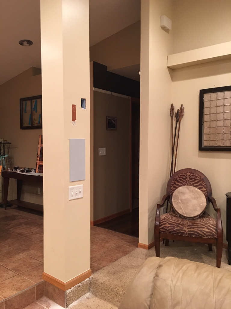

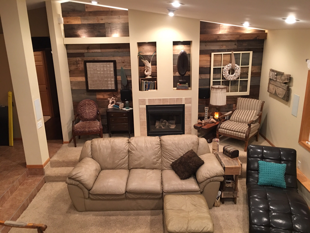

This is exactly what I was thinking. To my wife’s chagrin, we have a column built specifically for holding my right side surround(and 3 light switches). Works great. Only thing is, how far back from your LP(listening position) is it.
this is an older pic before I went to an in wall side surround as part of my Atmos negotiations LOL!
Here’s now. Under construction.

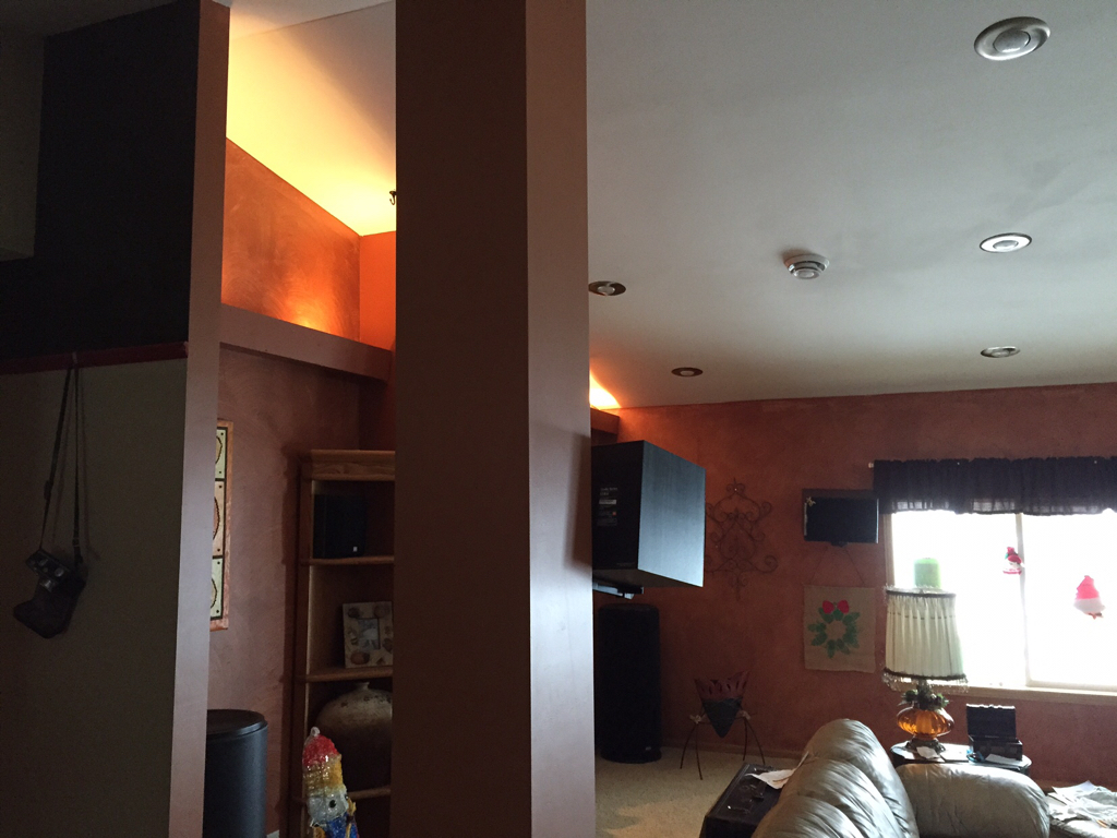

Attached is a photo of placement. Couch is approx. I might put a sectional in there or whatever. That being said with the small kids I don’t know if I’ll ever have an awesome setup that I can use. Not until their older.
I don’t want to build the columns out. They are oversized tsl columns I paid big money for to finish exposed. I love the look of them. Had it been I was going to trim them out I would most likely go that direction. There is a bulkhead above them to hide the beam but the wife is against hanging a bookshelf off it. And prob isn’t much point of framing a wall of can’t et an in wall on the left.
