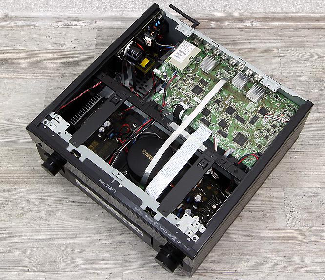

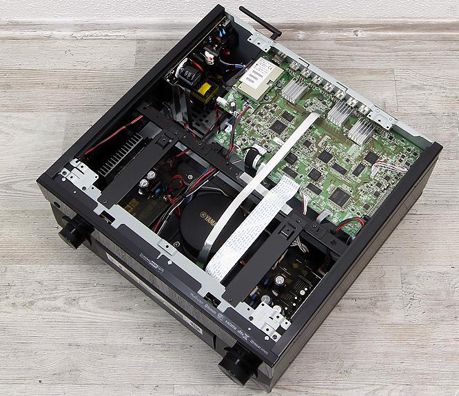

I hope so too, but I bet chances are good that it won't be much better. It still packs 11 channel of processing/amplification(preamp) in the rear half of the box. The main difference is in the front half (roughly),the AVR has a bigger transformer and heat sinks. So if you can manage the heat with an external fan, I would argue that the AVR suffers insignificant, if any disadvantages compared to the AVP.
IMO, the "jammed pack" related issue is not solved by going with separate AVP and Power amp because the power amp side of AVRs are relatively simple, and much more trouble free if well cooled/ventilated. The separate way has the advantage that if it failed, you only have to replace it with another AVP, but then most AVP still cost more than comparable AVRs cost, that's why instead of going with a cheaper prepro, I decided to go with a more affordable AVR and use it as prepro. Of course, ymmv.., I have tried 2 prepros already, both trouble free one is approaching the 8 year mark so I am just being proactive.
RX-A3070
CX-A5100
I assume the big board on top is the HDMI board. I would like to know how many circuit boards does it have? Hopefully nowhere near as many boards as the AVP-A1. :eek:
One quick thing I noticed was that the CX-A5100 operates about 200% cooler :D than the AVP-A1 and any Denon AVR I've ever seen.
The CX-A5100 chassis temp is similar to the ATI AT2005 amp.
The CX-A5200 (I assume that's the official name) should be coming out this Nov-Dec. Hopefully it doesn't have 13.2 CH like the Denon 8500 and doesn't have SIX sets of RCA, 4 sets of Component, 2 Coax, 2 Optical connectors, and the kitchen sink like the 8500.
