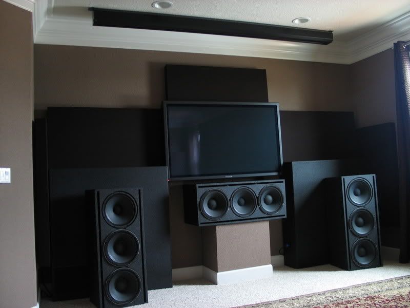

hey rmk, after briefly mulling over your latest photo, methinks that a false wall + AT auto masking system would be awesome. Expensive on one hand for the auto masking, but I think you might actually be done for a long while!! :eek:
The problem is how big the screen needs to be. Because the bar on the bottom of screen, or anything that is not AT, that falls in the way of any drivers is no good, obviously.
So, if its AT, its going to fall below the entire center speaker, but most likely fit in between the mains. If the full screen falls flush to the top of the center speaker, you don't even need AT, which has its own benefits I suppose.
I've never owned a flat panel, but if the plasma didn't have to be quite as recessed, IOW pulled out a bit, I think it can look pretty good in some "shadow-box/false wall" scenario.
Whaddya think?
Ok, after second look, I say AT that falls beneath the center speaker. For if you have auto masking, you can basically have any darn size, for any AR, at any damn time you please. Therefore, might as well have giganormous-mode available at any time you wish.
Basically a screen big enough, mounted just low enough, where it can simultaneously fall beneath entire center, but stay between mains.
I admit I am talking above my head. :eek: But I like my idea. :D

You have been thinking ... haven't you:p;)
I have run through all of the scenarios you described and I am even kicking around some really crazy ideas but nothing solid yet. I do appreciate your comments and suggestions. It looks like the Plasma is history unless I stand pat (that'll never happen:p) or just go to a larger 120" or so 2.35:1 Powered tensioned as that would drop to just above the LCR's so no AT needed. That way I get to keep the Plasma but the speakers/subs remain visible.

There just is no easy way to get to true CIH (2.35:1,1.78:1) fully automated AT masking without spending large cash. Even DIY done right is problematic. I had a shot at a full ISCO lens/sled and Draper dual masking screen for a great price but it was not AT. There are so many sync issues with trigger/remote activation of these devices that it makes my head hurt.
Since there is no clear path to what I want without spending at least $20K (and that is a low side estimate) I think I will hold off for a bit. I appreciate all the suggestions and will continue to investigate although at a less arduous pace;).

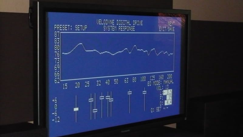

I moved the SPUD's exit port outboard to the wall corners per suggestions from Tom Danley and others. What a difference a little corner loading makes:eek:!. With that simple change, I now have much more <20hz output as well as a nice gain across all frequencies. The tactile is at a perfect level and the systems sounds the best it ever has.
Here is a FR from the SMS-1:

Glad to see someone actually doing their homework. The frequency response really does look pretty good across the board.
Congratulations!

Thanks Westcott, I could have used the slider to tame that little bump at 22hz but that is an area where a little extra oomph is kinda nice. Overall it is sounding just fine.:D
