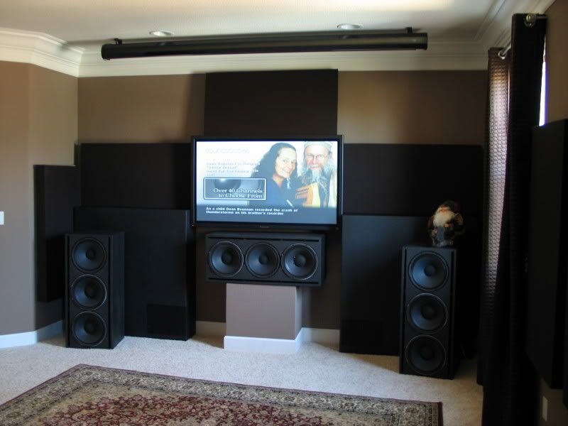

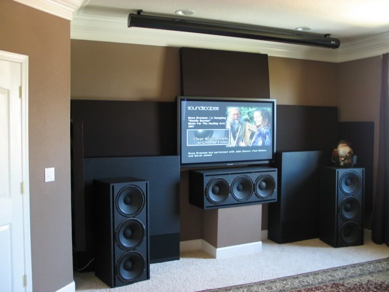

Testosterone Theater
Here's the "new look" Front Soundstage. I also posted these pics in the TH-SPUD Subwoofer thread so my apologies to the Mods for the dual post.
The dual TH-SPUDS are unlike any sub(s) I have heard. Incredibly dynamic and clean but they don’t go much below 20hz. I think the trade off is well worth it but that’s just my opinion (and you know what they say about opinions:p;)).

Very very nice. Aesthetically, I prefered the look of your other speakers, but I wish I could hear this setup.

RMK,
I am curious if yu have a link to the mains that may detail their operation. I do not see any mid-range drivers, planar units, or tweeters? Just curious.

RMK,

Thanks,
Here is a link to JTR and a quote from Mark Seaton regarding the Triple 12LF's
The Triple12LF's do use a coaxial midrange. The dust-cap on the coax' is a rigid cloth, allowing high frequencies to come through the center of the 12" cone. Larger diameter drivers have two major hurdles in crossing to a tweeter. The first is placement, as the size typically requires large spacing between the mid and tweeter, which makes smooth off axis response difficult. The other problem is high frequency extension. Some 10-15" drivers are well behaved past 3kHz, but that would be the exception rather than the norm, so you need a tweeter capable of crossing lower than most.
The coaxial design entirely gets around the issue of spacing, as the concentric location of the tweeter is as ideal as it gets so far as spacing. This sort of coaxial design has the tweeter enter through the pole piece of the midrange driver. The metal is shaped to mate with the profile of the cone. The cone then serves as a shallow waveguide/horn/lens for the tweeter. A 1" exit compression driver can be very powerful when on a larger diameter waveguide. The 1-3kHz range is in fact the most powerful for such drivers mounted to a coaxial driver like this. This allows a crossover below 2kHz where we get good integration both on and off axis.
The 12" coaxial driver is used such that it won't produce much output below 200-250Hz. This range is very easy for the 12" cone to produce, and up to very high levels, the midrange motor always stays linear, even with big bass events which are handled by the woofers, keeping dialog and other midrange details clear.

How do they compare to ther speakers you have used in the past? I assume they are quite dynamic.
Dynamic? Yes … amazingly so:eek:. If fact my audio system has never sounded this good before and the only changes that were made from my Revel Ultima setup has been the JTR"s and Danley subs. The Revels were wonderful very detailed speakers but they sounded strained when trying to deal with the full dynamic range of HT or certain Rock and Roll recordings. The louder I played them the worse they sounded. The JTR Danley combo can play very cleanly to well beyond volumes I can tolerate and yet are very detailed in their own right.
As I have stated many times, the JTR"S are an aesthetic compromise but for me and my use/taste they are perfect.

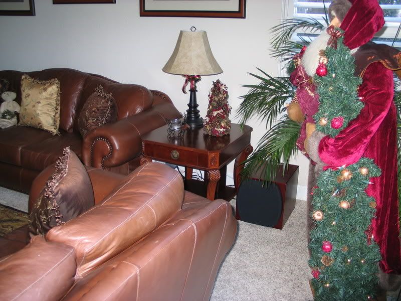

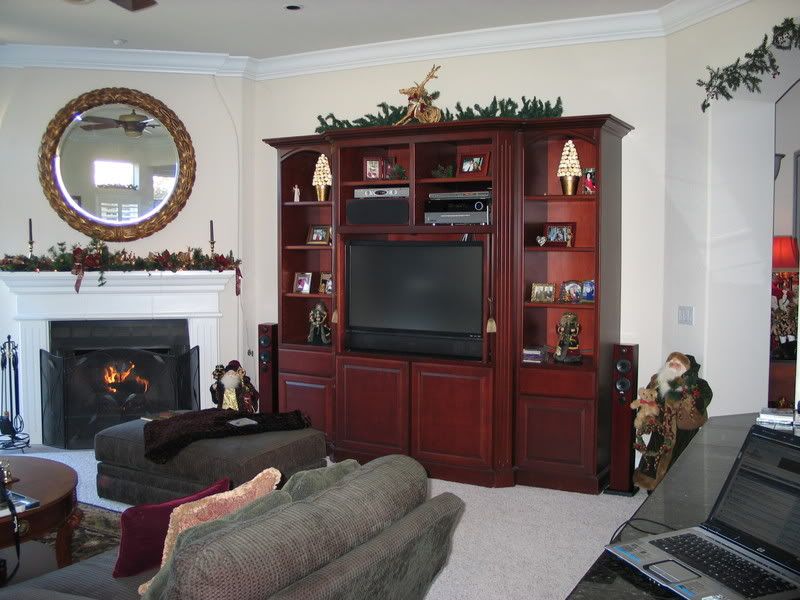

Family Room System
The SO was complaining about the lack of SQ in the family room system. It had been gutted after the HT room was built last year and at first she didn’t want ANY audio equipment in there.;):cool:
I have always been a fan of Monitor Audio so I picked up these components for a song (relatively speaking) and it now sounds great. Tough large open space to fill and the speaker placement is less than ideal but for a secondary system it really sounds good. Listening to the new Seal CD right now:)

nice MA setup! (your comment on picking the radius towers over the matching bookshelf RS?)
i actually dreamt you bought two more spuds LOL.
I have always loved MA speakers;).
I wanted floor standers was looking for some RS6's or 8's in Rosemah to match the center when a deal came up on the R-270's and the sub. I had the R-90's already so I knew the sound of the little Radius speakers.
