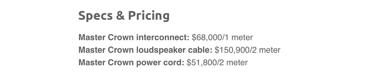

The lead article in the Absolute Sound email I just received was about cables. Here’s the bottom line. Only 400K+ for the starter set.
