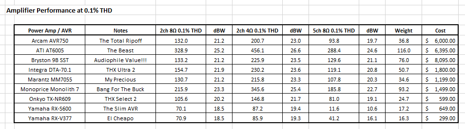

Pretty much, but that's not necessarily a bad thing either. Yeah, the Monolith is the better value (if you pay full retail for the Marantz at least), but ATI left a bad taste in my mouth, so it's not high on my list of things to try these days. On a related note though...
Given the similar dBW performance between the MM7055 (and MM8077) and the THX Ultra 2 certified Integra, I can guess what Marantz's performance target was. I like the Bryston comparison as well :D
An $8K Bryston that can output a monster 130W x 5 Ch into 8 ohms? Definitely an audiophile “value”. ;) ;)
The Audio Critic had a test of that by David Rich with a power cube test. Not very good.
I wish dBW is used more often, for the obvious reason.:D
