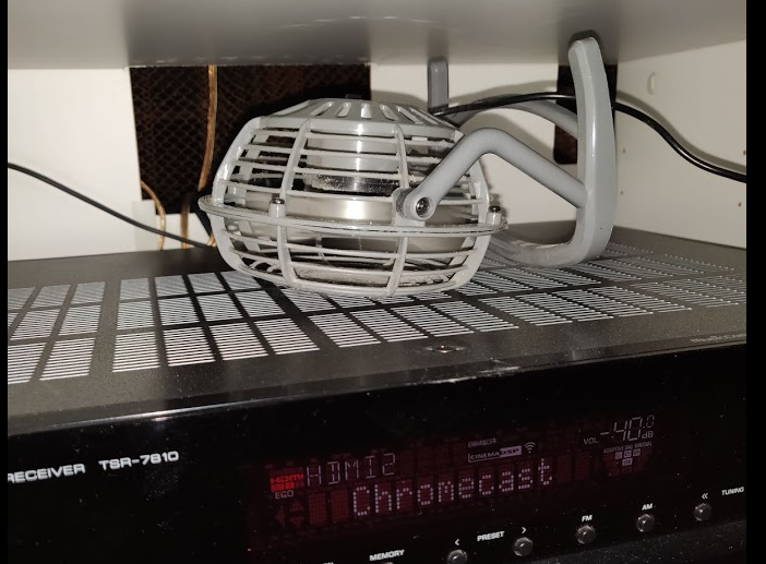

Woohoo, found an old mini fan from my 2nd gaming TV which seldom use anymore. Unplug and move it to my AVR. Cancelled my Amazon order, save me some money :)

You need to pull hot air OUT of the Chassis. Not Blow the HOT air back INTO the chassis.
This! My how my skin crawled when I saw that photo! :)
That fan is wrong on so many counts. You don’t have enough space for it to work properly, much less for it to get the air circulating out from the chassis of the AVR.
You need the fan mechanism to be flat against the chassis so as not to draw outside air. Likewise, you are still venting that into a constricted space. How much clearance do you have above and on the sides? Most manufacturers recommend about 6-8” without cooling... but with cooling, you need to also direct the hot air away.
