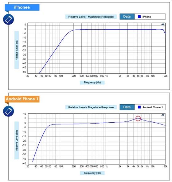

You could also use something simple like an spl meter app on a phone and run test sweeps (but could be limited by the range of the mic).
William Lemmerhirt
William Lemmerhirt
Yeah, here’s a comparison I found a while back. I might be missing something but it’s why I am reticent to recommend spl apps.
