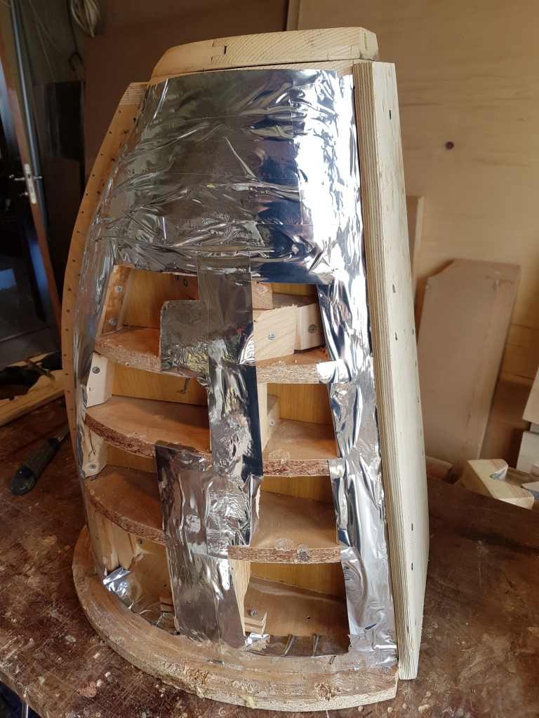

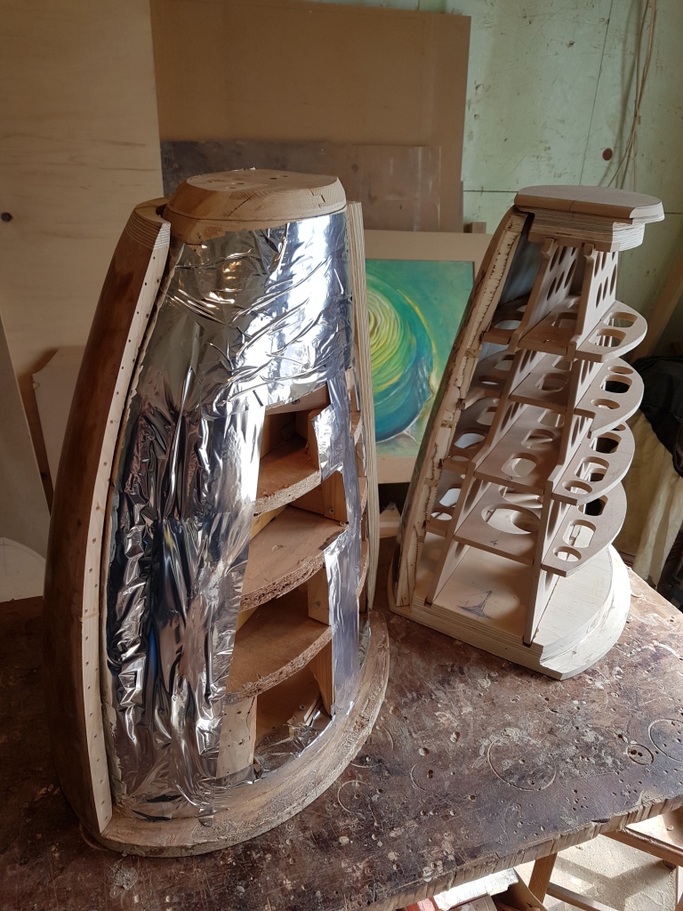

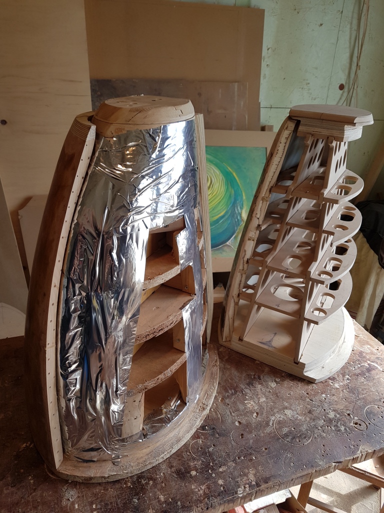

I don't think you understand. We're complimenting your work and looking at the beautiful design in your bracing. did you not use the bracing as a mold also to shape the speaker?
In spite of the audible contributions of the bracing, if one were to stress foam, veneer, or any other semi-flexible, otherwise flat skin over a frame work without adequately spaced supports, the skins may take on the look of a "starving horse," for lack of a better explanation.

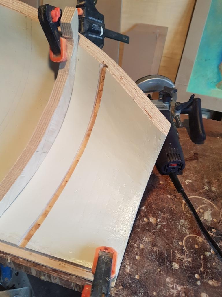

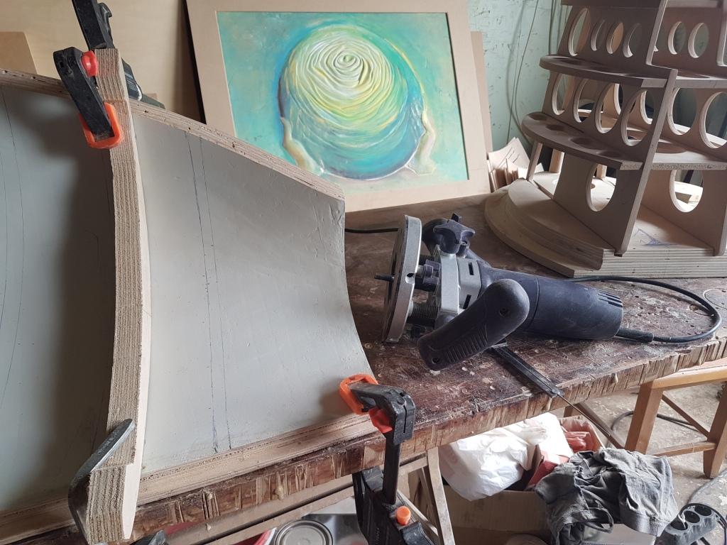

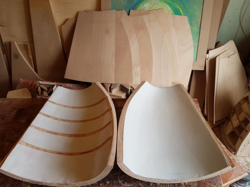

Okay, if you understand my construction in this way, what can I say?

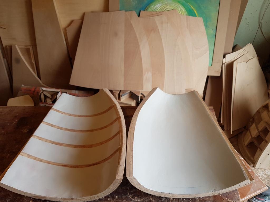

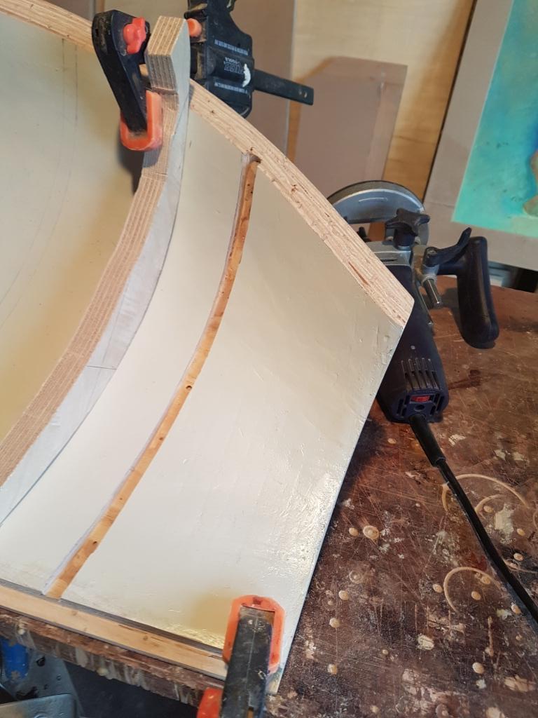

It is my another "Home matrix":
m-1.jpg m-2.jpg Maybe you it know -bended 8 layers, 4 mm beech plywood?
^And a little more on the subject of bending. We all know what is the ideal shape for the speakers. For technological reasons, it is difficult to do, especially with three tape loudspeakers. I strive to make the second most effective form - the egg.
View attachment 21006 View attachment 21007 Maybe you it know -bended 8 layers, 4 mm beech plywood?
I think I understand your construction. There seems to be some confusion on your end as to what I mean. This is what I meant earlier when I said I think we're having a small issue with a language barrier. Not that your English is bad, just some comprehension issues. I'm not questioning any of your work. I'm admiring it.
What did you use to bend the wood for your speakers?
My obviously it's I cant good at explaining to you , sorry!
Just three steps up if you get back, you will see my" home matrix ", it is a metaphor. I bend the material on it.

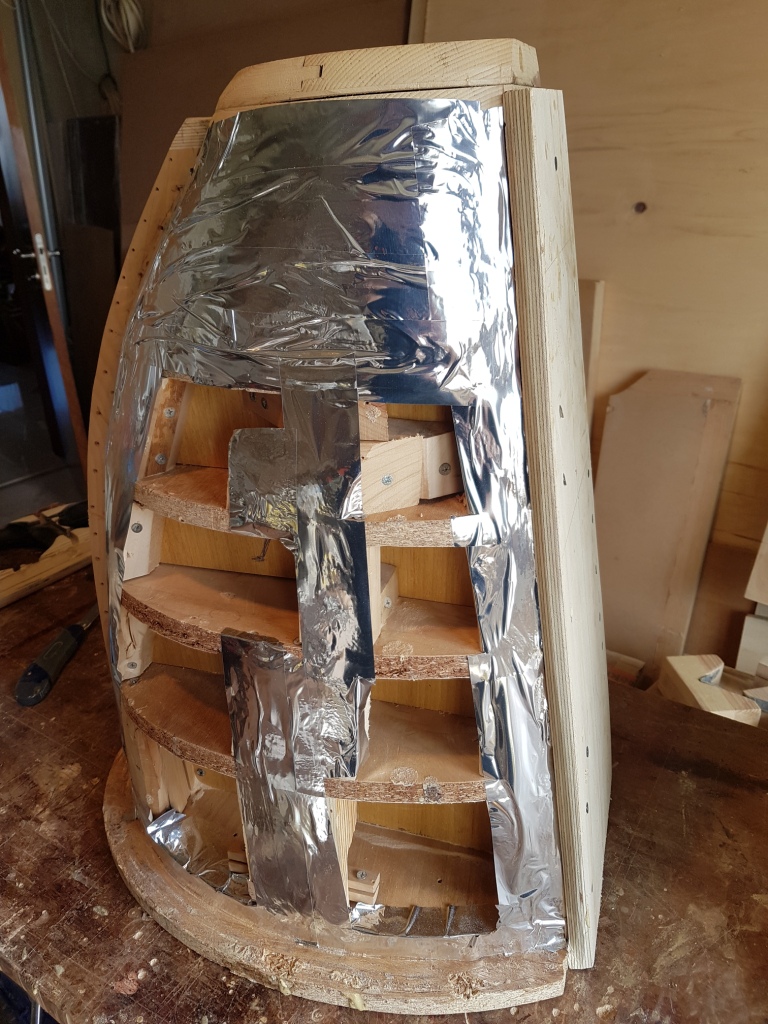

i am not remember to say that I would not use soundproofing foam.

How did you make the shell of the egg? Lots of layers of very thin wood tortured around the frames?
Not at all. It just lends itself as a mold by default. It happens with many things that are built like this. Part of why it is great to make these things!
I do not know how you measured the internal volume? Fill it with beans? Most engineers can click this out on a computer in a short time these days.
I am an electric engineer,assuming I use a program (CAD ),entering data into this complex, incorrect form would take me a very long time, effort which for single production makes no sense..
The making every detail is unique, It is normal to have differences between them.
When assembling the structure, i do extra work in the interior of column, which changes volume.
It's clear that the software will not help me,mathematics - as well.
I'm trying to get closer to her alternative - the egg, so I solve the problem /as possible/with Fb ,Fc. My project is at an early stage and do not have , will not matter unless I get the right volume.
Yours assumption about volume measurement is а wrong.
