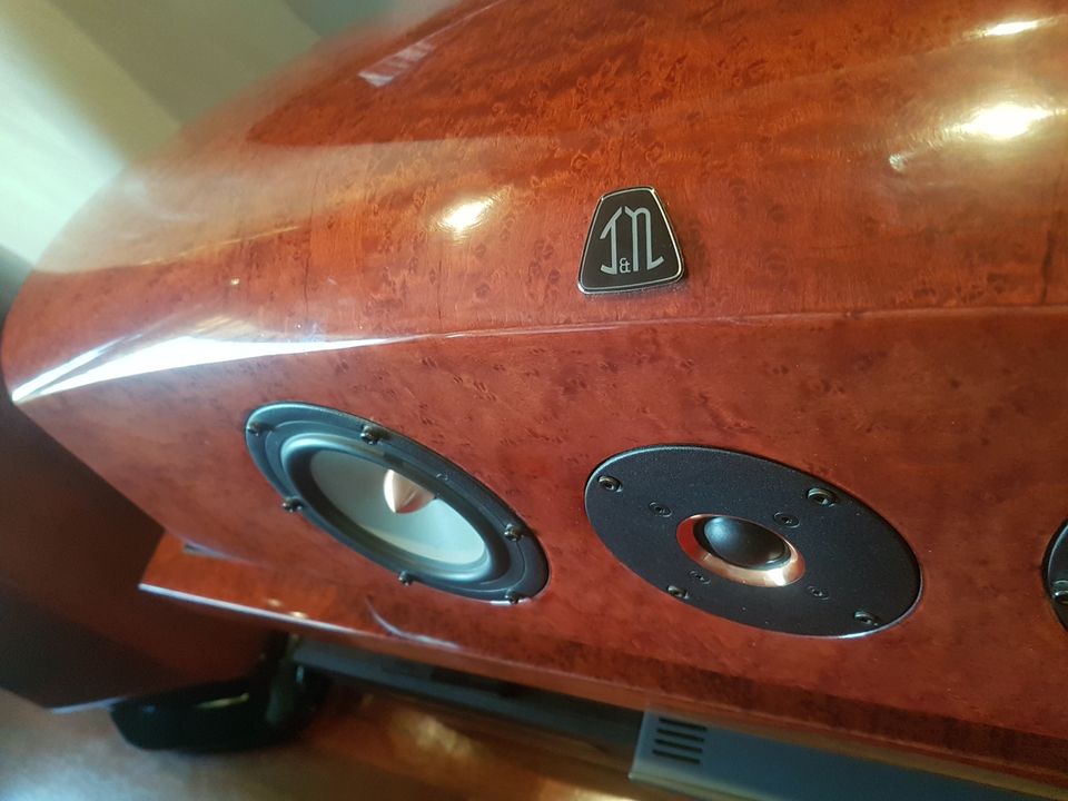

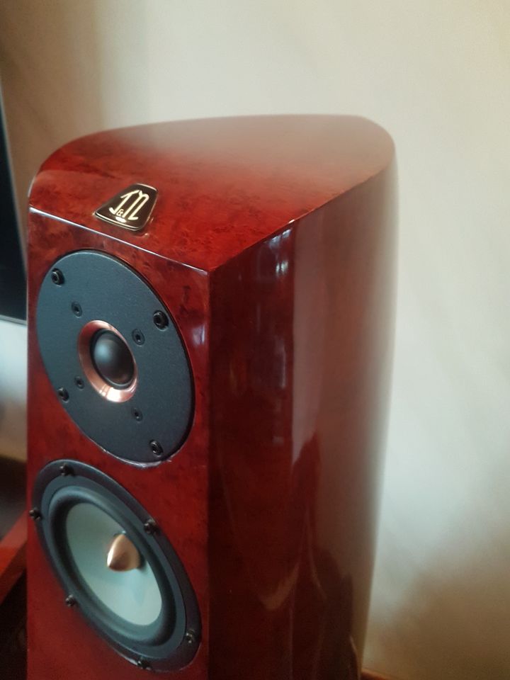

It is clear that the project with the rear pillars will not succeed / this year / - I have to make a living from other activities, but while I was sitting, I decided to post this photo:

Very nice work!
I am only at the beginning of my DIY journey. Perhaps one day in the not too distant future I will have something that comes close to that level of craftsmanship.
Cheers!
Simply stunning craftsmanship! (as always, when you post your work)

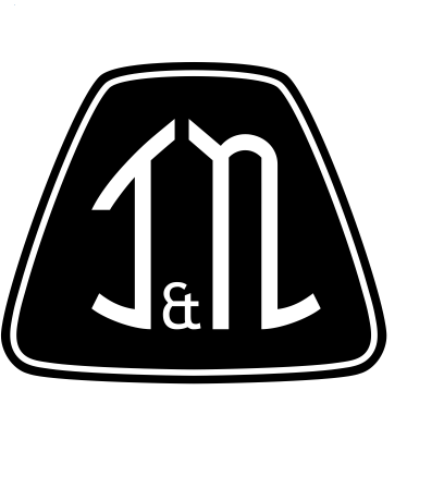

Meet with my logo, please!
The name of the my loudspeakers - "J&N" are the initials of Joro/ my nickname / аnd per se and Nelly/nickname of my wife / and this is ours logo.
Some think, It looks like the J and N are giving each other a high five. Yes, that's right, it's been 40 years together!
