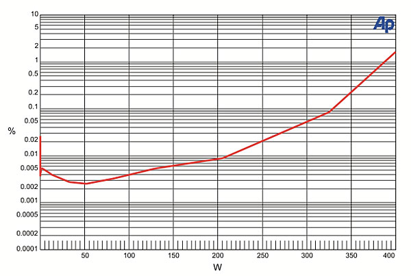

Here are some ATI Variants. The distortion numbers are taken from the graphs because I have seen errors in the article text.
AT5200NBC
Max: .05
1 Watt Est: .0015
AT6000
Max: .03
1 Watt Est: .004
Monolith
Max: .3
1 Watt Est: .01
Outlaw 7500
Max: .1
1 Watt Est: .004
I think SV measurements are of limited value.
I have/had the AT6000, AT500NV, and Outlaw 7500 in my system and I don't find them equivalent.
- Rich
