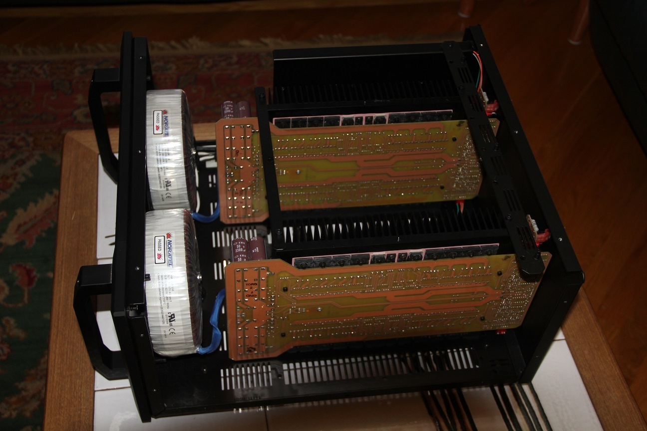

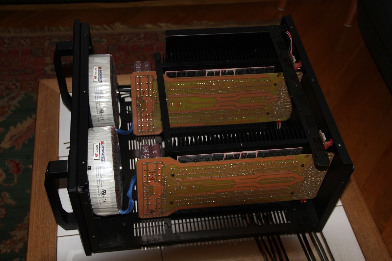

One thing I’ve noticed on some pictures of these amps online.
In the older pics you can read a tag on the transformers that said Amplifier Technologies.
On the Monoprice website the pic of the amp shows the transformers with a sticker on them that says Noratel.
Wondering if ATI is no longer winding the transformers for these?

ATI used Noratel to supply the torroidal power transformers used in the MonoLith line of amplifiers. Noratel has an established, automated factory in Poland and they are capable of supplying the higher qty volumes @ a more competitive price than locally produced in the California b y ATI. The transformers are well made and meet the European CE standards...
