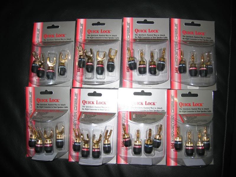

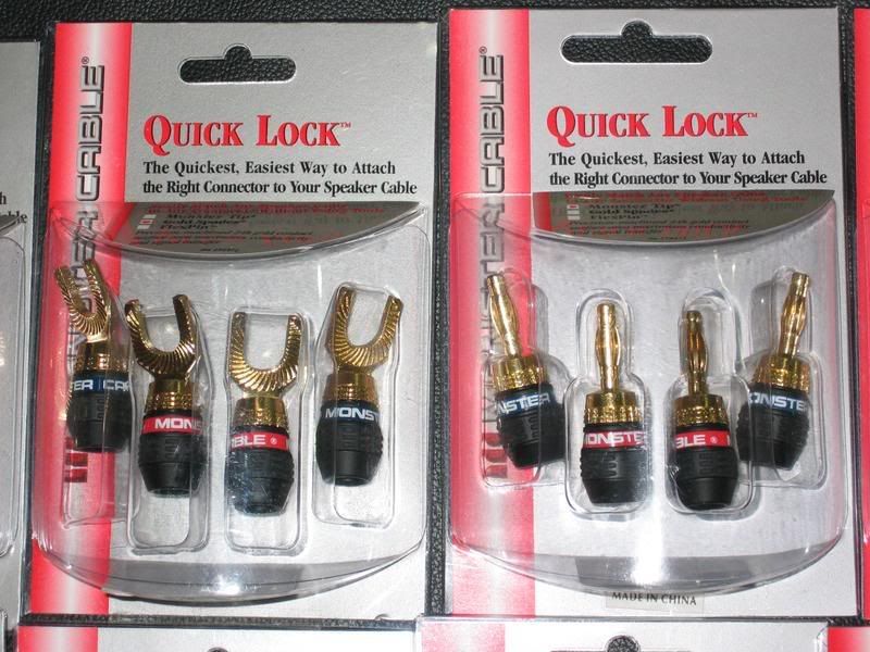

Rowdy S13 said:
These connectors are great. I have them on all of my speaker wire, and suggest them to everyone.
Sean
radioshack has the banana plugs that does the same job, but cheaper ... I just like the looks of these things better.
Sean
I don't recommend those connectors simply because of their cost. I got locking bananas from Blue Jeans for the same price (actually half the price because I had a credit on Paypal). Functionally, they work great. I have 3 sets of those bananas that I got free from a friend who owned a shop.
They sell basically the same thing as the Monster ones from GLS at www.speakerrepair.com for about half the price.
I second that. Canare connectors from Blue Jean Cables. More cost effective and equal to or better performance. Locking is worth the added expense if you move your equipment a lot or will in the future.
You can do a search here for BJ. Good review and their site is no non sense. You can learn a lot from this and the BJ site about cables\connectors.

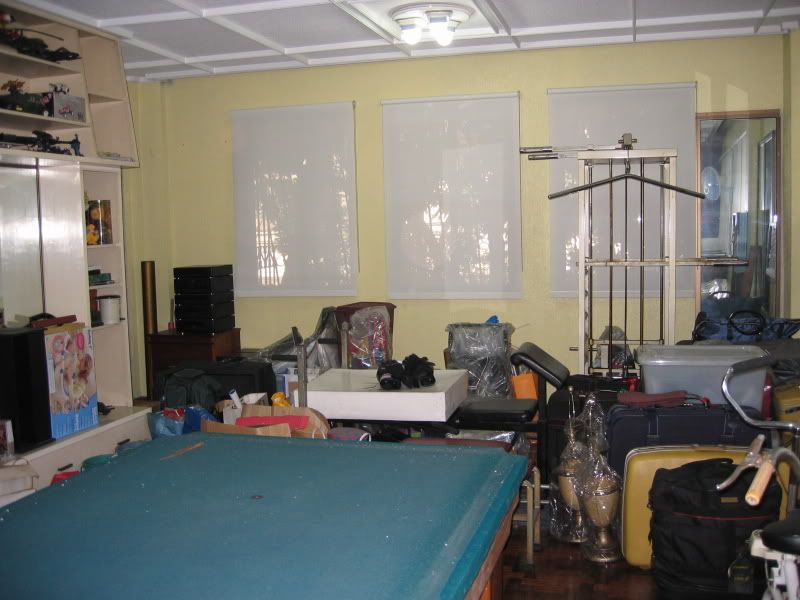

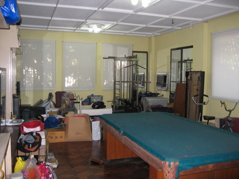

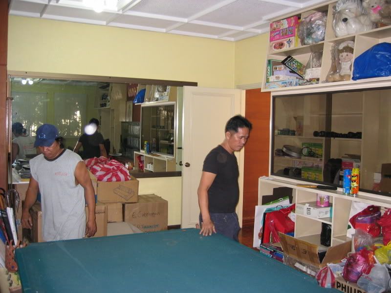

Dedicated HT#2 (closest I can get to a dedicated room)
I'm supposed to move all my HT stuff into this room before september.
here in the pics, the billiard table is being disassembled and given away ...

Mike,
Great pics. Man, those are some old recumbant bikes. Are any of those guys you in the photos?
You need to do some house cleaning. ;)

Mike,

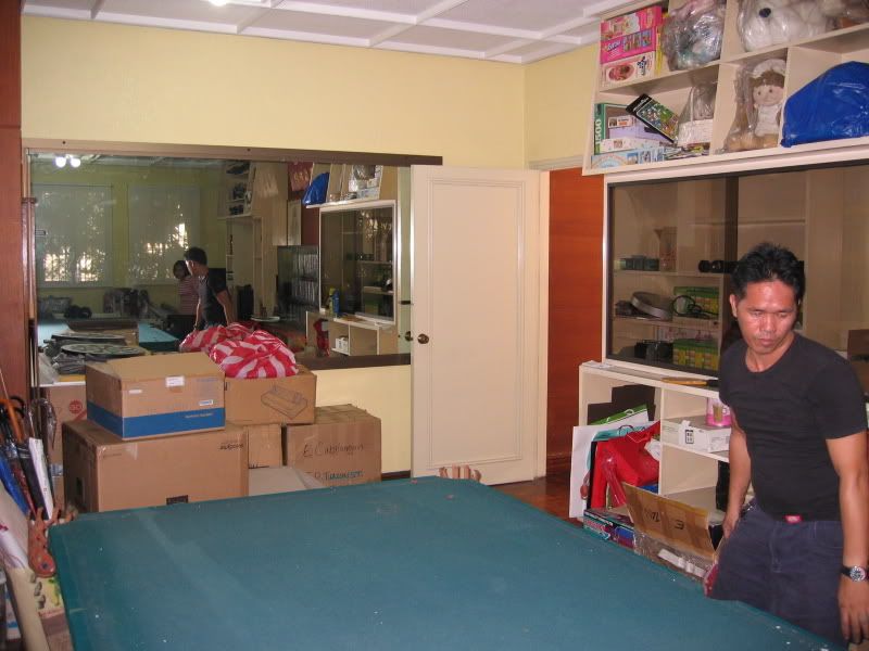

I'm the guy in the yellow shirt ... good luck finding me!
this room has been a store room for quite some time ... stuff we think have sentimental value ... it's gonna be hard to throw them out. looks like I'm gonna have to move them to another place :)
mike c
mike c
Nah, not yet ;)
Man, I'm glad it's not me moving that billard table! The slate weighs a ton.
since those same guys are gonna be the ones who will be using that table, they sure didn't seem to be "bothered" by the weight ... they looked enthusiastic to me :)
